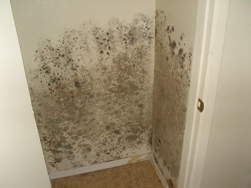

I told my client today not to worry, scrape it off with a flat shovel, apply Kilz and paint it-----:smiley:
http://i74.photobucket.com/albums/i247/badstucco1/ClaudiaMunns-JulieThompson019.jpg

Well the house was flooded because the realtor turned the water on a few days ago and did not look inside the house to see if water was leaking anywhere…like from the 1/4 in. line to the icemaker which was wide open–:)))…and not connected to the missing refrigerator-freezer.
I told them to get three estimates from licensed contractors to rip the sheetrock out and install new, and do what ever else they want to suit their needs and expectations, and if they want to blow some money have it tested for mold, have the men with white suits come wearing Moon Gear, do what ever they want, I could care less—::))) I just reported the moisture damage 4 feet up the walls in the entire house. The mold grew fast in the closed closet not getting any air.
Pretty simple really…I did not tell them to get a mold test, I didn’t want them to think I was an idiot.
I’m not allergic to mold, it does not bother me one bit, when I was a contractor I would tear houses apart that looked like the picture above without even a dust mask.

So you not knowing the background of your clients health gave them a remediation protocol without even knowing it? Just have a contractor remove the drywall? Really…
How about the HVAC system and the chances of the mold being spread.
Dale, think of it as being bees stinging you. You are allergic to those right. If I walked into this home, I would personally be suffering due to my allergies to molds.
Blowing money on testing is a little far. Tell that to one of my clients that was told the same thing by her inspector with her current home which had mold all over the basement. Now she is in the hospital almost weekly with sever bacterial infections and MS thats flaring up due to her exposure to this lovely mold located in her bathroom behind the tile. If her last inspector would have just moved on piece of insulation and maybe used a moisture meter he wouldn’t be out of business and money.
