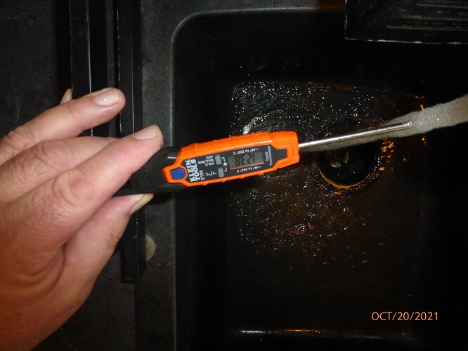

Thus a regular thermometer works better. You can buy them at the grocery store. $10.00
Take a picture and keep the high priced hardware for where its really needed.
I use a digital steak thermometer. It makes a nice photo.

Not to nit-pick this subject, but just hoping for a better understanding of what happens here. A regular thermometer (or better yet a thermistor) is the proper and best tool to measure fluids (air and water). Seeing we are looking for a qualitative measurement, IR is too much work and too difficult to accomplish a correct measurement for most.
I agree with you, David about this being a qualitative measurement. I always include a picture of my IR thermometer showing the hot water temp. Interestingly, whenever this topic comes up I do parallel measurements for a week or two just to make sure I’m not crazy. I use my DST (digital steak thermometer) and the IR thermometer at the same time. The difference is never more than 1.5 degrees (F) apart. No matter what the surface of the sink or strainer ring is. (I may still be crazy but I’m confident in my water temp measurements)
