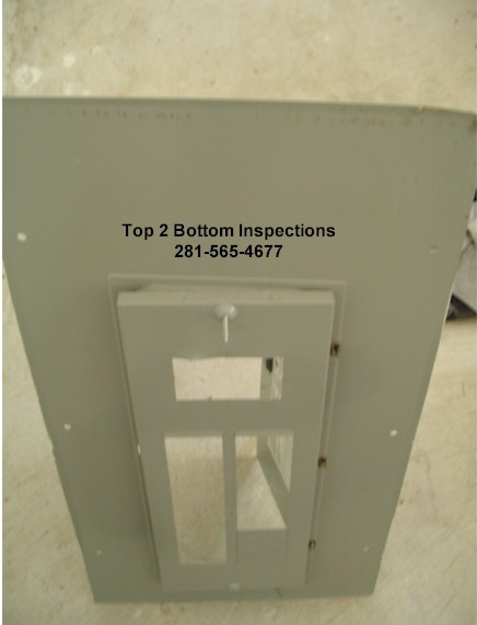

On August 8th you inspected the property I am purchasing at xxxx Mildred in Bellaire, TX and I wanted to get some support or guidance from you regarding the electrical items in “Electrical 2.0” of your report.
The homeowners had an electrician and city building code inspector come out and review your comment listed below and they feel it meets the code in place in 2001 when the house was built. I am seeking information to support your claim that these items need repair. Electrical issues are major in my mind so I want to be 100% certain the house meets code. See below for the excerpt from your report.
SERVICE ENTRANCE AND PANELS
Inspected, Not Functioning or in Need of Repair
Main electrical service panel shown with dead front cover removed for inspection purposes (picture 1). Pointed sheet metal screws used in place of manufacturer supplied panel cover screws at main service panel. Pointed screws can puncture the insulation of the service wires and become electrified. These screws present a safety concern and need to be replaced with the proper screws supplied by the panel manufacturer.
The sub-panel appears to be fed from the main panel with three conductors (picture 2), should be four. The bonding bar in the sub-panel (picture 3) should be removed. The ground and neutral bars in the sub-panel should be isolated.
I recommend that a licensed, competent, qualified, professional electrical contractor be consulted to determine the best method for repair, estimate costs, and perform the repairs.

The sheet metal screws are an issue, albeit a minor one. I am surprised they had to resort to this on a new install. For old equipment I might even know some folks who have done this in a pinch.
For newer equipment I usually have some extra screws around.
As for the sub-panel, if this is within the same structure you are correct and the local inspectors are wrong. Unfortunately VERY wrong.
If this is a detached structure it could very well be perfectly legal and safe. There ARE some instances where a 3-wire feeder is legal, but only to a detached structure.
As long as the sub-panel is in the house I think you reported it correctly as well.

P.S. Never seen them use 1/2 pointed screws. Always one inch or better. After a factory center lug (such as the one replaced by the 2 inch in the picture) blew up in my face when removing a dead front, even 1/2 are bad mojo to me. Call me silly.
Canada May be different but as far as I am concerned Sheet metal screws should never be used to hold a cover of any kind on any electric box Period.
There is no such thing to me as Minor issue with electricty.

John, I definitely understand the issue with SMS’s. I’ve had it happen to me as well. I actually had it happen with an Siemens panel, the ones with the really long screws with the blunt end. Surprised me to say the least.
Unfortunatly, when Harry Homeowner removes his cover and loses the screws 10 years ago (not exactly uncommon) we sometimes have to compromise. Especially with some old panels where almost nothing else will fit.
Fortunately, by this time it is usually time to replace the panel anyway.

I put a panel on several months ago which had sheet metal screws, and guess what? The screw nicked the hot wire. Sparks.
Inspectors have been known to be wrong too. I have met several including building inspectors, regardless of code, regardless of AHJ. To error is human.
I don’t see an excuse for using a SMS. You can buy the right screws and when the holes are stripped you can use a clip on speed nut that works with any of the regular #10 screws.
