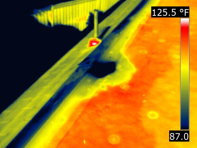

This is a roof scan I took today.
It is only a Flir T-400.
See my shadow (under the span bar) ?
That is a 0.5F degree differential which happened from me standing still for about 20 sec. to take the scan.
This is what “personal cameras” do not pick up. MSX is not a thermal measurement so if you turn it off, you will see nothing.
