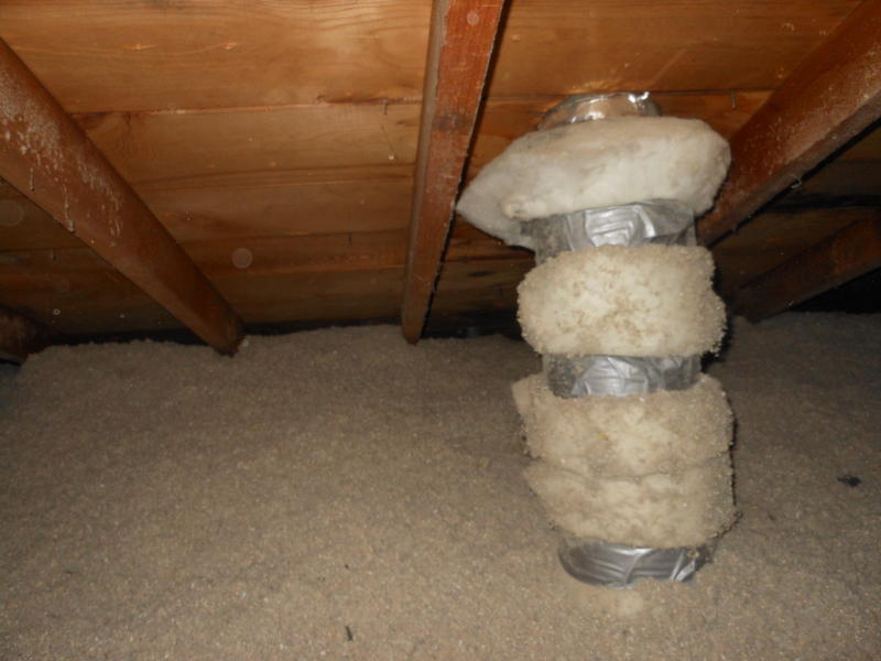

Todays inspection
I don’t see this product for a retrofit install, correct me if I’m wrong.
On the inspection the lower vents are behind the kneewall, kneewall and floor are insulated, noi chutes as there are no soffit vents.
The upper vents are for an enclosed and insulated vaulted ceiling, a hot roof in a sense.
You don’t have to fix the house, just report defects. I report defects regardless of whether I recommend that they attempt to repair them. The report is a defect list not a repair list. If the manufacturer does not endorse the method in which the vents are installed, I will report it that way, then discuss the ramifications of attempting to repair vs leave as-is during the discussion.
And we had the roof and attic all inspected for you before you did it, gezzz
Yeah, yeah and so that’s why I put your comments in my report:mrgreen:
