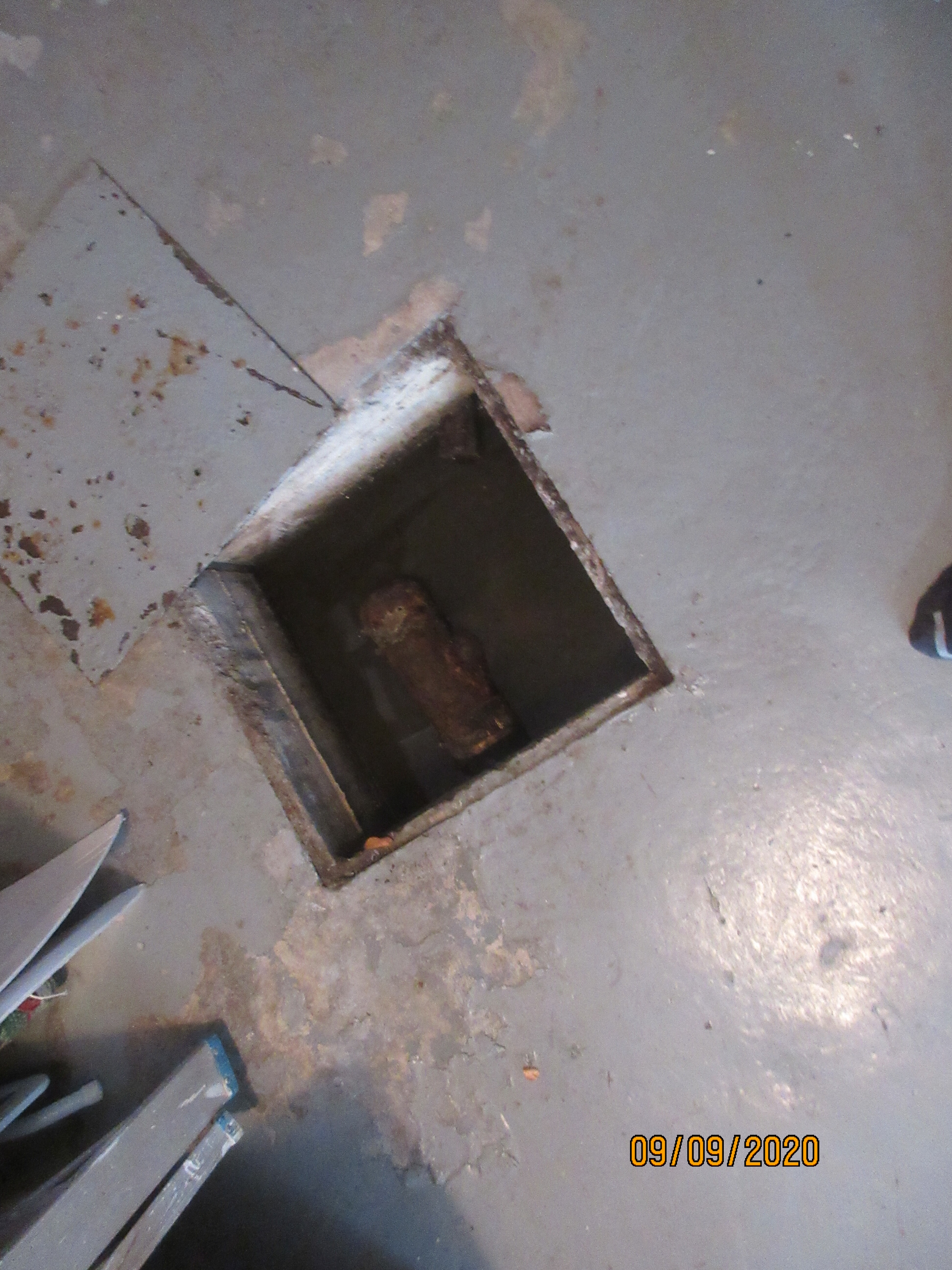

Garage catch basin with inverted ‘t’ present… Can you spot the defect?
Not with that crap photo!
You Win! Crap photo of crap and toilet paper floating in the catch basin. Whoever installed the bathrooms in the basement decided that it was too much of a hassle to connect to the waste pipe a full 6ft further.
It’s a floor sink in the garage not a catch basin. Those are in landscaping.
The drain should not connect to the DWV system without passing through an interceptor. This it why it’s not tied into toilets in a basement. More of a description of the plumbing system would be helpful and the photo blows.

Observation: Cast Iron Hub And Spigot Gray water pipe corrosion.
Oxidized cast iron.
Missing visual Backwater Prevention Valve, Air Bell or Water Trap or Pipe Termination Grate.
Floating debris in the basin.
As for floating, or any debris in the Basin. That is why Backwater Prevention Valves, Air Bell or Water Traps or Pipe Termination Grates are installed. To prevent debris from being washed downstream clogging blocking the pipe which in turn will backup gray water and flood a garage or basement.

As for the inverted tee by the OP?
If the bottom of the tee pipe is open, it is an air bell/trap.

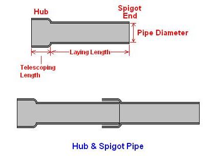

Typically a/the Hub is used as the Bell when using Hub and Spigot cast iron pipes.
The end of the pipe, a spigot is inserted and sealed on the horizontal HUB.
How the air trap works.
As water rises in the water catch basin heavy debris falls to the bottom of the basin while buoyant debris stays afloat as to not be washed down or dispersed into the air bell/trap. The air trap should be continually covered in water.

Thanks guys. If you notice the first few words in the title of the post, the are, ‘Trick Question…’
I intentionally posted a picture that was considered ‘crap’ to see how long it would take someone to make the reference.
jjonas was the first person to respond and make the reference.
The main problem is the fact that waste water (crap) is running into this pit (or catch basin depending on your use of terminology).
Referred to a licensed plumber for an estimate to correct.
Thanks for your expertise and entertainment.
Robert, a flash only created a reflection as the particle count in the water was so high, topped off with an oily film on the surface. A powerful flashlight was able to help me to identify the pipes leading in.
The real ‘crappy’ part to this story is that the client called me in because he suspected that a few things were wrong with his home. As a recent immigrant with poor local language skills, it appears that he was taken advantage of. A ‘Home Inspector’ was referred to him a couple of years ago when he purchased the property. The 'inspector walked around took his cash and told him his house was good to purchase, no problems, no report, no receipt.
