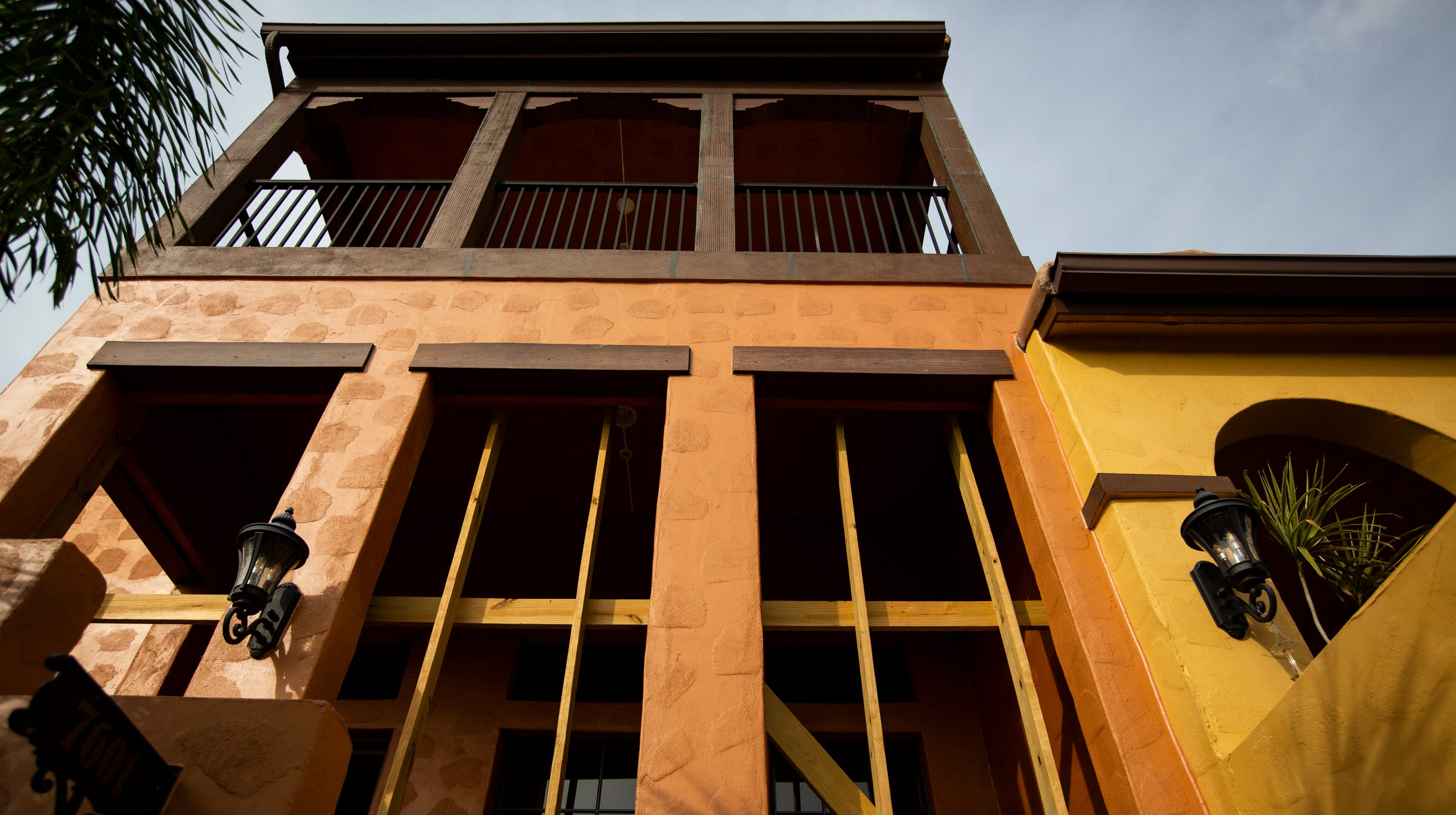

Hidden problems in new homes as Florida construction booms
Halfway or so, an engineer comments that part of the problem is contractors who don’t know code. Later, that the county let the contractors self-inspect.

At about 3 minutes he describes common issues we see around here. Windows not properly installed, with Stucco bucket at a critical point of the structure.
Things like this are not “only in Florida.” In Colorful Colorado, we had a period when builders were allowed to self-inspect, too. We do a lot of stucco and most of it is not best practice or worse. If we were a wetter and more humid climate, we would have plenty of “Trouble in Colorado” videos.

I remember inspecting some of these homes when they were new and calling out the stucco and balcony issues. Then years later…

Looks like someone used the T 1/11 as a backer for a new and improved look of Stucco Finish, ha, It is surely a mess for sure and you could call it out as “Improperly installed EFI Stucco coat System” or some such, since it is a home made project or Handy man attempt, pretty poor job too.
