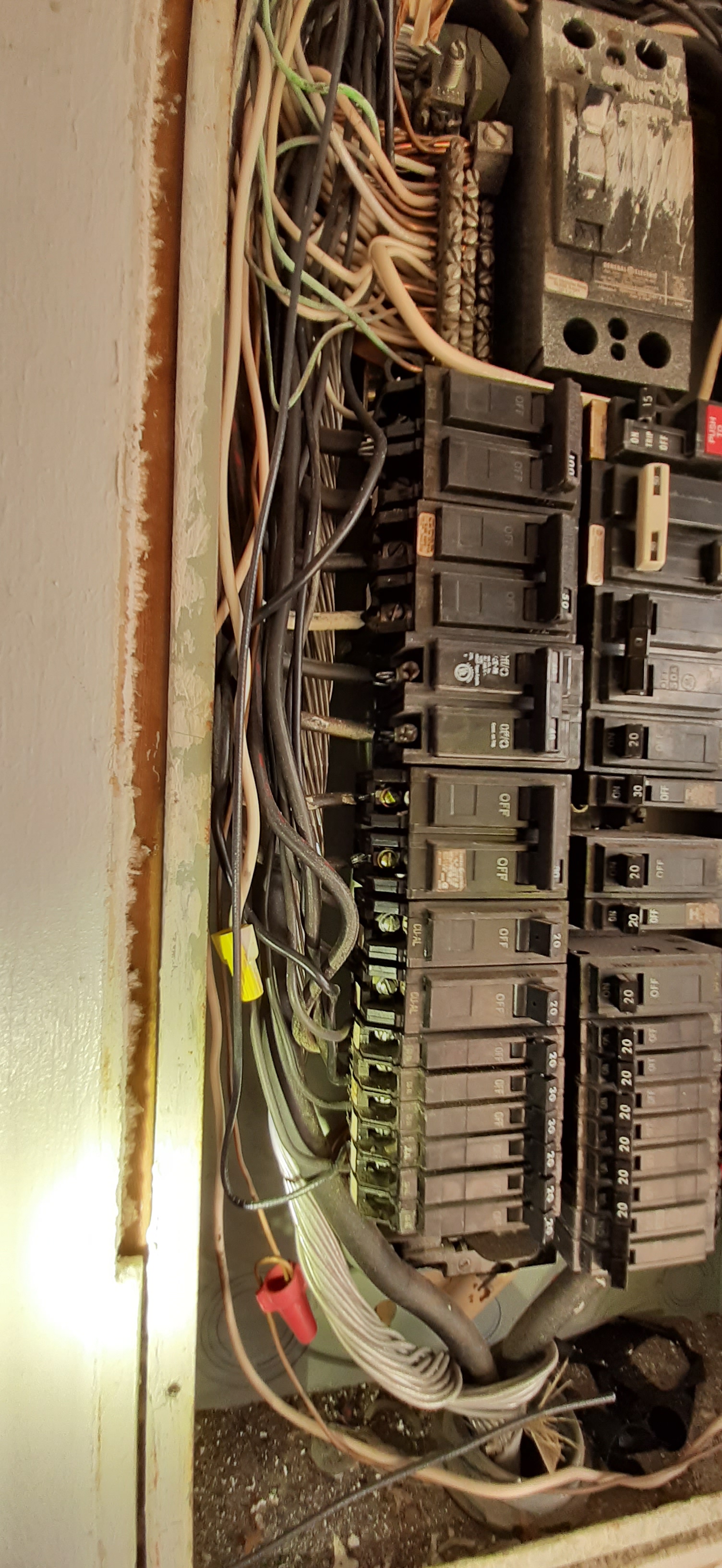

Trying to determine total amps
What does NACHI electrical course instruct you to do? what is stopping you from determining the service ampacity? what did you check and determine thus far?
Looked at Meter, 200 AMP. There was not a Main Service Panel at the Meter to look at Breaker AMPS.
I could not read the Breaker at the top of this Panel because of paint. I see a 100 AMP breaker, 50 AMP just below and a 40 AMP below that going down the left side. I don’t want to guess.
Question,are all residential electrical meters located on the outside of the structure. ??? And the service panel is inside. ??? Correct ???
Green horn here.
Did you check the panel rating? how about the sticker on the main breaker in the panel, did you check its model? what size were the SE conductors? you do your best and if you’re not able to identify you say so… definitely do not want to guess! We can guess from here for you but that is all it’s going to be without additional info. To determine the service ampacity you check the SEC, the main OCPD, and the panel rating. The lesser of the 3 is the service size until the other components are upgraded. If you find a particular mismatch, for example 200 amp breaker on 100 amp wire, you have a problem!

Here’s a new replacement from Saturday’s inspection.
GE Powermark with a 150A disconnect. The other breakers are for pool, sprinkler equipt. These type panels are rated weatherproof.
The interior distribution panel was in the garage, another GE Powermark.
My home (from 1979) has a 200A exterior main with the same setup.
I’d say about 8 of 10 I see down here are similar. :cowboy_hat_face:
