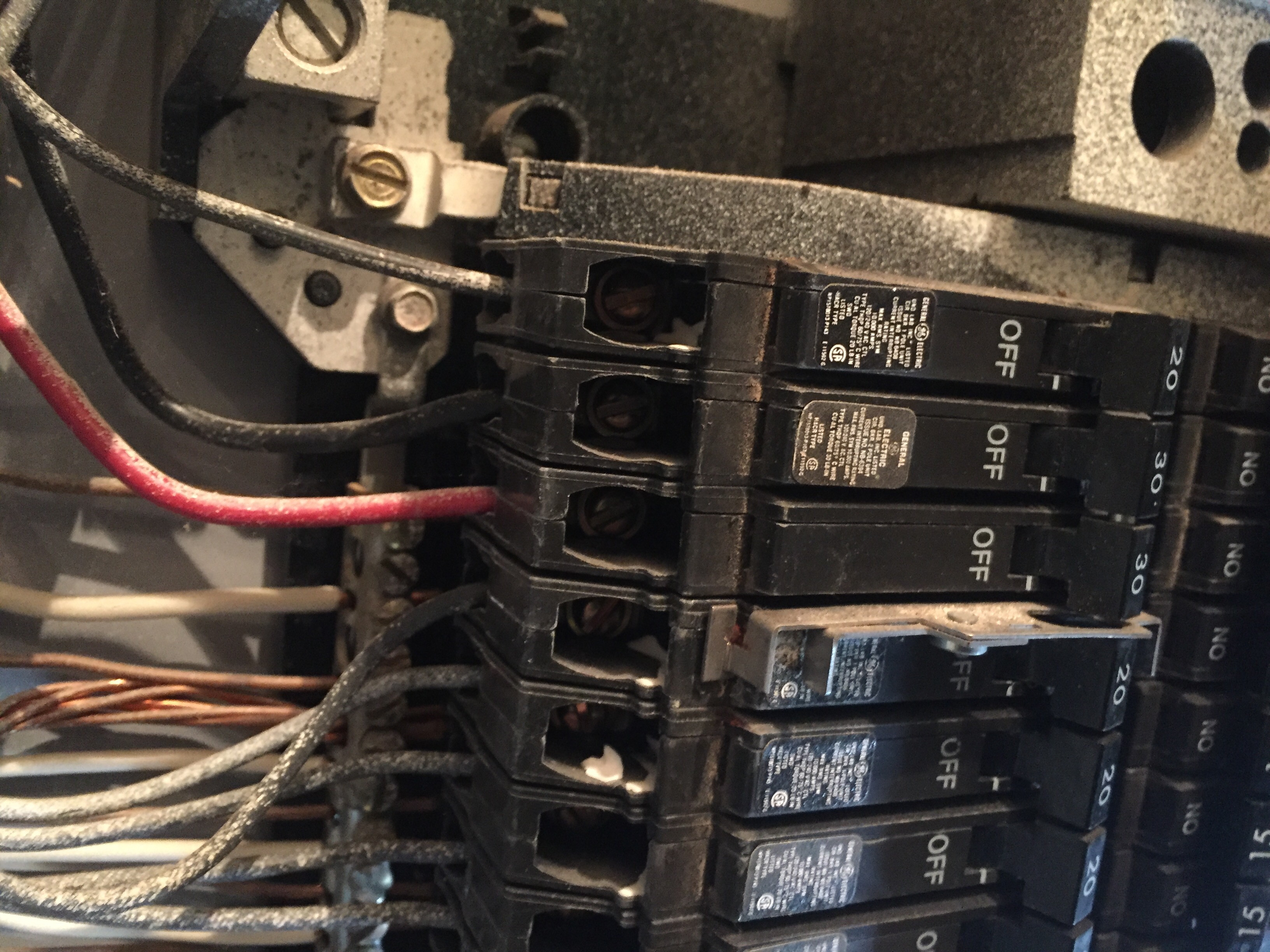

Two different wire sizes for 30 amp breakers?
I have a panel with different sized wires for 30 amp breakers. Is this allowed?
What size were they …They all look like #12 which would be wrong for 30…
What were they feeding?
Looks like a #12 and a #10 and a lot of spray paint white. LOL
You think the 30 amp is #10?
That would be ok.
Looks like one of each Roy on that double pole 30 amp breaker. But I’m 1,000 miles away. LOL
Impossible to tell for certain from a picture but the right side appears to be 8 awg aluminum (good) & the left appears 10 awg copper (also good)
In summary, I see nothing wrong with the two 30amp breakers pictured.
We have to know what size and type wire to answer you. The wiring can be oversized. The wiring may be larger on one if it’s stranded aluminum as 8 awg would be correct size.

Thanks, the two are for the AC unit. They are not tied together, however,
From your pictures I see only two 240v, 30 amp circuits. (1 on left, other on right) Each of those circuits are tied properly.
While others are correct about using smaller awg conductors with the 30 amp breaker when equipment ampacity allows, that does not appear to be the situation you are in…according to the 2 pictures & description in the OP.
So, in an effort to clarify.
Are you asking why the conductors used on the left side 30amp circuit is a different physical size than the conductors used on the right side 30amp circuit?

The black and red insulator jackets looks the same AWG to me. All the 20 Amp conductors appear the same AWG as well.
