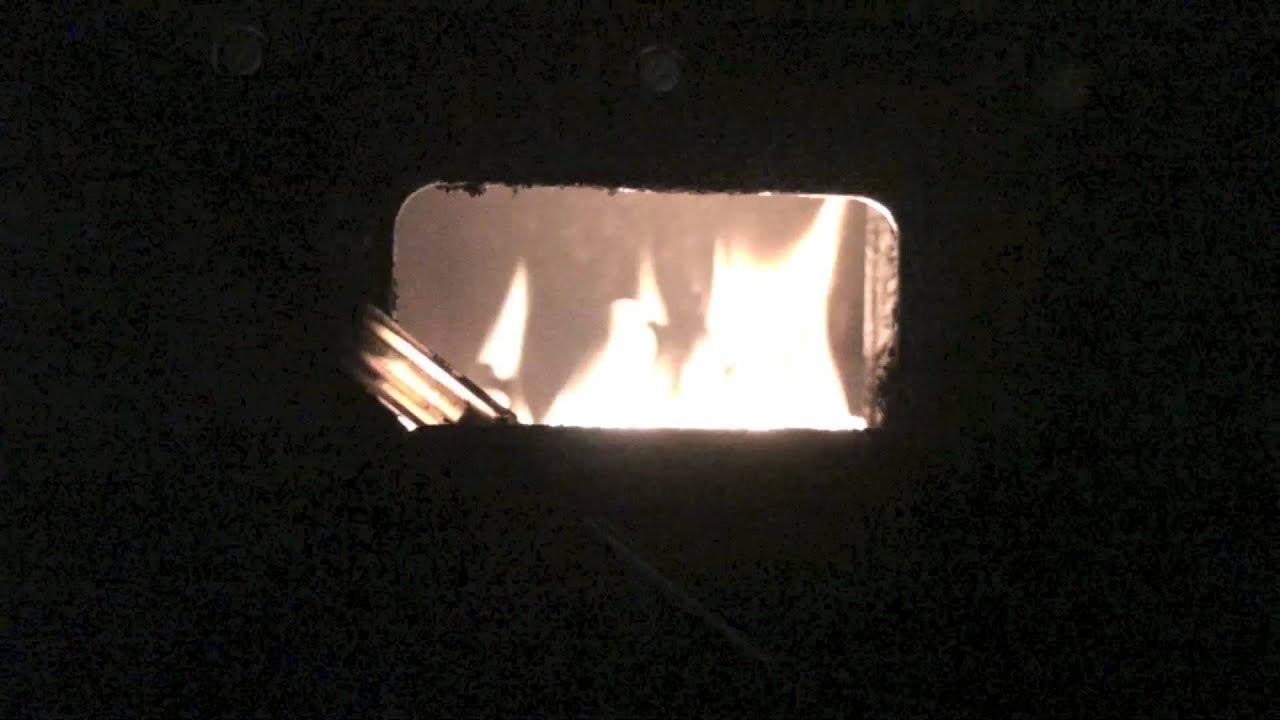

An oil flame should be ________ in color.
blue
orange
white
yellow

Blue would be my answer.
Blue is gas, orange is oil

From two HVAC companies:
"blue flame
A blue flame signifies a properly-functioning oil or gas furnace; any other color indicates a problem with the furnace. In addition to producing more soot, incomplete combustion produces more carbon monoxide (CO), which can cause headaches, nausea and even death if inhaled in large quantities.Dec 17, 2021"
"What should flame look like in oil boiler?
A properly-working oil or gas furnace should have a blue flame; any other color indicates a problem with the furnace. In addition to the increased amount of soot, incomplete combustion releases more carbon monoxide (CO), which can lead to headaches and nausea, and may even be fatal if inhaled in large amounts.Feb 15, 2021"
Note: We don’t have too many, if any, oil fueled appliances where I’m located, so this what I found on the interweb and, right or wrong, I would answer blue.
Funny that two companies’ statements are almost exactly the same? Must attended the same HVAC school… :thinking: :flushed:
I agree blue is probably the best answer but in reality they are often orange for a variety of reasons.
Orange for fuel oil.

It appears that the gentlemen that live in the colder climates and that see oil fueled appliance more often, are probably giving the MOST right answer…Orange as the most right answer. Lock it in!!

Thank you all for your contribution and time for my post. The answer they are wanting is orange. I made this post because Internachi says that “ The prep exam contains more than 2,000 questions typically found on state and local licensing exams.” So I’m just wondering

This is probably because the odds of finding a blue flame in an oil fired system isn’t too common as very specific conditions need to exist. I don’t ever see those systems here, so I can’t say one way or the other with absolute certainty. Fuel oils don’t burn as hot as LP or NG gas which produce blue flame unless there’s a problem or a lot of impurities. Keep in mind that not only do certain materials burn with different color flames, the temperature will also dictate color. Blue is hotter than yellow or orange.

What color is the flame on a diesel burner?
The flame should be of pale blue colour. Some times while using heavy oil as fuel the flame can be pale blue to whitish. The flame should not be yellow or orange in colour. If the flame turns yellow means the air fuel ratio is not correct and combustion is fuel rich.
