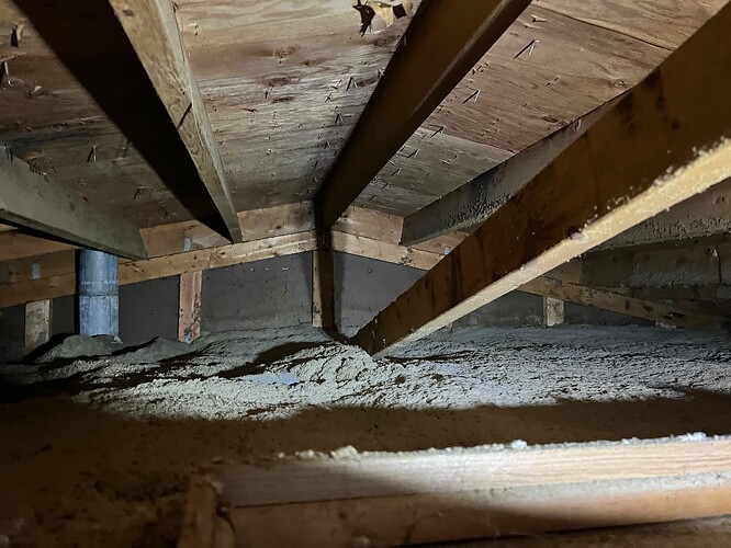

Inspecting an attic and found these rafters. They didn’t run from the peak to the eves, they ran from side to side supported by a little ledger board. This was a two story, two apartment home that looks like it was a “modular” design in the 1980’s. Anyone ever see this setup?

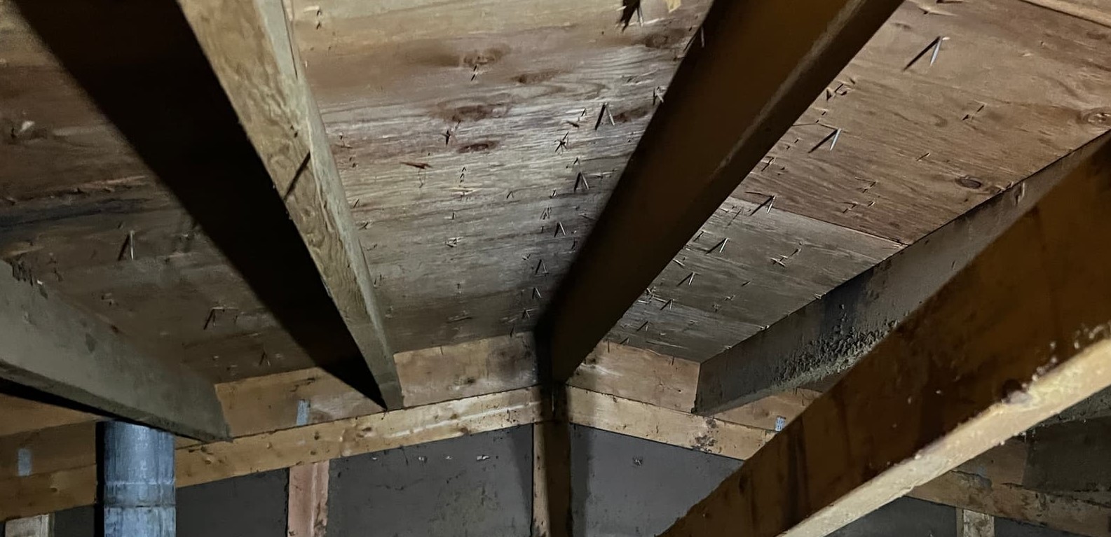

I can not see a defect in those pictures, though if I were there , I would look at the rest of the roof design and try to figure out if the loads are being supported by wall structure in a safe way, even if that is beyond the scope of the home inspection, technically.
I would also check the walls below for cracks, plumb, bowing, etc. I would be curious about the non-conventional construction, but I would not spend too much time worrying about it after documenting any concerns.
I don’t see any ridge vent or gable vent. There may be other vents present but not pictured. The exhaust vent does not appear to have proper clearance from combustible material. I would call attention to the gaps at the ends of the rafters and lack of hardware at the rafter ends.

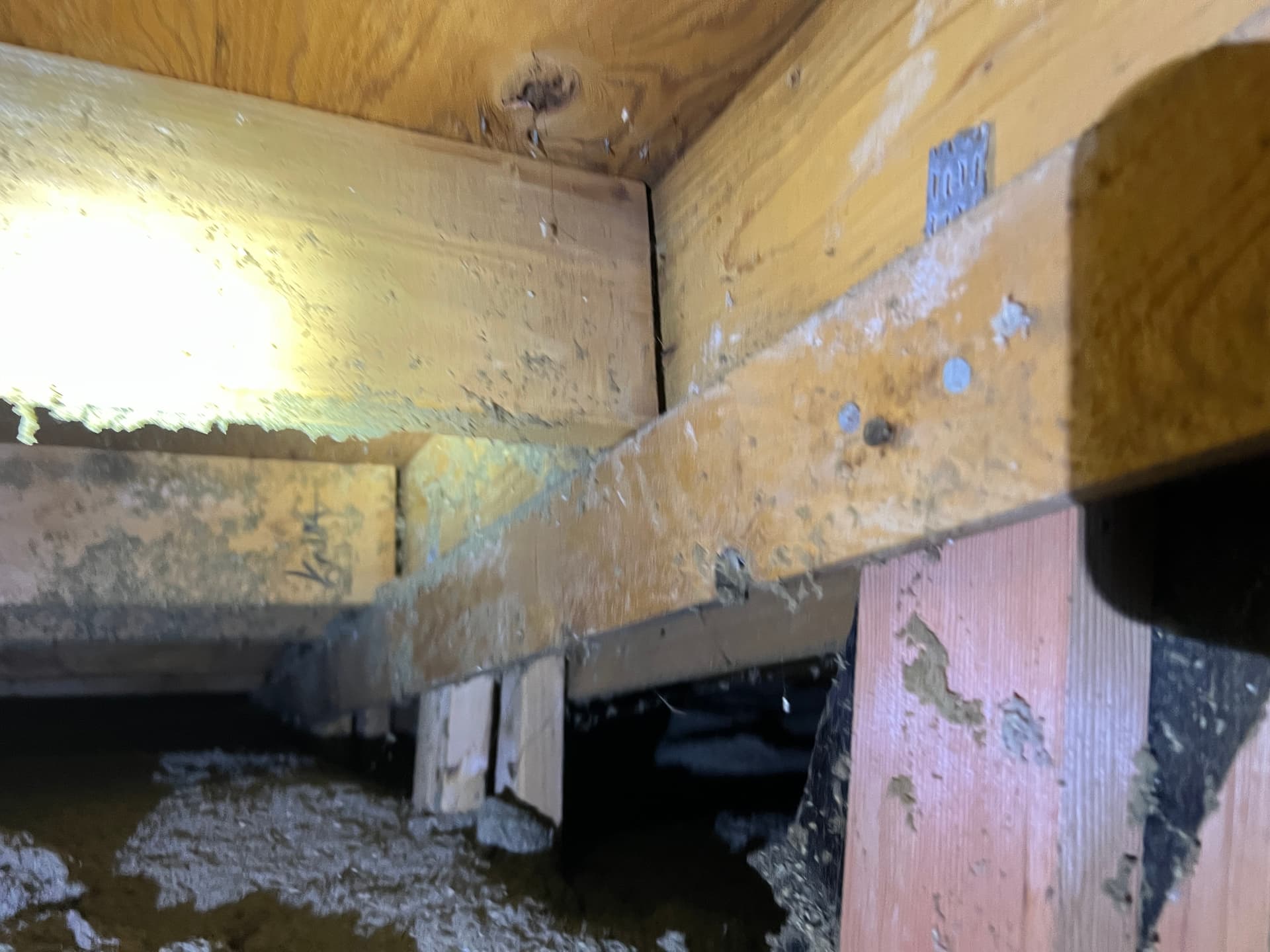

Those members are called purlins, not rafters. Purlins run parallel to the ridge, rafters run perpendicular to the ridge. Typically, purlins are supported mid span using a truss. You show the purlins supported at the gable end. Your second picture shows purlins supported by a ledger that is nailed to vertical struts of a truss. Not the best… Joist hangers on the truss top cord are better. If the structure of the struts and ledger are acceptable, that’s a good system. You will see purlin systems used in pole barn construction and log homes.
Both are accepted roof framing methods. Since the construction method is valid and utilized, your job is to evaluate the structure as built. Do you like the ledger and how it’s fastened to the vertical struts? Do the purlins appear to be built with material dimensioned for the load? Is there any sign of failure?

True, but utilizing hangers to fasten the purlins to the truss top cord is also valid and common. The question for this roof system pertains to the use of the ledger in lieu of joist hangers. A ledger is acceptable and historically common in older construction, especially floor systems. I’d look closely because the ledger is fastened to struts using a limited number of nails. The struts are vertical, so it might work fine, or not. Truss struts are not designed to support a ledger.

Some of the purlins appear in rotation or curved twisting shape.
Missing blocking or bridging members to prevent purlin rotation or movement.
Looks like long fasteners missed purlins.
The flue of duct does not appear it protruded the sheathing.

As I recall, a floor ledger needs three nails at each load area. Floors: three nails into the ledger close to each floor joist. If my nailing schedule memory is correct (look this requirement up), this purlin supporting ledger has only two nails into the truss strut. That’s a component of the ledger structure concern. Then, how old is the building? Does it get snow loading? Is there failure evidence?
Edit: I see three nails into the ledger at each truss strut. That’s good. Those nails are galvanized. They stick incredibly well and are a SOB to pull out - very good. Now the only issue of concern to me is the loading of the strut. With the nails being three and lacking any other adverse observations, I’d probably call it good and simply report what I saw as an “as built” comment under “attic structure images”.

Always the most important question IMO. Yes, the roof structure is a bit unusual, which certainly calls for more intense scrutiny. However, if you see no signs of failure (problems), there are no defects to report. My biggest concern would be wind / uplift – like Michael said, scrutinize how those purlins are attached.
