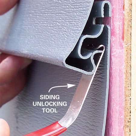

looked for flashing and under the vinyl at multiple locations and starter strip for wrb
Lifted at bottom but could not feel it.Does not mean not there but are you saying the weeps only stain if barrier is missing ?
What causes this that you would be alarmed?

i own and know how to use
i then know what to report and client gets instant info on site
btw a mirror is much easier than a hand for determining wrb presence or absence imo
i don’t stick my hand into places i haven’t looked first we have biting things down here
I have one of those also but will not do that in a Chicago winter.
You are in Texas so might not worry about how cold vinyl cracks easily.:slight_smile:
It was below freezing that day.
Those are great tools and easy to use.

I meant the zip tool. sorry.:oops:
I would put some anti fog on the mirror. :wink:
Do as I do. Leave it in my vehcile until needed (on my visor, clips included). A “chilled” mirror does not fog over when you use it in the cold.
OK so seriously Jeff you never worry that using the tool will crack the vinyl or you just hope they do not see you cracking it.:slight_smile:
Question for all is do you always use it every job?

Bob…
Perhaps you should look at a link BEFORE you comment on it!
The “tool” I have linked to will NEVER crack vinyl siding!
Just sayin’.
Not sure it will work but if that mirror makes a good crowbar I will try it on your say so.

I don’t see a starter strip, only bare plywood (no water-resistive barrier).
I look behind siding at butt joint, no tool needed or worry about cracking when handled with care.
