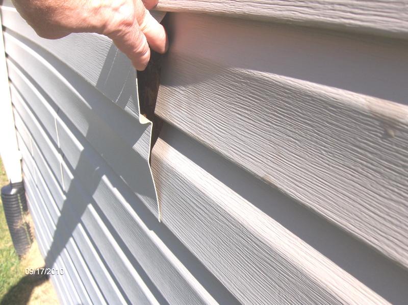

I inspected a home today built in 2004 with vinyl applied directly over OSB, without water-resistive barrier.
