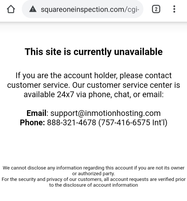

Right on. Went to peek at your website and seen it was down. Thought I’d let you know!
