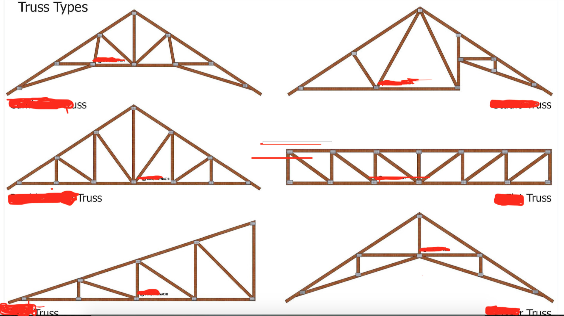

  6. Name these trusses.

6 Cambered truss Studio truss
Double Howe truss Flat truss
Jack truss Scissor truss

  6. Cambered Truss, Studio Truss, Double Howe Truss, Flat Truss, Jack Truss, Scissor Truss.

  6. Cambered Truss, Studio Truss, Double Howe Truss, Flat or Parallel Chord Truss, Jack Truss, Scissor Truss

  6. Cambered Truss, Studio Truss, Double Howe Truss. Flat Truss. Jack Truss. Scissors Truss.
