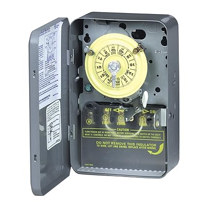

Water heater electrical wiring
Somebody already did, the picture shows flex cable, the original wiring before someone added the timer, entering the timer box. Every electric water I have ever seen on job sites wired by electricians and inspected by code inspectors used flex to the water heater. It was clearly wired that way before the timer was added.
I don’t see anything to argue about over this we all live in different locations controlled by different AHJ’s if required in Fla so be it write it up its not required in Okla by our AHJ so I don’t write it up the world is not going to end because of a section of romax not protected:shock:
Agreed Erik and the only thing needing protection if it can be proven to susceptible to mechanical damage is the cable to water tank.

Someone asked about the list of acceptable means of physical protection. Here is is:
The other approved means may allow for the liquidtight or flex. That is an AHJ call.
Thanks Jim! Key words there is what is accepted by the AHJ. BX is still the choice here. I have however seen many with rigid conduit for the first 18 inches and then NM after it is out of reach from mechanical damage.
Historically known as BX is now called AC Cable.
