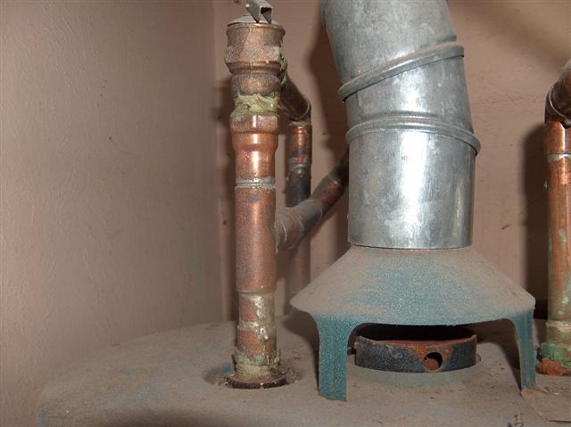

These pictures are from a Flip Home I inspected last week. The first picture shows the TPR mounted on the hot water distribution pipe. Second picture shows another connection at the 90 degree elbow for the TPR discharge pipe. :-k Hmm what could that be? It was a discharge pipe for the HVAC condensate sump sitting next to the hot water heater. The last picture shows the proper TPR discharge point having been capped off.
That was an accident waiting to happen!
