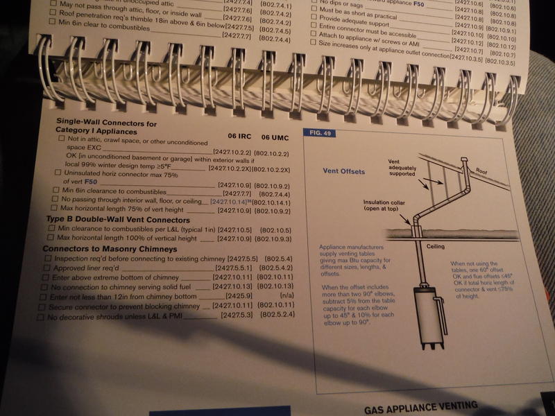

Here are a couple of tables / graphics that may come in handy if you do not already have… was on mobile earlier and did not have to post with my earlier comment.
