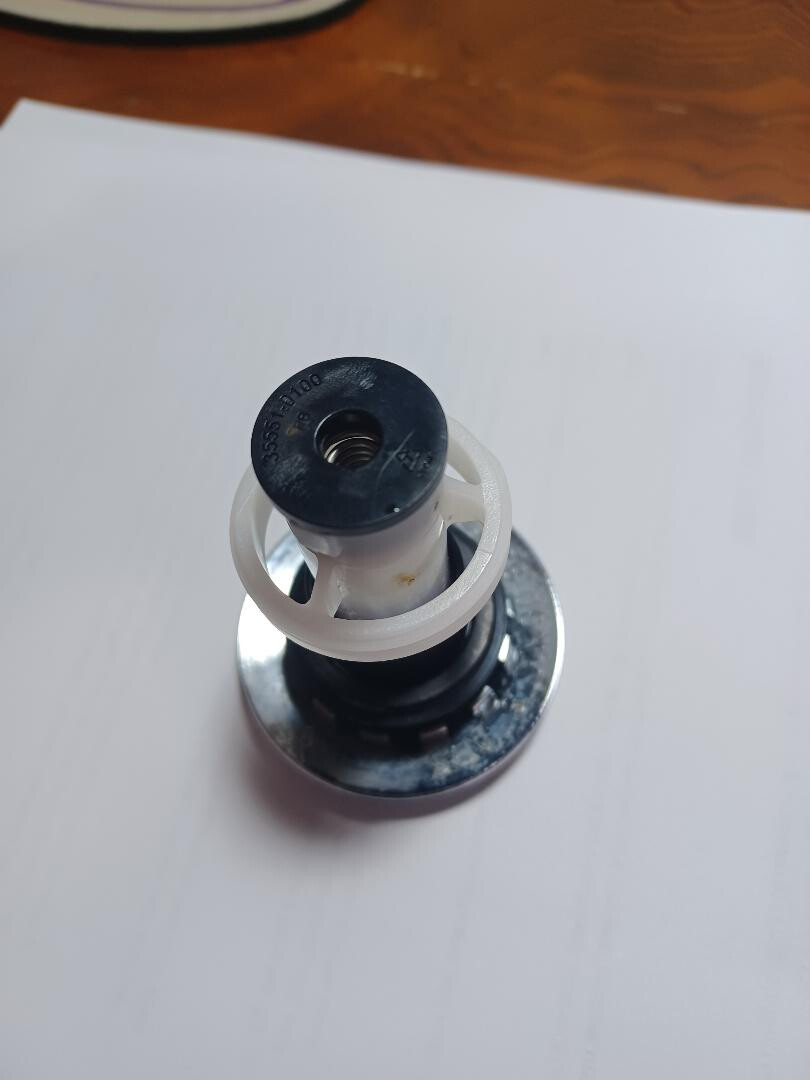

Only two bathroom sink faucets produce water with an odor for about 30 seconds from the Hot and Cold supply.
The home has PEX pipe.
House is on city water.
It is not new and has been occurring since the home was bought 8 years ago.
Faucets have been changed about 5 years ago.

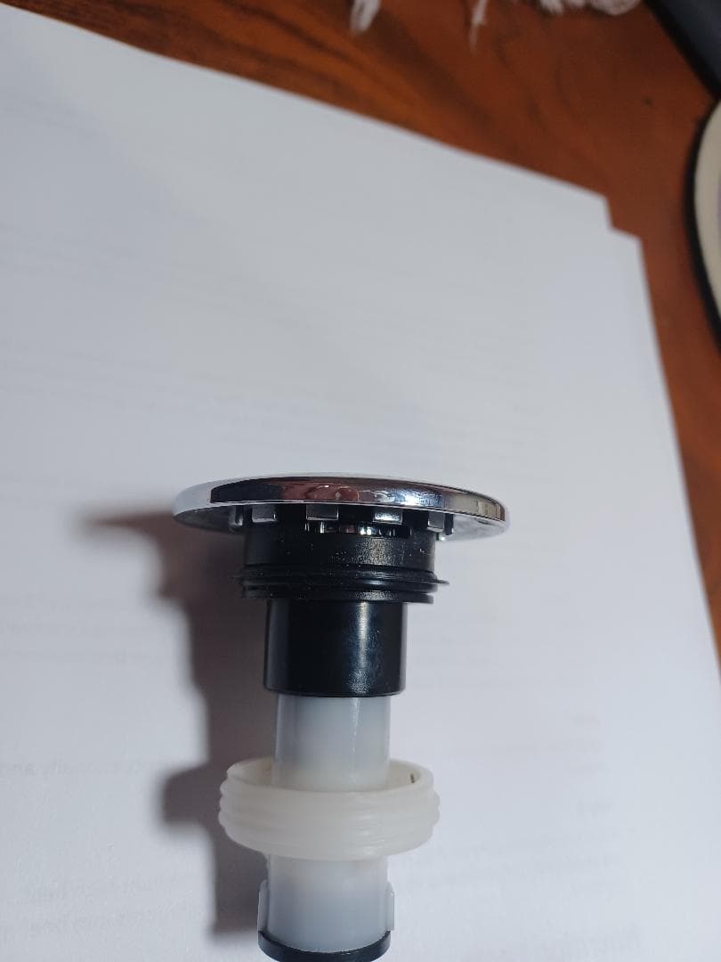

I may have found the cause. The faucet is Pfister brand and has the Push/Seal stopper. The stopper simply unscrews and lifts out to clean. I have ‘cleaned’ them a number of times over the years, but mostly just the bottom section to remove the hair. So today I pulled them out to do a cleaning again. Neither drain had any hair stuck in them so I just scrubbed a bit with an old toothbrush. When I was finishing rinsing one I turned it upside down and was flooding the underside of the stopper and WOW, the black gunk the starting coming out was scary and smelly! After a thorough cleaning with high pressure water stream I hope the odor goes away.
The slots that have chrome underneath were not even visible when I started.
The ‘tube’ turned out to be hollow. Before I started the hole from the bottom was not visible, solid black with yuk!
I will let you know tomorrow if this solved the problem. If not, you have given me other avenues to pursue.
Thanks to all for the advice!! Much appreciated!!

Solved!!! Last night and this morning used both sinks as normal and no foul odor. One more thing to add to the cleaning routine.
Thanks again to all.
