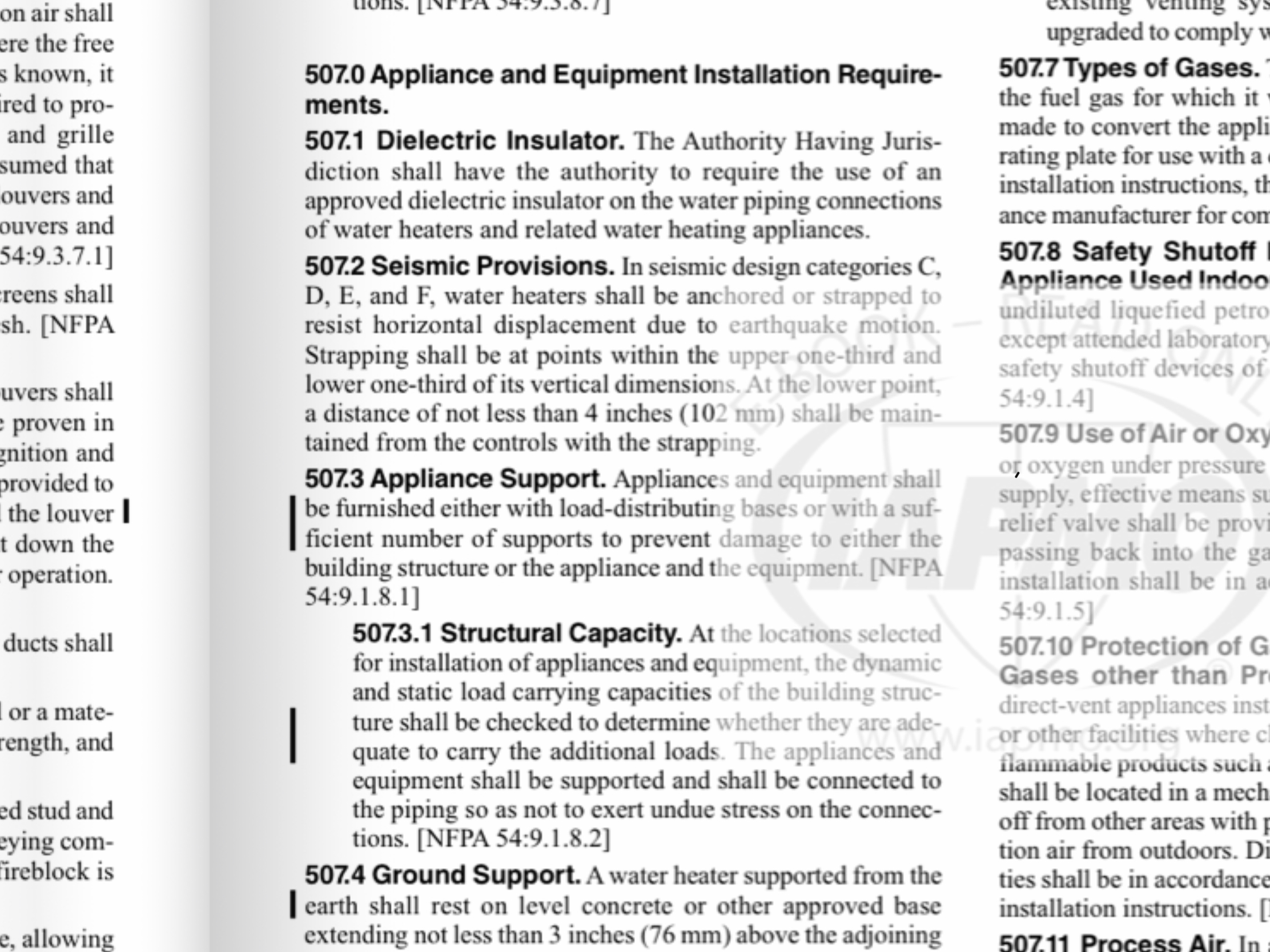

You may want to read this article. I am assuming you are in a seismic zone like California.
He’s in Washington State. Can’t go wrong with the California standards, but he really should avoid answering plumbing questions unless he is a licensed plumber!
From the UPC see 507.2. No material is mentioned however they do make excellent plastic and metal seismic straps manufactured specifically for the task. Galvanized plumbers tape is strong and has been supporting heavy cast iron pipe for decades. I have used plumbers tape long before the fancy stuff came out.
