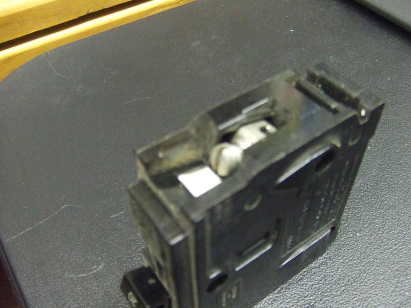

white powder on circuit breakers
I had a inspection today where I found some Siemens breakers, with white powder on them in the pic, is this oxidization or something from the factory? It is on all circuit breakers in the same location.
Factory installed sealer of some sort. You will find it on most Siemans breakers.
This is very interesting! this stuff will start to cake or powder off? seems like some are in better conditions than others. it is not white oxidation.? Are these breakers common? or is this a newer design, this house was built in 2002.

did not think drywall dust, i blew on it, it was very secure. like it was caked on.
it is a sealant.
pic of a new breaker below…
Great! Thanks for the Picture!

It’s a material used to keep someone from tampering with the screw. It’s not always white:
I found the same white coating on Siemens breakers, at first I thought is was oxidation as well. The picture on other inspectors comments is a GE breaker. This property was near the ocean, so I thought is was salty air. Great to have InterNACHI resource!
