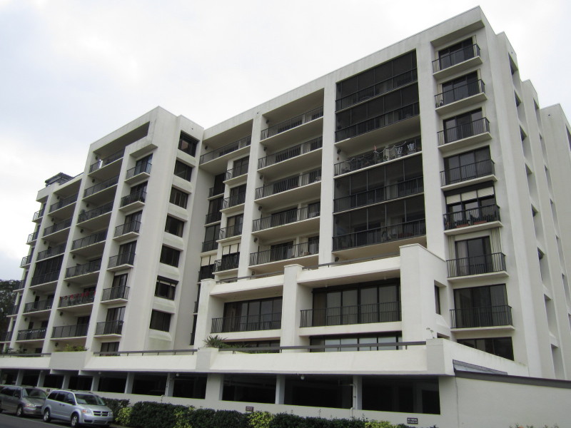

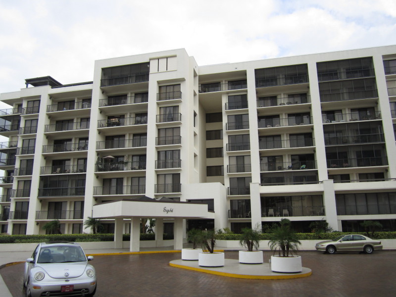

Did a Type III wind mit today with an example of a building with a partially enclosed parking garage. Front of building is 8 stories, and rear is 9 stories…selection on form is 8 stories. The previous WM was done by an engineer in 2010 and listed the stories as 9, and incorrectly submitted on the 1802 form (wrong form).
