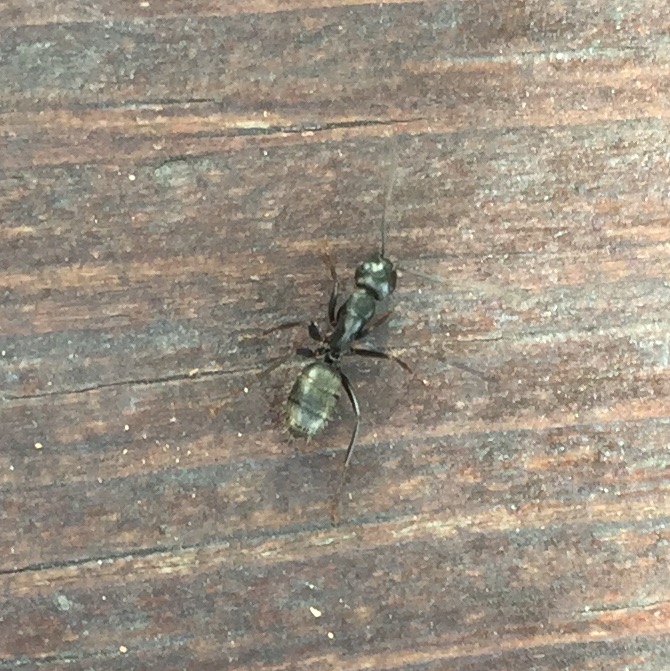

Ant Inspection
Ants can cause serious damage to a buildings structure an inspector can identify some of these problems by education and knowledge. To identify the difference between an ant and a termite; Ants have elbowed antennae, termites are straight. Ants have a broad waist and termites have a thin waist. Ant’s wings are not the same size and the termites wings are identical (same size).
Ants like to live in damp moist area and normally have hidden nests. Locating a nest can be conducted by tapping along walls and baseboards, listed for sound of ants rustling.
The home owner can take many precautionary steps to prevent infestation by just by keeping food items and residues off surfaces, sealing any external openings into the home sealed.

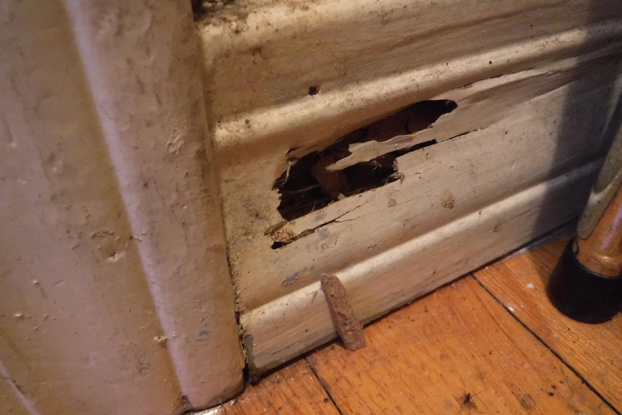

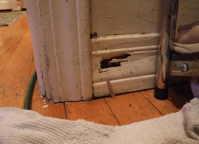

Apparent wood destroying organism damage in laundry room baseboard. Recommend further evaluation by a licensed WDO professional.

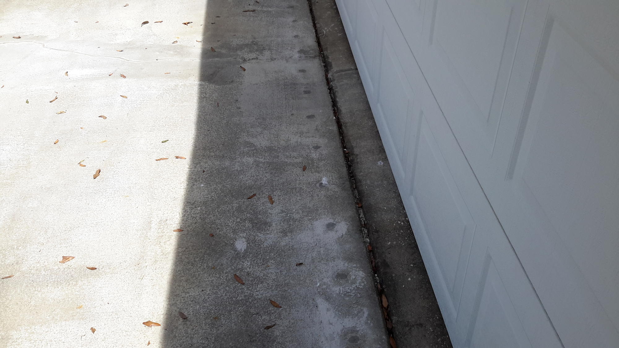

I live in northwest Florida which has a large rate of subterranean termite damage. Certain times of the year you will see the swarming termites (Alates) flying around the yard. They are so small that they will enter your house and you will see them on the cealings around vents, lights and ceiling fans which can be quite alarming. There are two houses in my area that had thousands of dollars in damage because they thought termite protection was to expensive to buy, now they buy the protection. I have had my house protected since the day it was built. In the pics you can see where they drill holes in concrete and brick to inject the treatment. This treatment is good up to 8 years, but they usually retreat the whole house again every 5 years or sooner if you disturb the soil around the foundation for an addition or building project. The treatment co. then leaves a treatment card to be posted in my case on the electrical panel in the utility room with the date, company name, address and type of treatment. Termite protection is expensive here in florida, but if you plan on moving here I would advise anyone that the protection is a necessary evil.

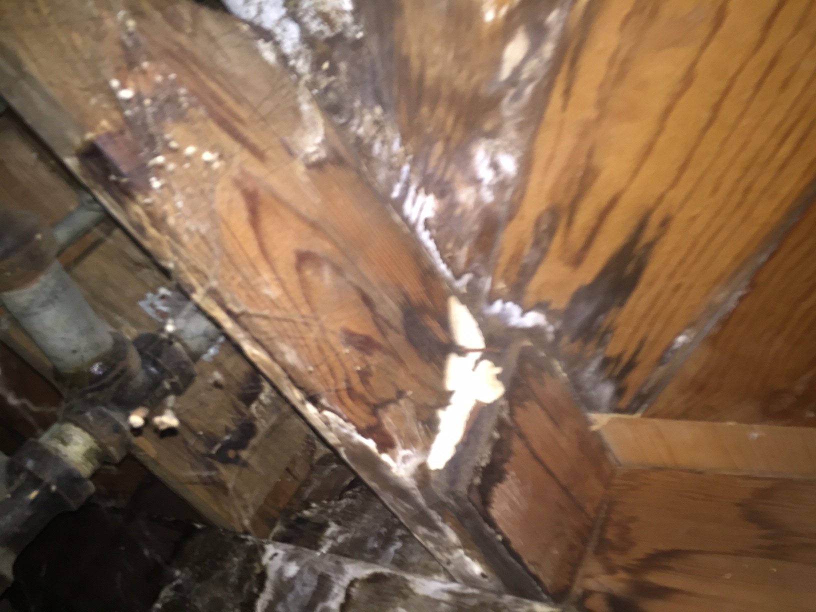

Here is a sub-floor with some dry rot that is in need of some attention. There was not apparent indication of this problem at the vinyl sheet flooring above, i.e. discoloration. Recommend evaluation and repair by qualified tradesmen.
