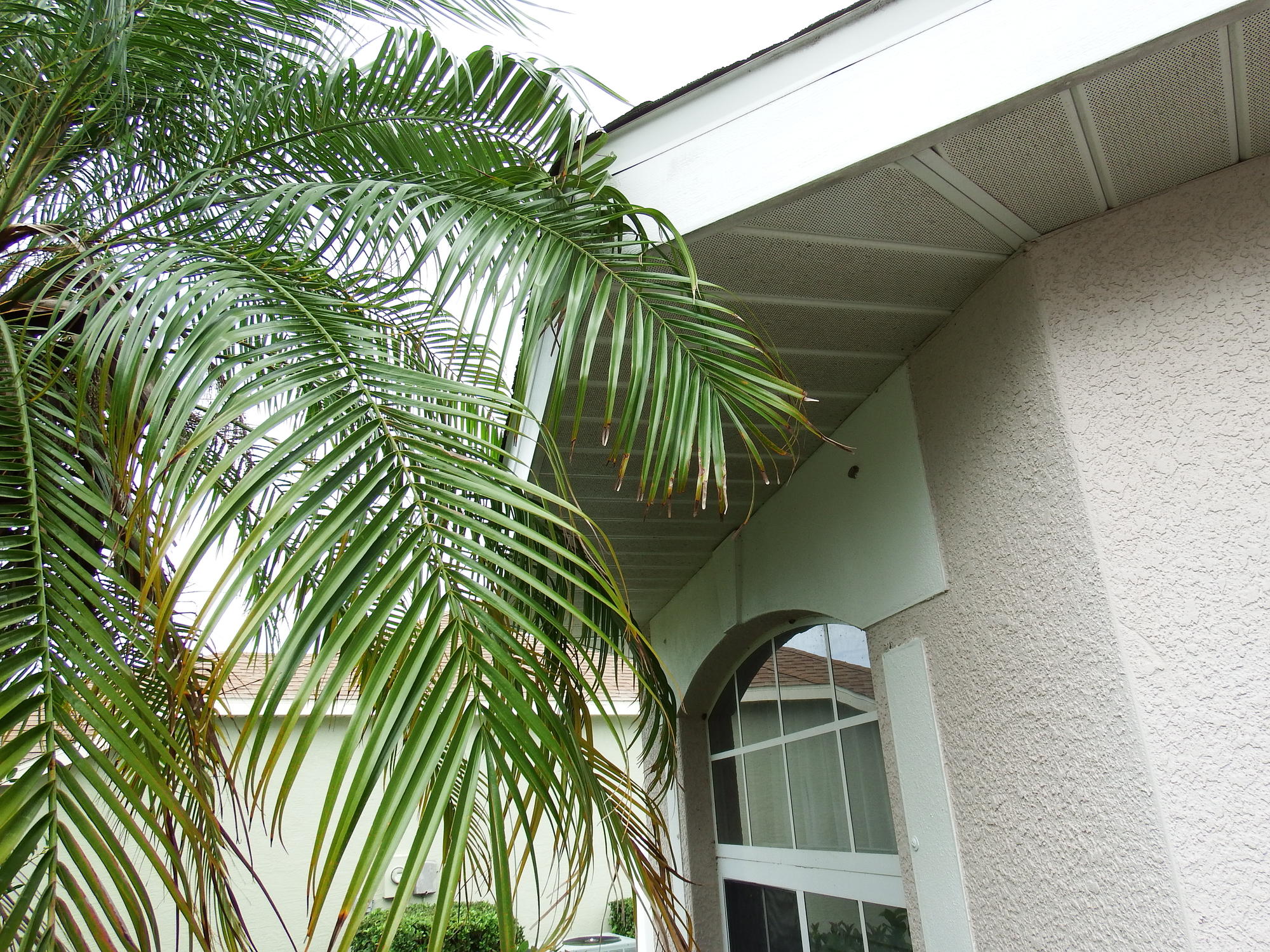

The above image is of a palm tree in contact with the roof and fascia. It is important to keep trees and shrubs trimmed back from the structure to eliminate the potential for pests to use them as an access point. The untrimmed limbs can also cause damage to the roof or fascia allowing moisture damage and a place for wood destroying organisms to thrive.

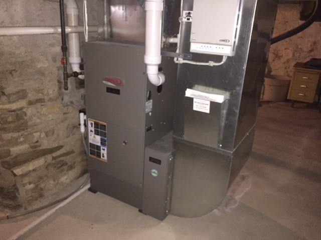

I found this course very interesting since I live in North Central Iowa and we do not see many problems with WDOs. I will be checking with my state to see if a license is required to perform WDO inspections. I am attaching a photo of the furnace I inspected because the unit vented out the side wall using PVC piping and the penetration was not sealed allowing inspects to enter the house

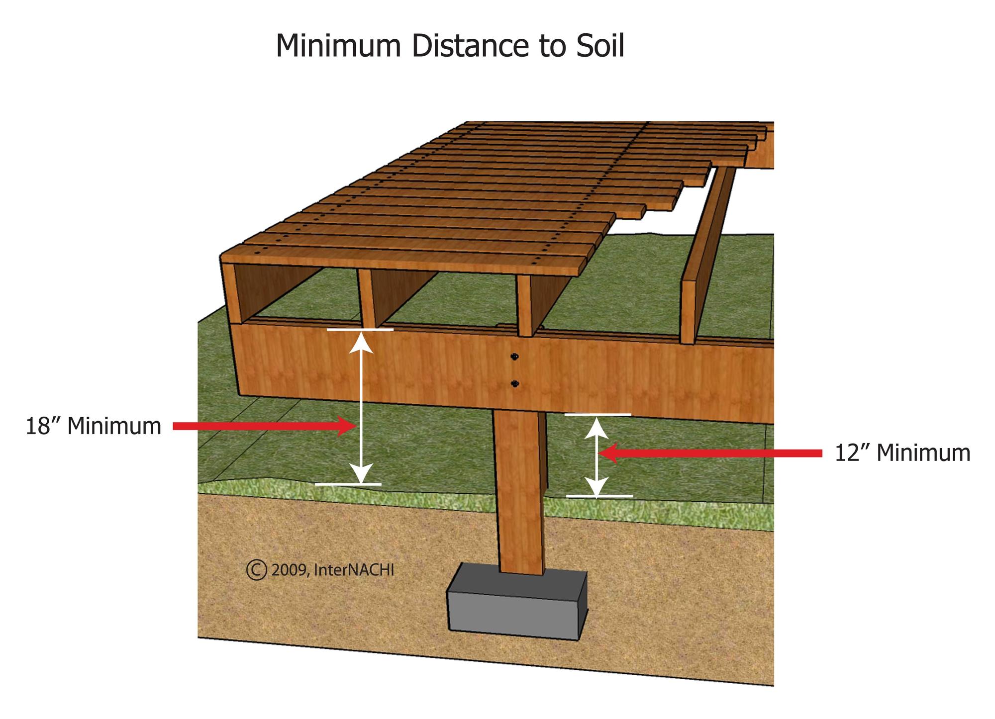

The picture above is related is informative of my essay. In the picture minimum clearances can be seen between wood and the grade below. These clearances are extremely important to the health of the wood, house, and safety of the client. When these clearances are not kept the risk of damage to structures and the house is much more imminent. Wood that is too close to grade encourages wood destroying insects. Using proper supports, posts, and clearances discourages/prevents insects from causing costly damages.
