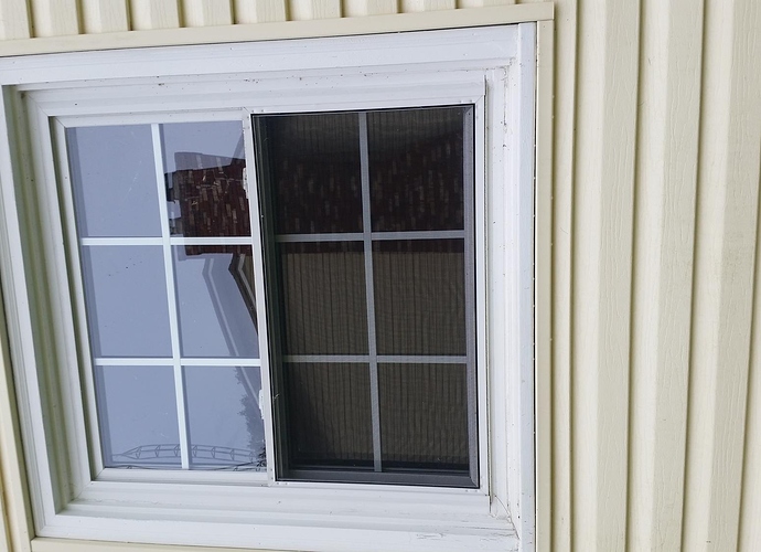

The home has newer Jeld-Wen vinyl windows. Windows seem to be properly installed, and work well. Windows are well caulked, and the locks operate.

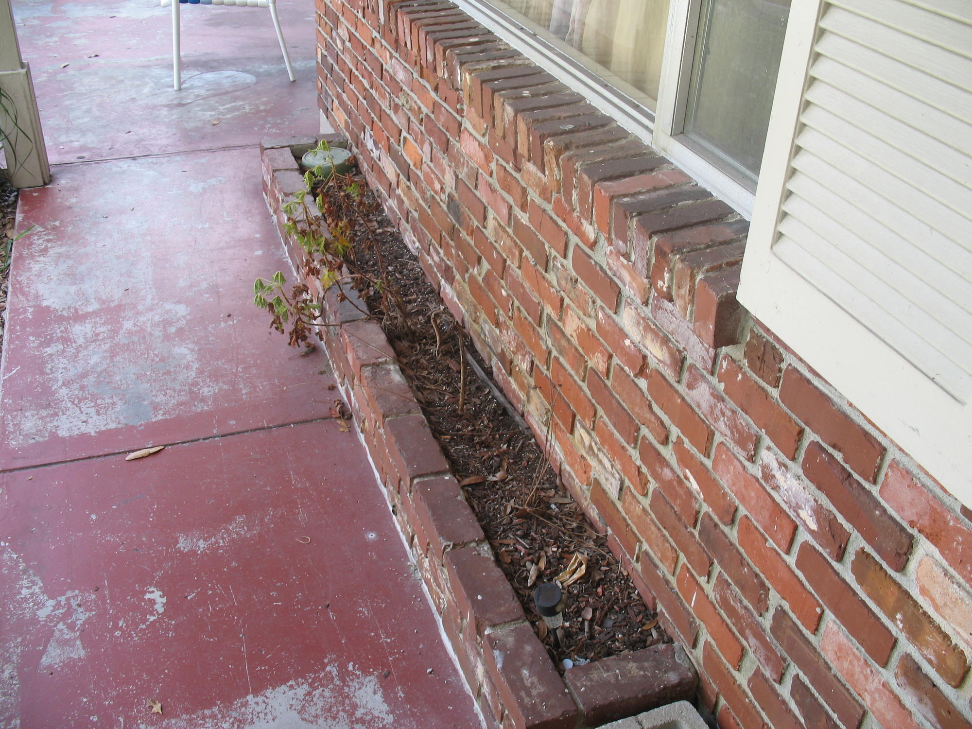

The untrained eye might see the aesthetic appeal of a flower box, but this only invites insects to have access to the foundation. This flower box is constructed of brick and is adjacent to brick fascia on a typical Florida foundation, “Supported slab”. Insects have plenty of entrance ways to the foundation and up structures via cracks and air spaces. There is also a pile of construction wood in the back yard which can serve as nest before entering the home once the nest populates and moves to the house. I would suggest immediate removal of flower box and wood.

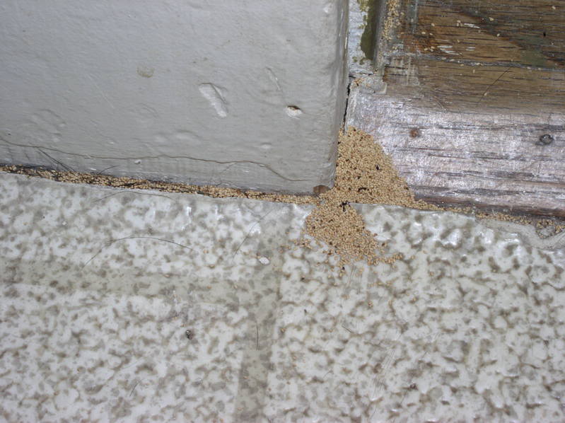

The phot attached showed previous treatment in garage by drill marks. This area did not show any visible evidence of termite at time of inspection. On report I noted previous treatment noted due to termite drill marks, no evidence of termites or wood destroying insects noted.

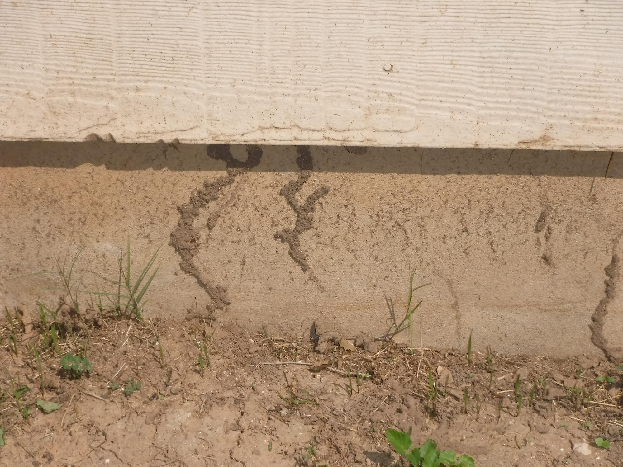

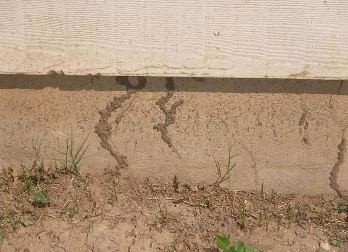

The photo I provided was from an inspection I did this week. The photo shows a mud tube on a basement wall. The mud tubes were located in an area of the basement which had conditions conducive to a termite infestation… The tubes extend upwards towards the subfloor. I examined the tube and saw no evidence of live subterranean termites. Upon further inspection I could find no indication that the home has not been treated for termites. These conditions were noted on my Official Wood Destroying Insect form.

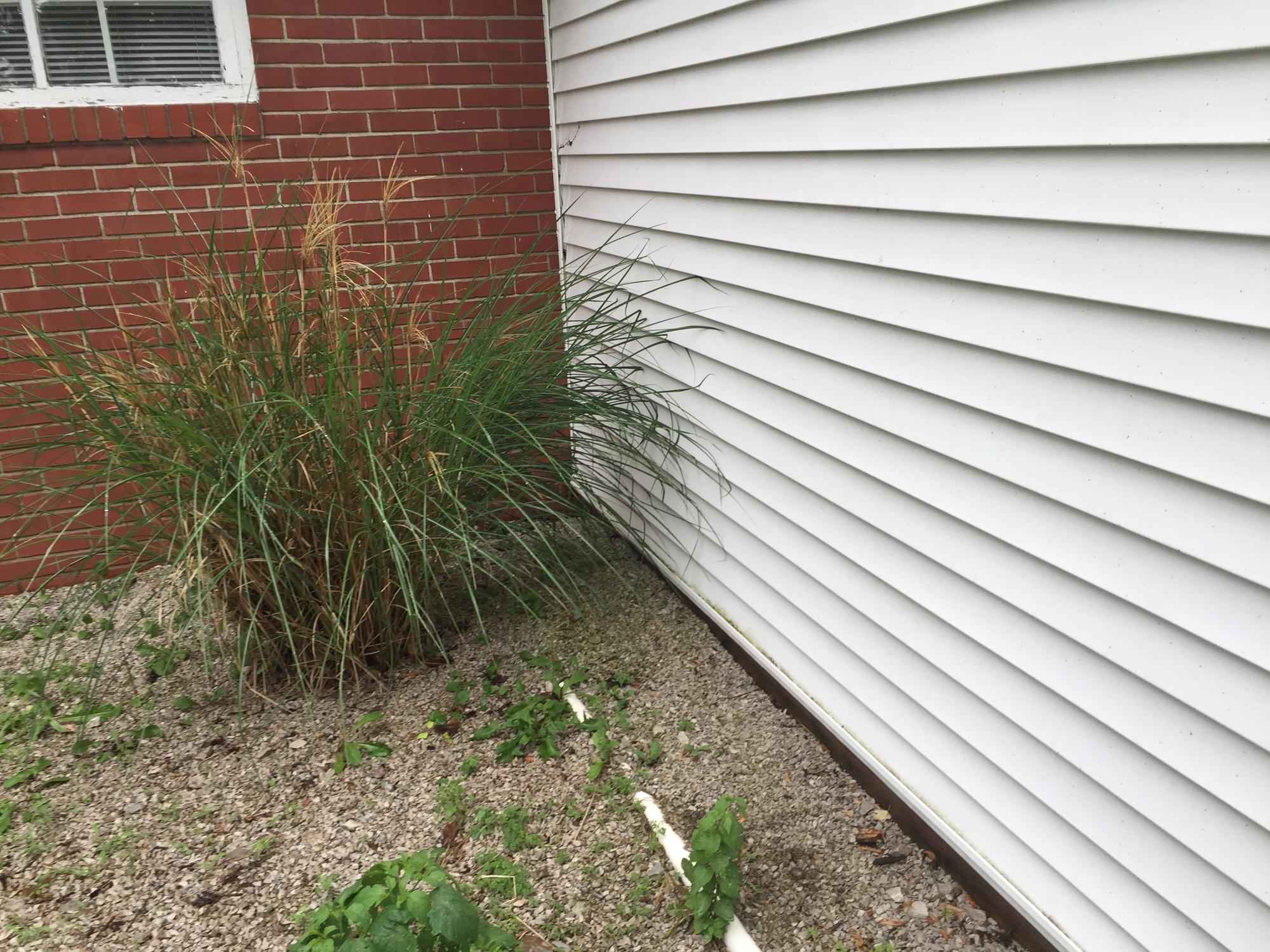

I don’t actually have a picture of any wood destroying organism damage or evidence of activity. So I put a picture of a likely spot of termite entry. The home pictured here has the wood siding in direct contact with the ground. This is an issue from a wood destroying organism and a moisture penetration point of view. The lack of spacing between the ground and the wood siding could cause a whole host of problems.
