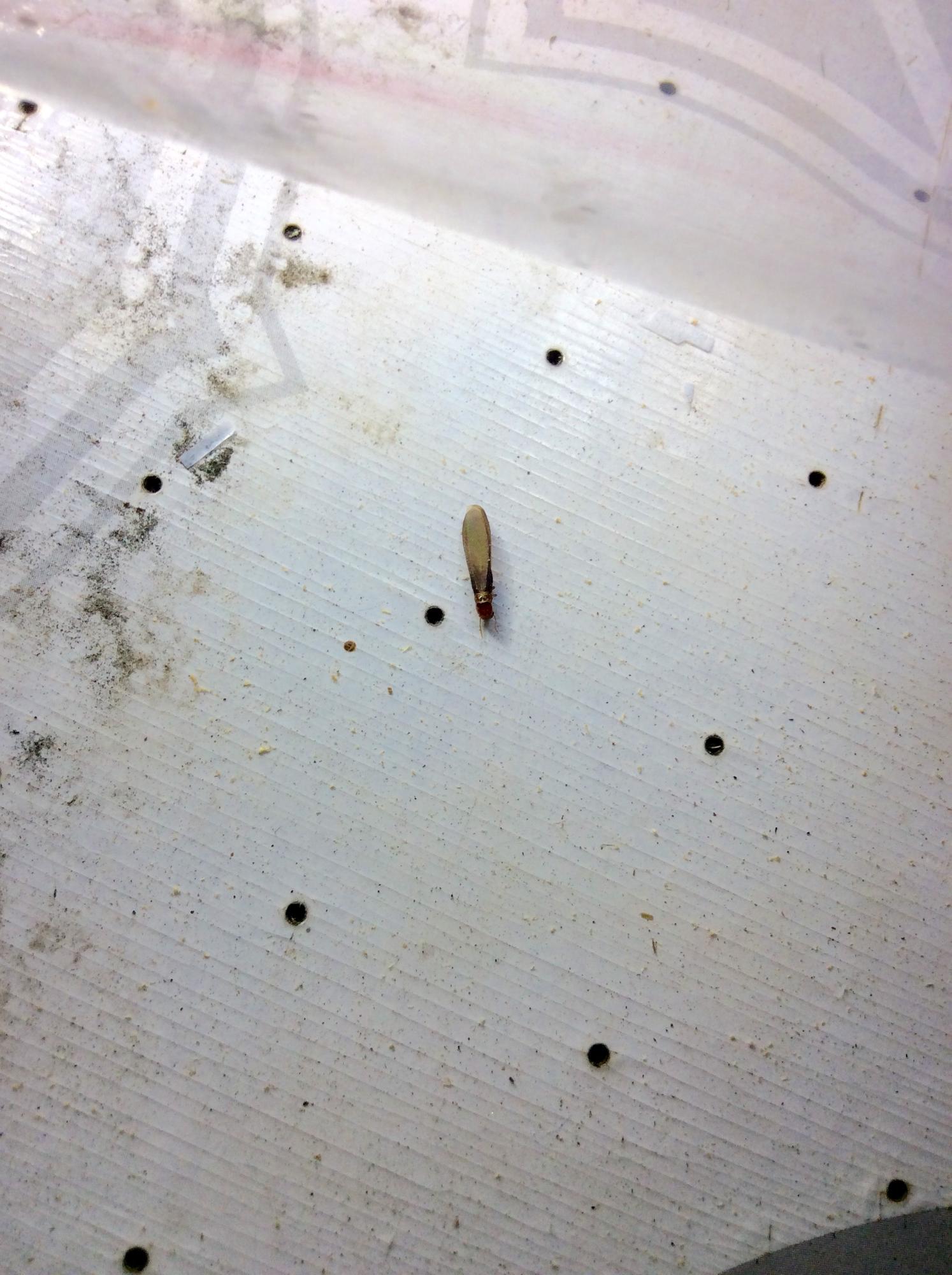

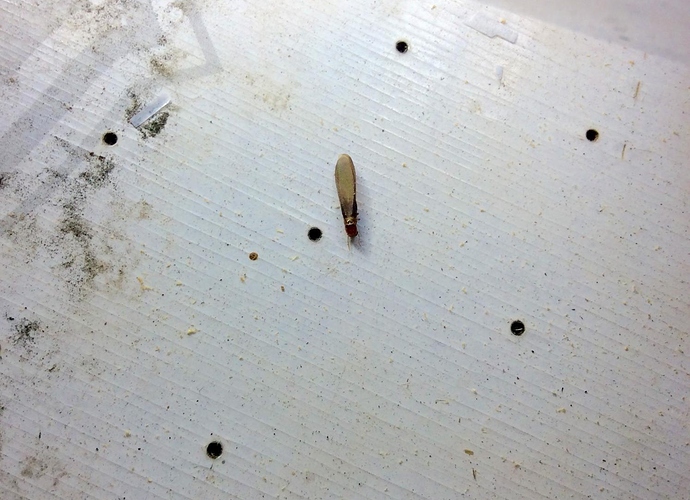

This is a photo of a termite that I found on the table outside of my house. It’s hard to tell in this photo but the head of the termite is orange in color. Also, there are several dark veins branching out through the wings of this termite. These features help identify this as a Drywood termite. The subterranean termite would have a black head and only one vein near the leading edge of the wing. In the region where I live, Drywood termites account for the majority of structural damage caused by wood destroying organisms.

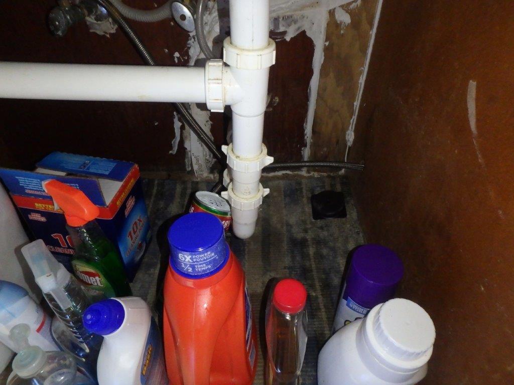

Moisture present under kitchen sink. Active leak observed at cold water shutoff valve. Valve leak should be repaired and damaged wood should be replaced. Sink cabinet sags at bottom and should be repaired/ replaced.

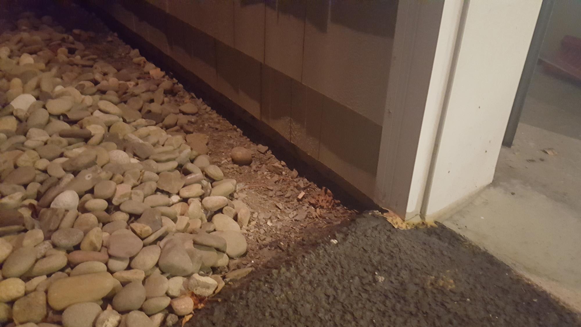

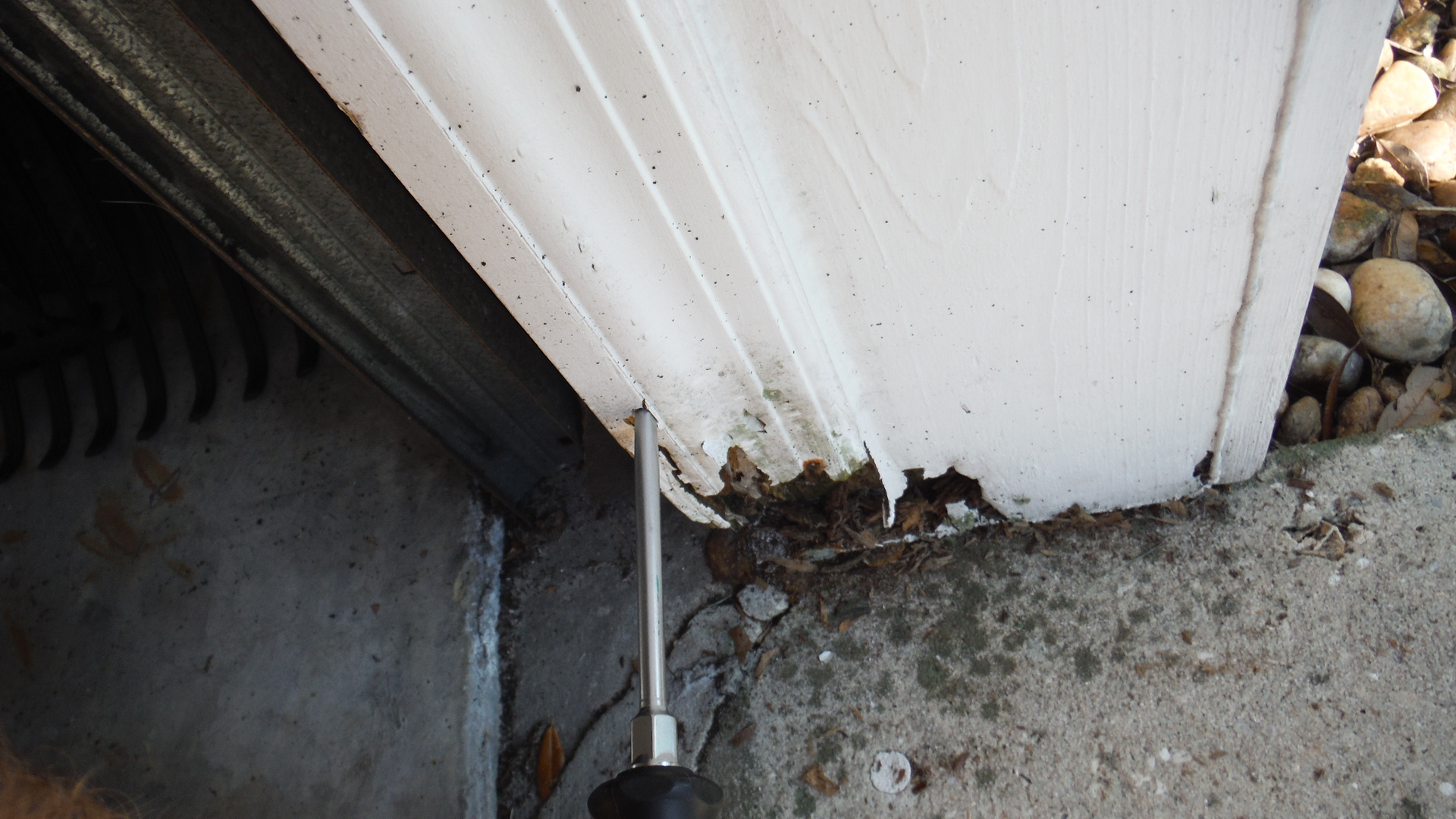

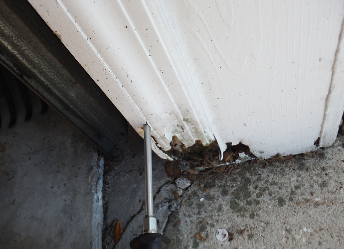

In this image, the exterior garage door frame and brick molding are in contact with the concrete floor and driveway asphalt. To the left of the frame, the bottom of the cedar siding is approximately 4’ beyond the sill plate which sits on the concrete block foundation. From the inside of the garage (not visible in the image) the floating slab covers approximately 4” of the block leaving the sill plate about 4” above the slab. The landscaping stones have been pulled back from the foundation exposing the foundation. There were no signs of any WDO activity past or present in this area at the time of the inspection.

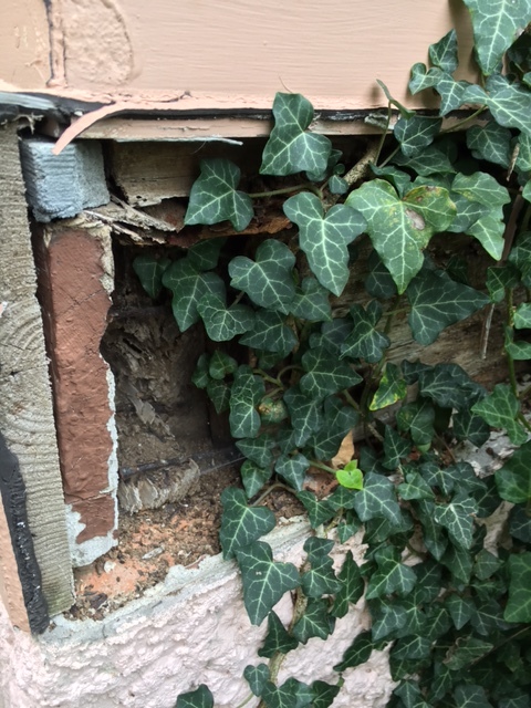

This picture shows wood decay from being wet constantly promoting algae and insect damage. If you look close you can see some bore holes in the decayed wood. It is because the plant growth that moisture stays in this area and creates a great place for insects , fungi, and algae growth. The home owner was aware and has since remedied this by cutting out the bushes and replaced the decayed members with pressure treated lumber.

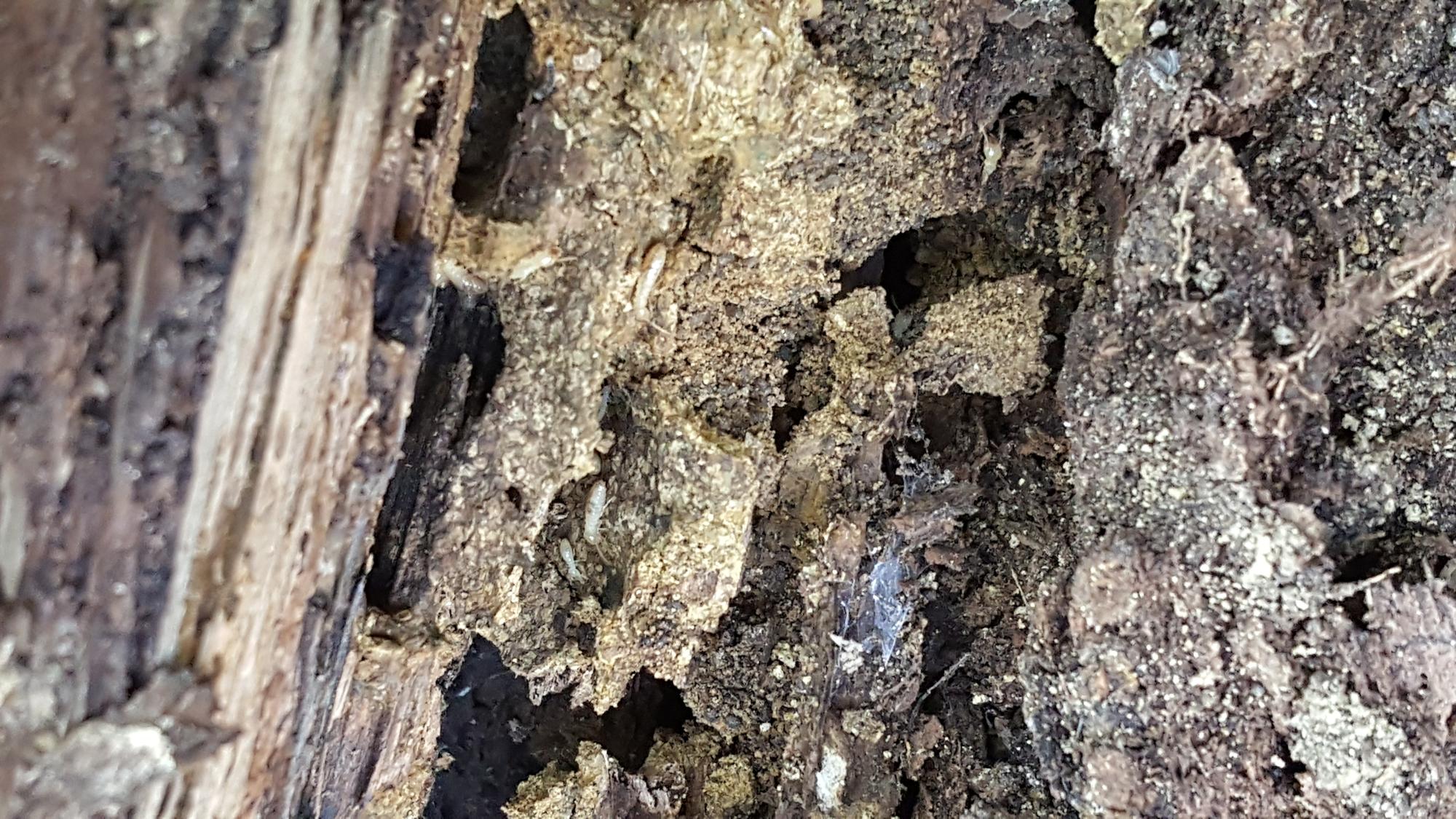

If viewed closely, there are subterranean termites visible in the image. They were found in an old wood pile only a few feet from a detached garage. Due to the proximity of the wood to the garage, I would consider this a conducive condition for future termite structural damage to the garage. The old wood pile needs to be removed to limit this potential issue.
