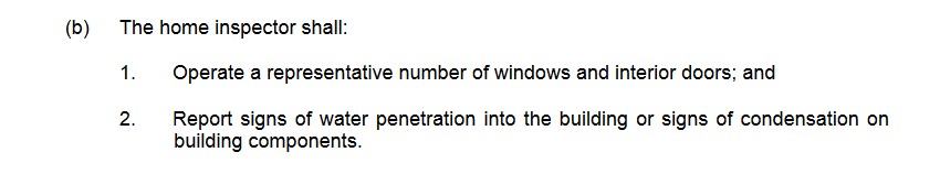

Does your state home inspection standards indicate otherwise?
I agree with this approach.
I could tweak this a bit to align with exactly what the SOP says which is basically normal operating controls. However, the SOP is weak on things like how to test a GFCI.

We don’t have a state standard, but still a great point, since I followed the NACHI SoP. But not a point that this guy was interested in hearing. Of course, the SoP is a minimum standard and most of us go beyond the Standard when inspecting.
