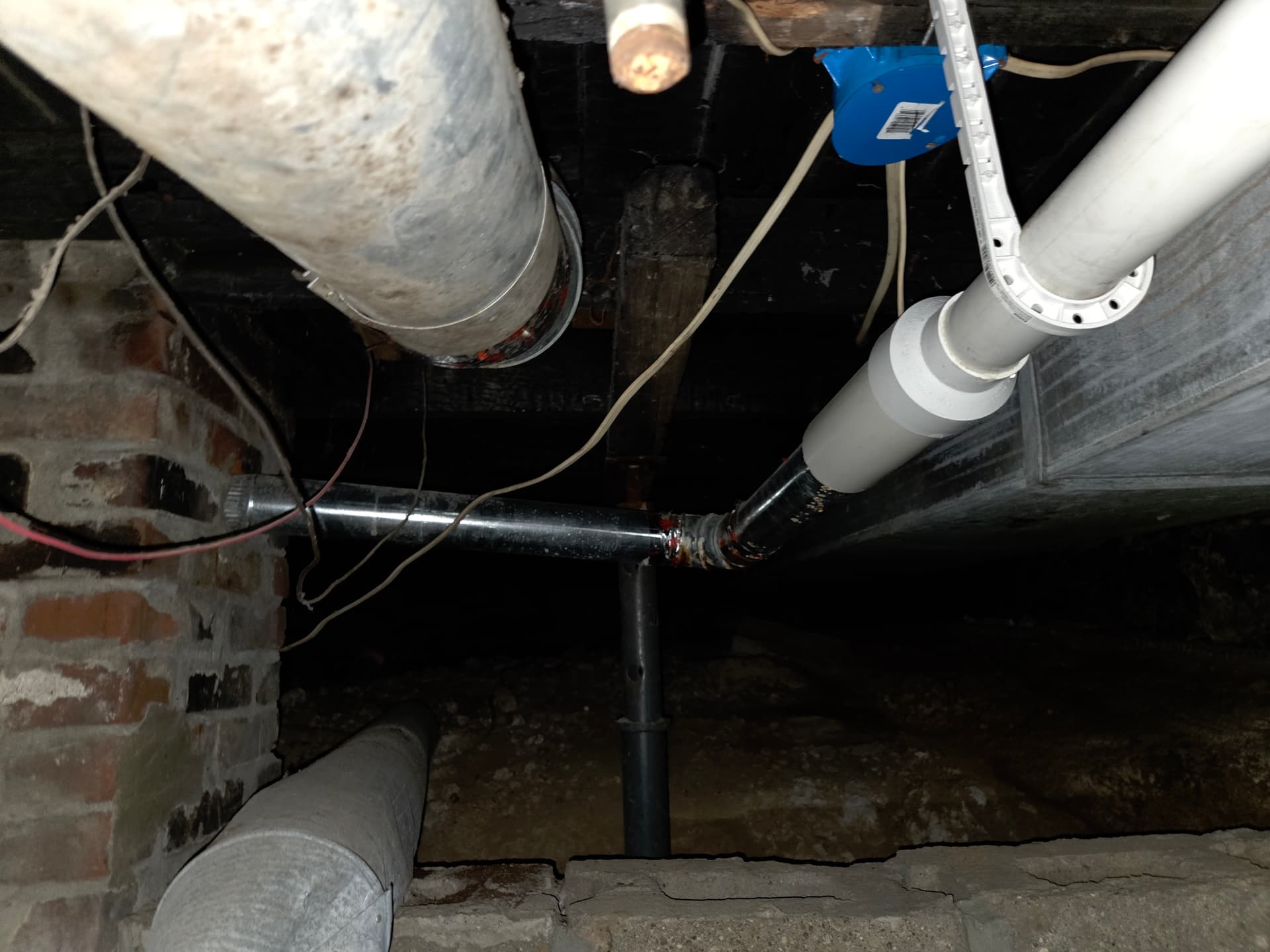

What’s the date on the new water heater? Could it be a replacement for a failed power vent unit in the same location?

  1. No it wasn’t a replacement just a fubar. There was about 12 ft of vent pipe running to the chimney flue. And it was a combination of PVC and Metal.
It was the same crew that had a 60 amp breaker with 8 gauge wiring connected to the clothes dryer receptacle.

There’s an additional defect then.
The brick chimney is so massive, there’s no way it can properly heat up given the relatively puny gas burner of the water heater. Thus, the chimney flue won’t draft properly: at least not reliably. A cold day and water has not been used in a while, the flue gases hit that cold ceramic or brick, cool down, and drop right back down.
The water heater vendor instructions, in both Spanish and English, likely specify the flue requirements. And brick chimneys don’t count.

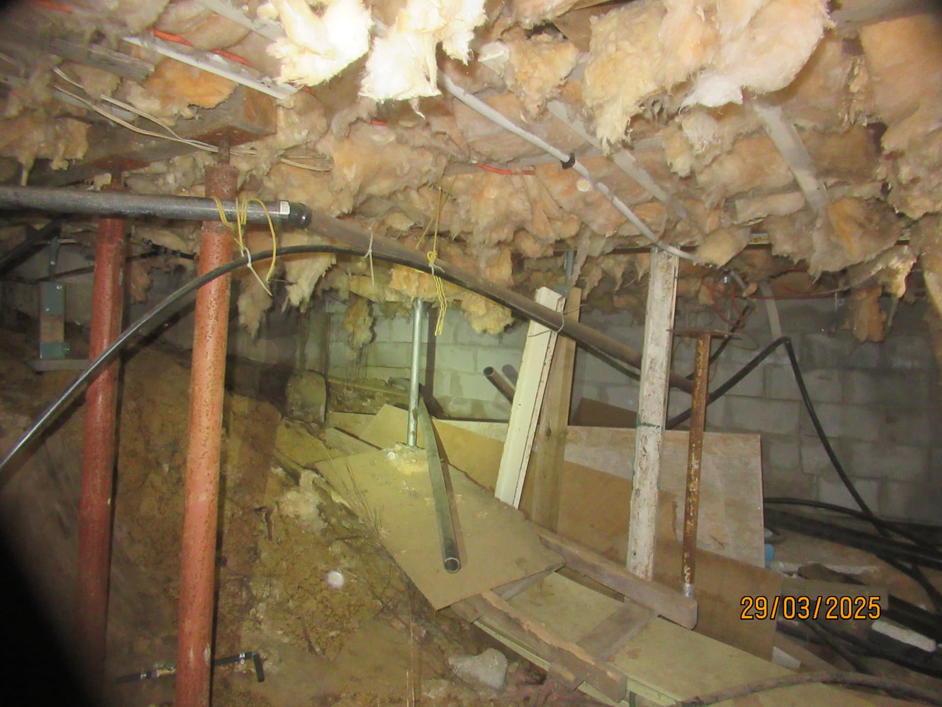

Clean crawlspace, not…

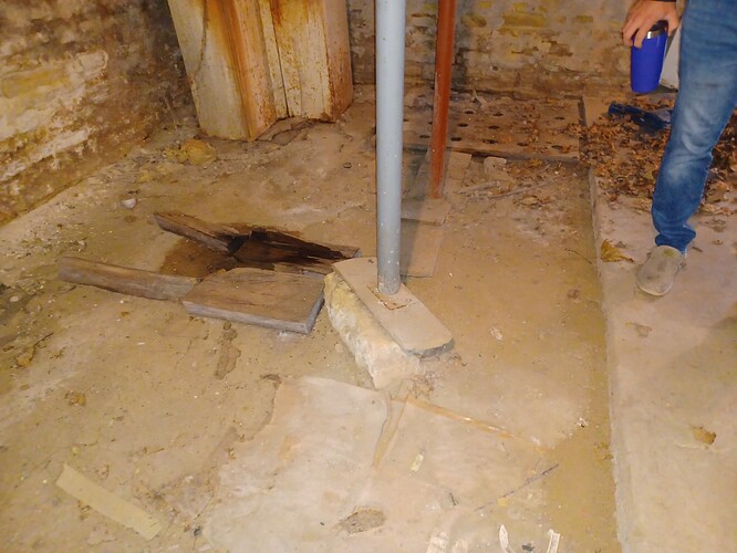

Here is today’s beauty! I mean… Rocks work as supports. Right?!

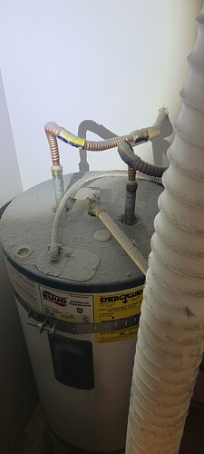

And this is what 21 years of dust looks like on a water heater!
Shockingly the pipe was tight. I figured it’d just be floppy and loose…it wasn’t Someone put this up there and snugged it down.

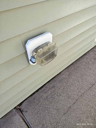

Not really a WTF, but just the first time ever seeing in my area. Maybe others in more urban areas see it a lot.
