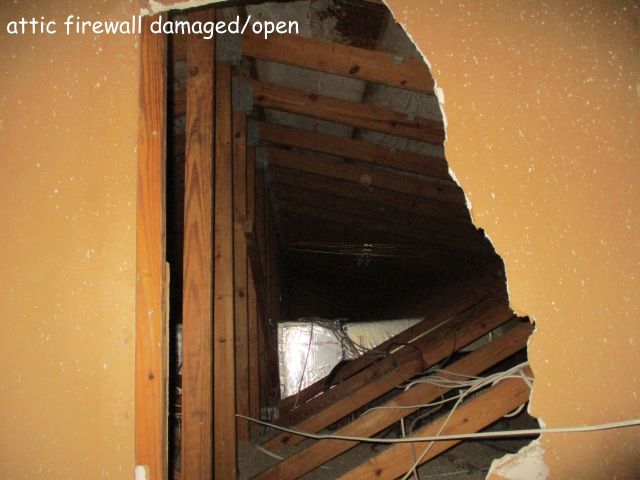

mgoldenberg
(Marc Goldenberg, Inspector # HI1365)
April 10, 2025, 6:59pm
3892
Spot on Jeff
Here’s one where I reported an open firewall.
A few years later the bldg burnt down from an ungrounded ceiling fan.
The holes created a back draft where the fire doubled in size every 60 sec. Comcast got sued
jspencer
(Jeff Spencer)
April 10, 2025, 7:12pm
3893
Marc Goldenberg, Inspector # HI1365:
Cable/internet installers have zero craftmanship. If they are not kicking holes in draft stops, they are running the cable across the scuttle hole and/or electrical panel. If a job needs 50 cable staples, they use 6. I’ve seen them disconnect grounding electrode conductors so they can use the clamp for their ground. It just never ends.
I had fiber installed four years ago. At least 20 calls later, the cable is still not buried. They are just trying to get caught up, but I am always next on their list.
