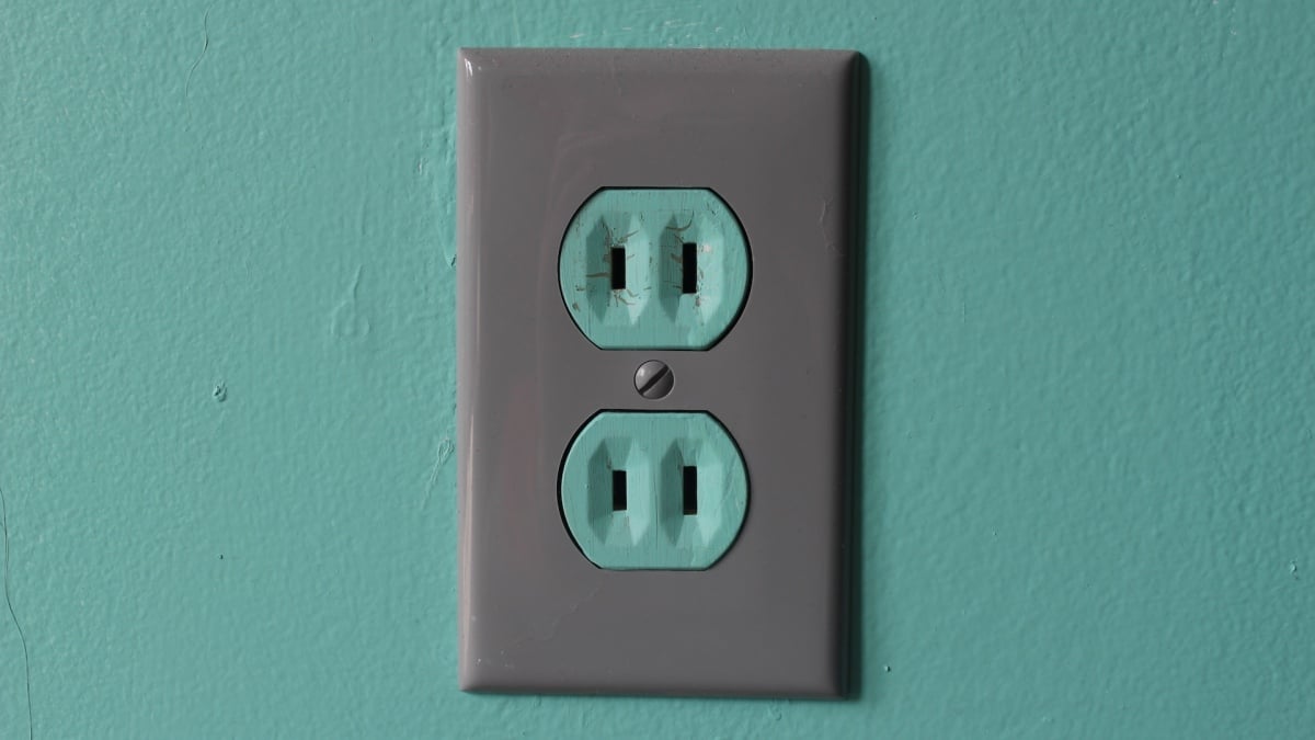

I think I might start including this link on my report, for open ground 3-prong outlets…NOT
This is a quote from the article:
“And you should definitely upgrade—two-prong outlets lack a ground wire, which protects you from electric shock in case of a voltage surge”
Nonsense! This is yet another example of what’s wrong with the internet. Anyone can post any nonsense they want and there will people who will believe it. Like Abraham Lincoln‘s famous last words as he was dying from a gunshot wound, “Don’t believe everything you read on the Internet”.
A lot of older homes still have old-school two-prong outlets. It’s a good idea to upgrade them—and you can do it yourself.

Most of the structures in Japan do not have outlets with grounds. As a retrofit most all have GFCI breakers. Very few household appliances use grounds on the cord now anyway.
They’re still manufactured because they are permitted by the NEC as replacements for existing two prong receptacles.
Although many of the aspects of this article are incorrect the overall premise of replacing these old two prong receptacles with GFCI protection isn’t. It can certainly be argued that replacing a 60 year old receptacle with a modern GFCI receptacle is a safety benefit. For one the spring tension on the old device is probably past its prime making it a hazard because plugs can be loose and may not be making proper contact. Then there is the people who snap off of the ground pin to plug something into the receptacle or those who improperly use a 3 to 2 prong adapter.
Although GFCI protection is not a substitute for grounding at least with GFCI protection the user is safer than without it.
Which was my point.
Yes, you can add a 3 pronged GFCI receptacle, and it might add a small amount of personal protection, but the vast majority of the time, the reason your average homeowner changes a two prong receptacle to a three prong receptacle is so they can plug in their $2,500.00 OLED TV or their $3,000.00 Mac computer, and a GFCI receptacle won’t protect those devises in the same manner a grounded receptacle would.
Yes a replacement with a new two prong receptacle would certainly mitigate the problem of the decades old device being warn out. It would not help with the other issues that two prong receptacles have when used with an ungrounded wiring method.
And that would certainly be ironic since both of those devices are two prong plugs.

TV’s can vary as to whether or not a 3-wire cord is provided. For something like a washing machine circuit with no EGC a three wire GFCI receptacle as a replacement for an old two prong receptacle with 3 to 2 prong adapter would greatly increase safety.
99% of the electrical products we buy these days only have two wire cords anyway.
