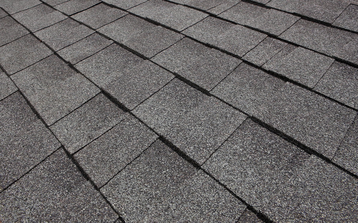

This photo is of a three tab asphalt single installation with a significant amount of granule loss. Granule loss is one of the main indicators of aging shingles that may signify that the roof is reaching the end of its serviceable life. Further investigation and consultation with a roofing contractor is advised.

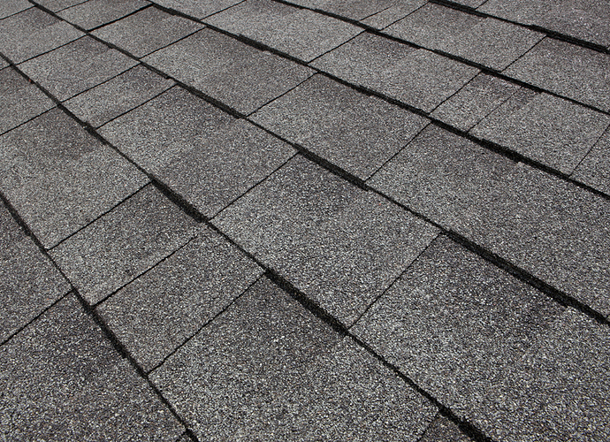

When your asphalt shingles have dark stains on them it could be a sign of wear caused by the granules wearing off. This allows the asphalt base to show through. This could be near the end of the shingles service life.
If the stain is blue, green or black this is a sign of algae. Algae is not harmful to asphalt shingles but is ugly to look at.
A green moss is also common on roofs that are tree shaded. Moss can cause shingles to lift and curl at the edges.
A 50/50 concentration of chlorine bleach and water can remove algae and moss. Use a sprayer and soak the area with this concentrate. Let it sit for 30 minutes then rinse with garden hose. (do not use high pressure due to possible damage of the shingle).

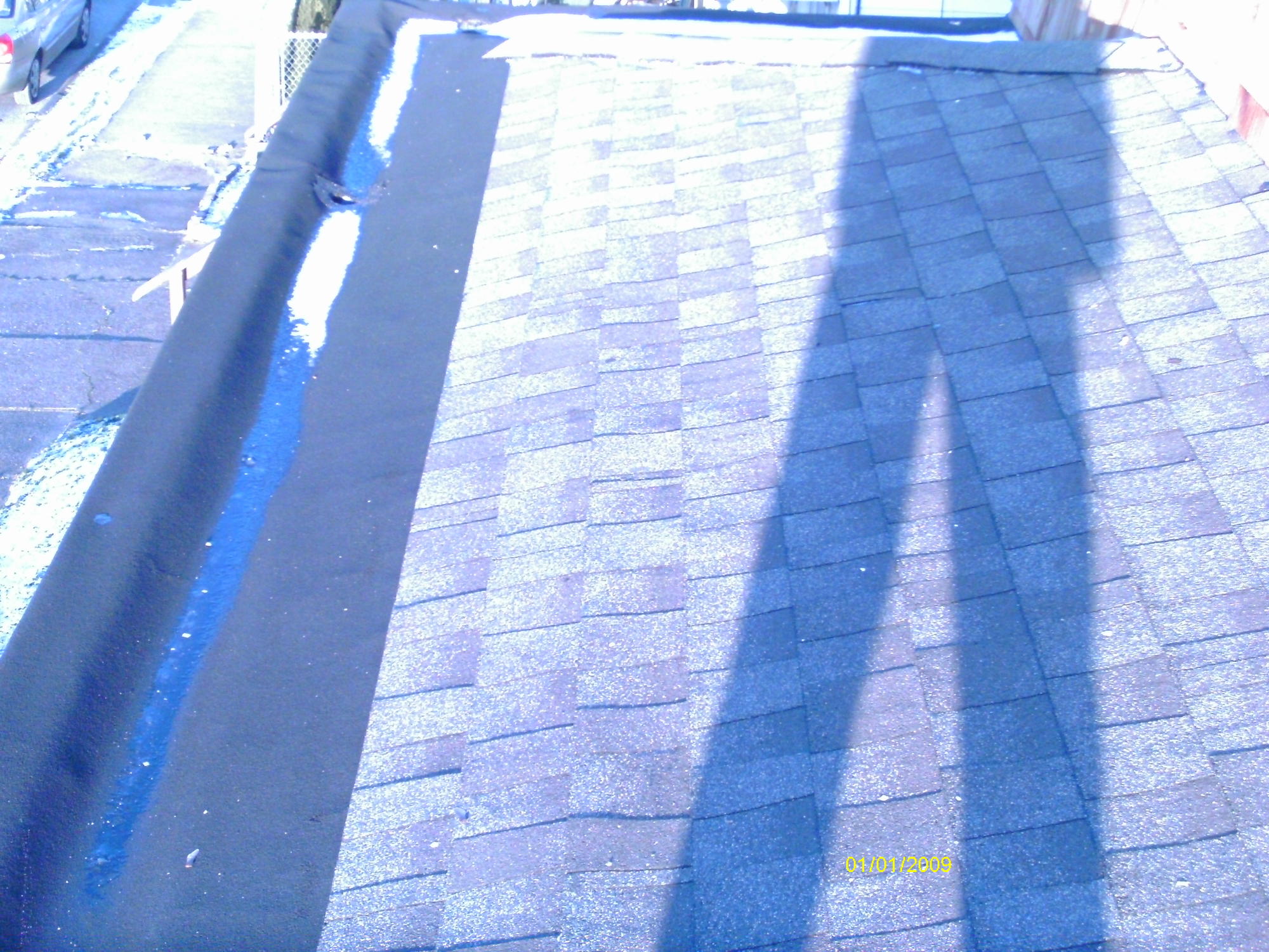

This is a hip to hip roof with box gutters. The roof covering is a dimensional shingles and granulated rolled rubber lining the box gutters. The roof, gutter, and drop tubes where installed recently. This roof should bring many years of dryness.

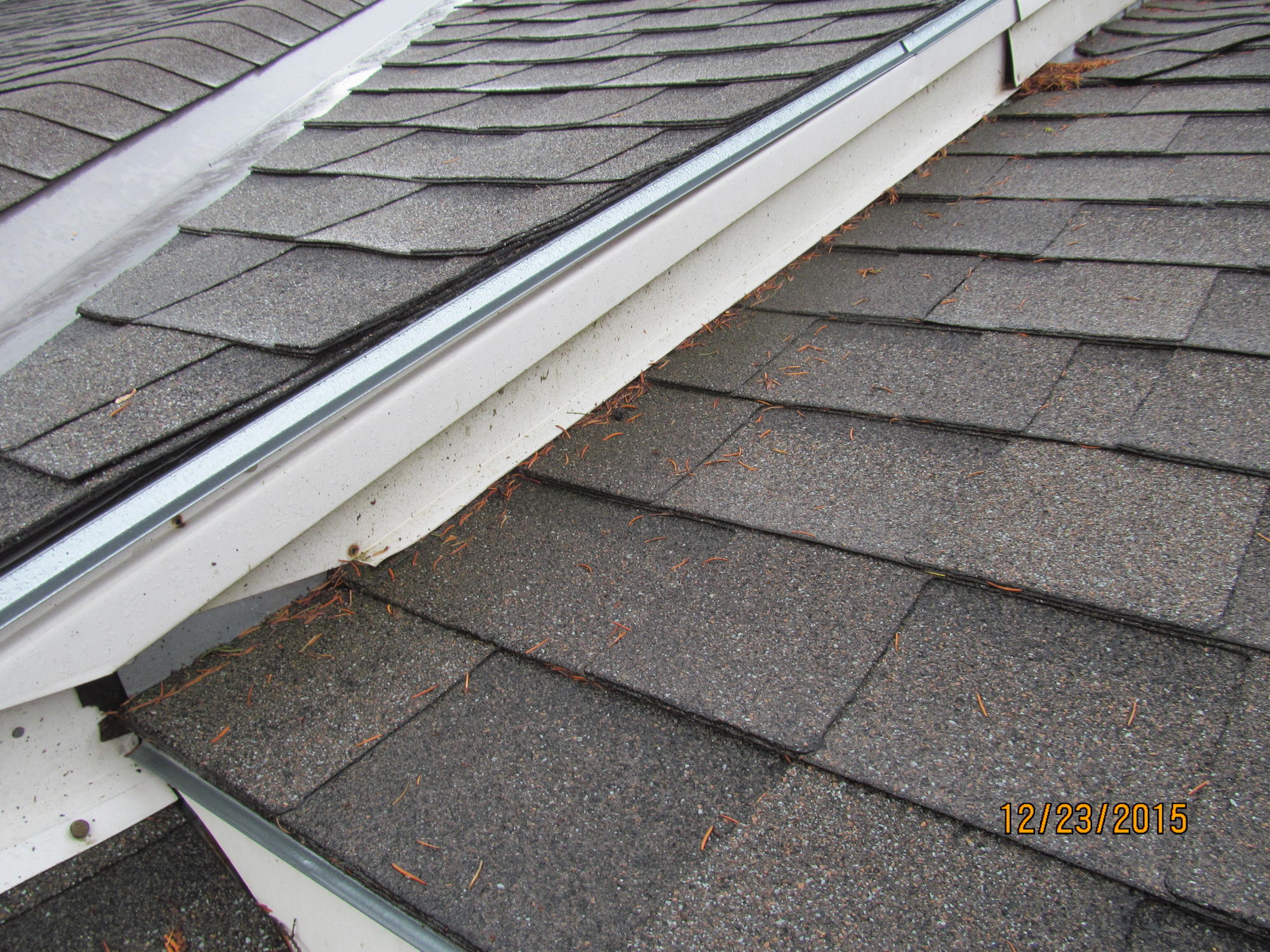

Good example of various roof edges and flashings in this shot. A couple of problems noted on this roof in regard to loose Fascia and shingles not extending onto the valley flashings far enough. The roof covering was less than two years old and the shingles and flashings were in good condition as such.

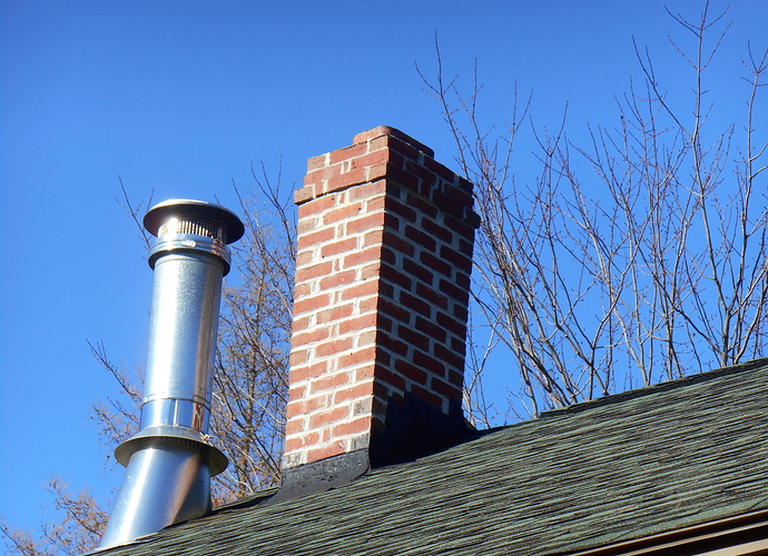

I have attempted to attach a picture of a masonary chimney as well as a metal-bestos chimney. (Doesn’t appear it worked by I’ll keep going)
The picture shows step flashing as well as apron flashing on the masonry chimney. The flashing appears to be in good condition however it has been covered with a roofing mastic. This may have been due to a leaking issue ir simply the contractors method of installing flashing. This was noted in my inspection. This home had a cathederal ceiling and had no attic. There were no signs of leaking around the chimney in the interior of the home

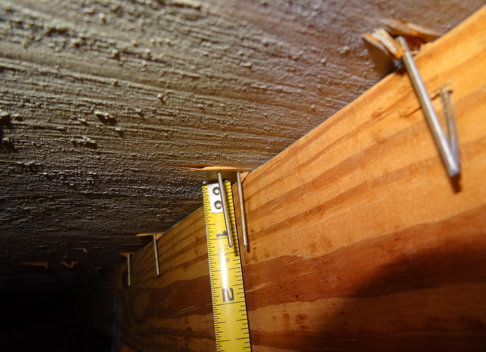

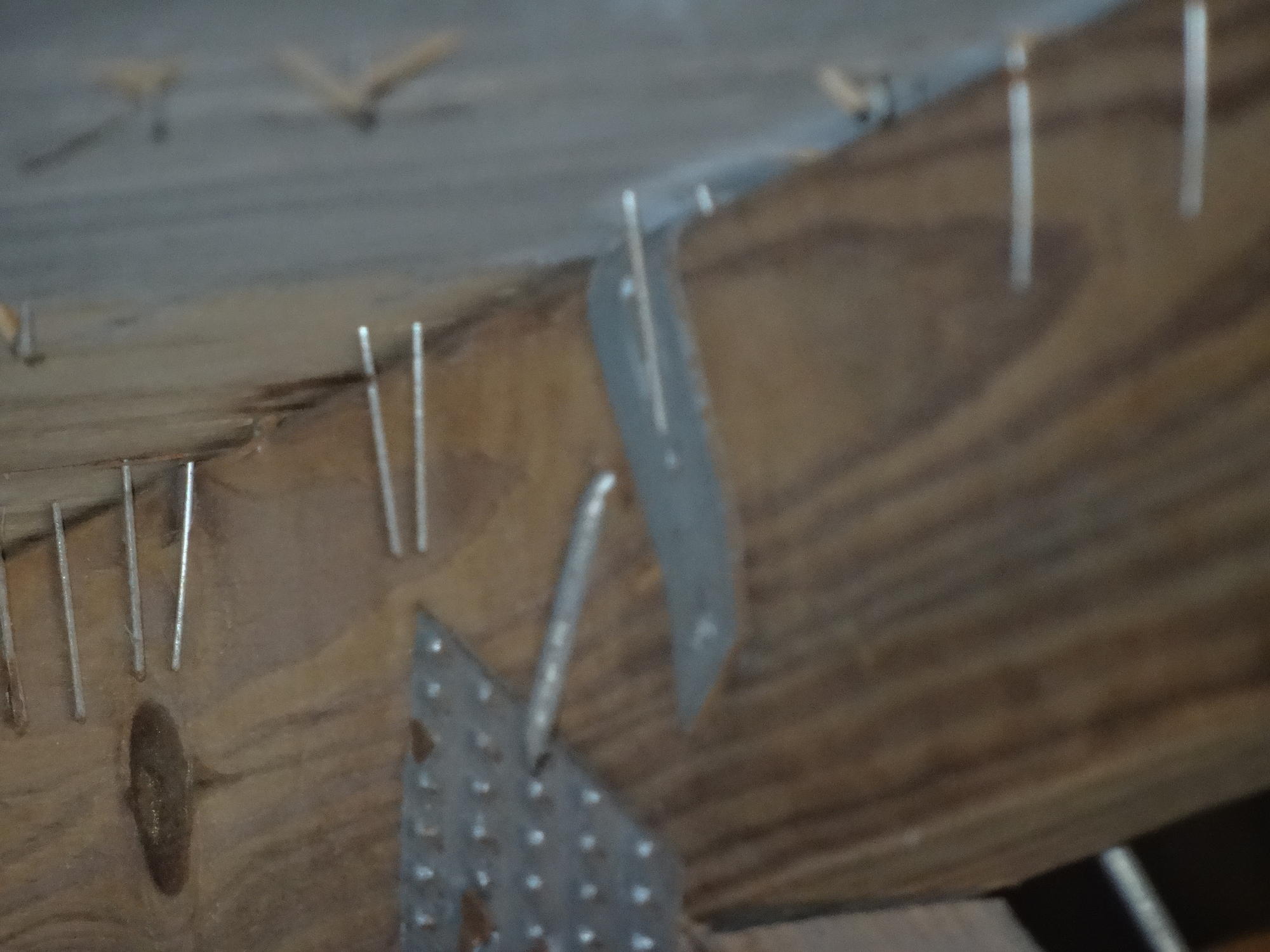

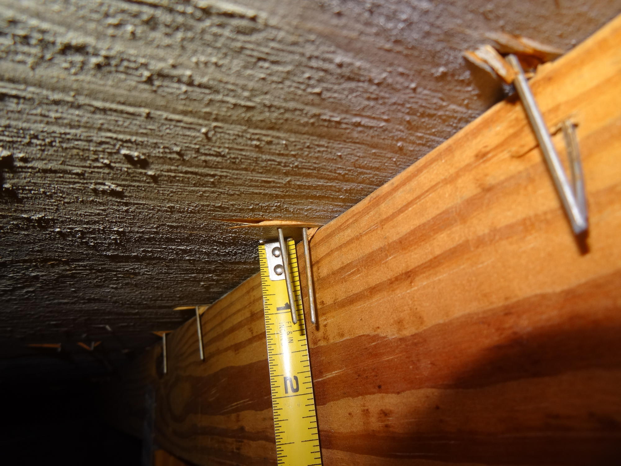

Sheathing attached with staples. The installation was prior to the adoption of the building codes. Based on the picture the sheathing is inadequately fastened. Unfortunately, this pattern existed in several locations, with areas that were uplifted.

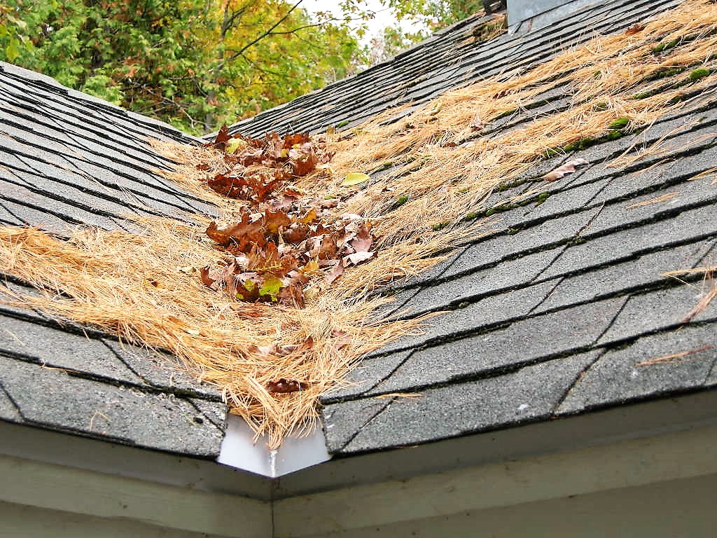

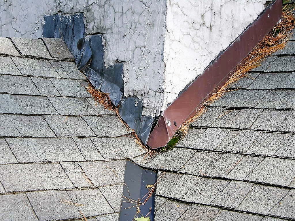

The roof has much debris and can’t see some details.
The debris needs to be removed, it can shorten the life of the roof. The flashing at the chimney has deteriorated and needs to be replaced. It can allow water to penetrate the roof.
