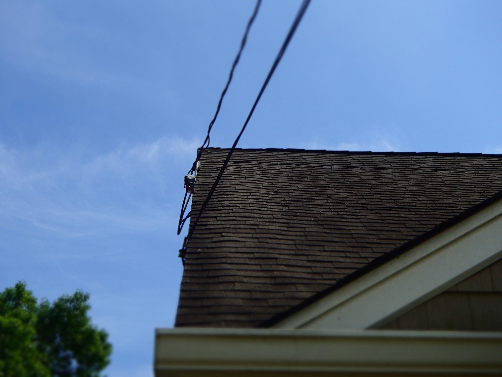

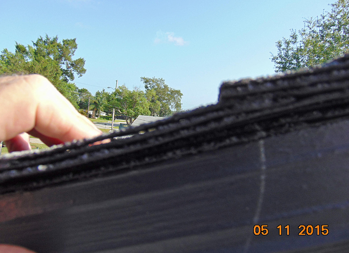

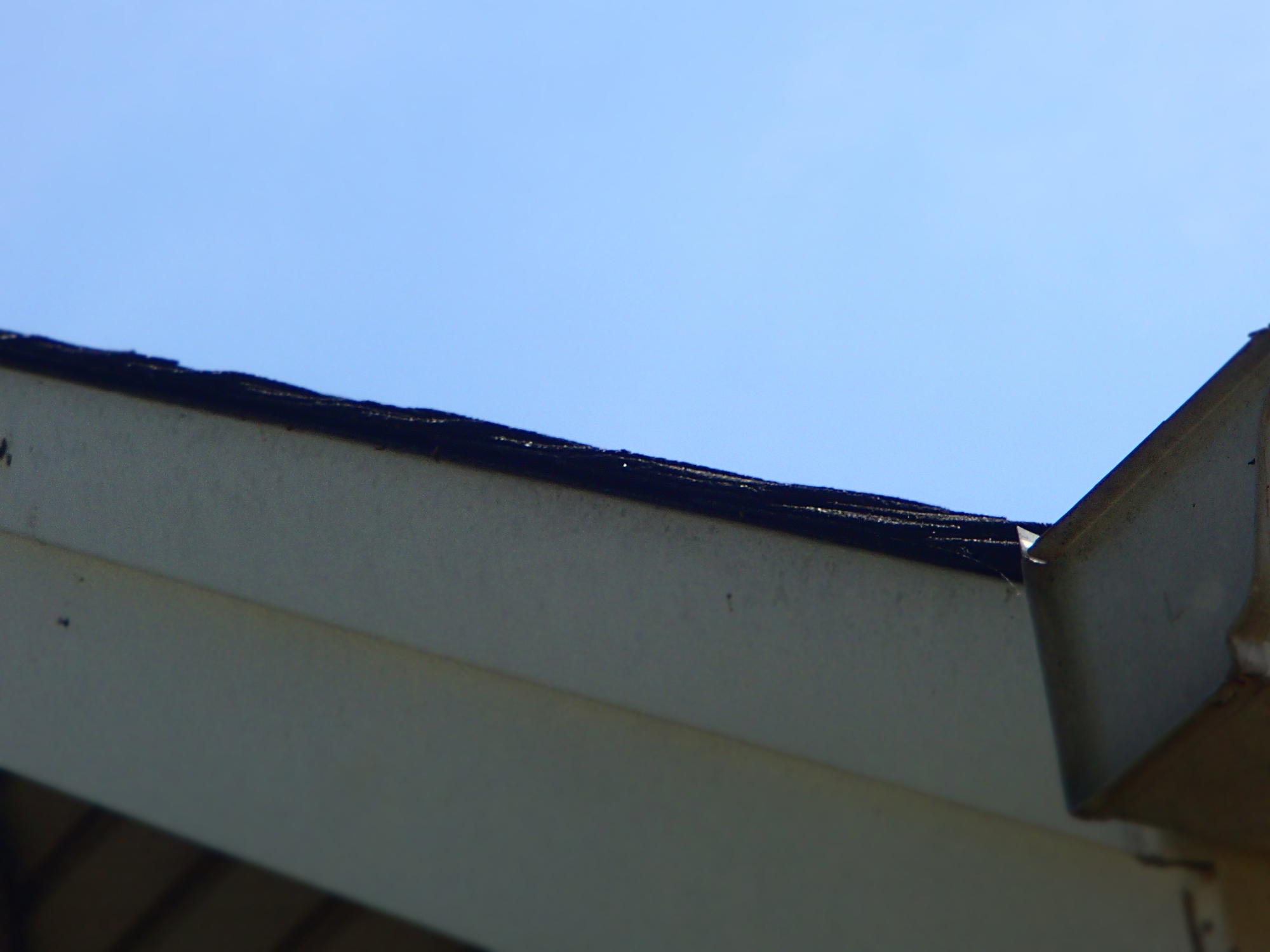

Examining the rake of this home shows there are at least 2 layers of shingles. I was not able to walk the roof, but did notice there was a strange bubble look to the shingles, going down the left side of the front roof. Clearly there is an attachment problem with the shingles in this area. It is likely that the roofing nails are not long enough to penetrate through the additional layers of shingles. I would recommend hiring a qualified roofer to inspect this roof.

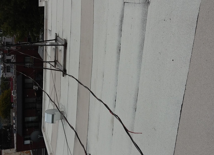

this is what we call a flat roof. Actually, its got some minor slope to it so the water can drain when the snow melts or when it raines. Also, we can see the wires from the power company. I beleive the building code requires that the power wires should be no lower than 1 meter over the roof.

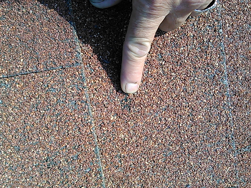

Here is an inspection of a roof that I did. The shingles are prematurely cracking across the roof. I recommended having a licensed roofer come out and further evaluate and repair / replace as needed.

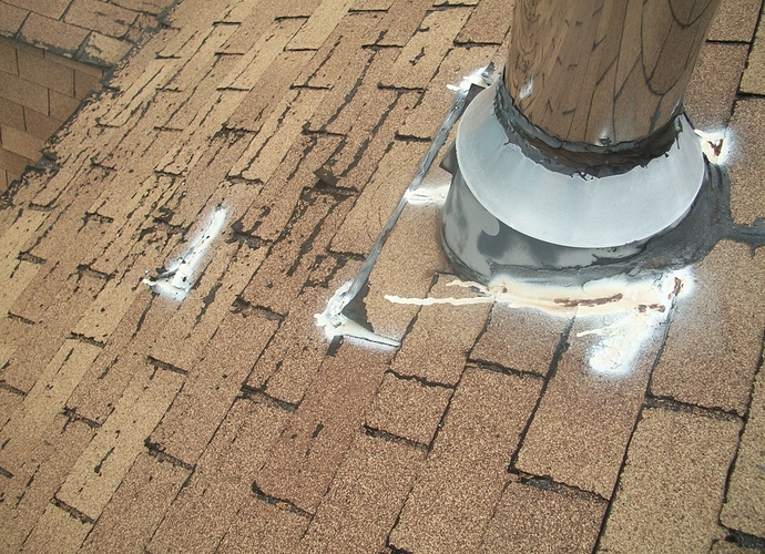

visual inspection of the asphalt shingle roof near the chimney shows signs of aging. in the photo there are white spots of apparent sealant as evidence of attempts to repair some leakage. also there is some sort of black caulking on the chimney at the flashing; this caulking is cracked an peeling and as such may be allowing moisture to migrate past the flashing and into the attic space.
upon looking at the 3-tab shingles there are various sized gaps between the tabs which indicates age. when 3-tab shingles are installed all of the gaps should be uniform. the older the shingles get, they degrade from exposure to the sun’s UV and the weather. as they degrade by corners curling up and also the granules come away from the shingle base making the under layer of the shingle visible as noted by the dark stripes in the shingles, also the gaps in the shingles widen.

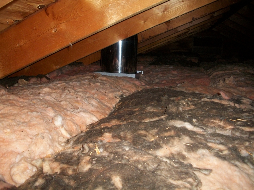

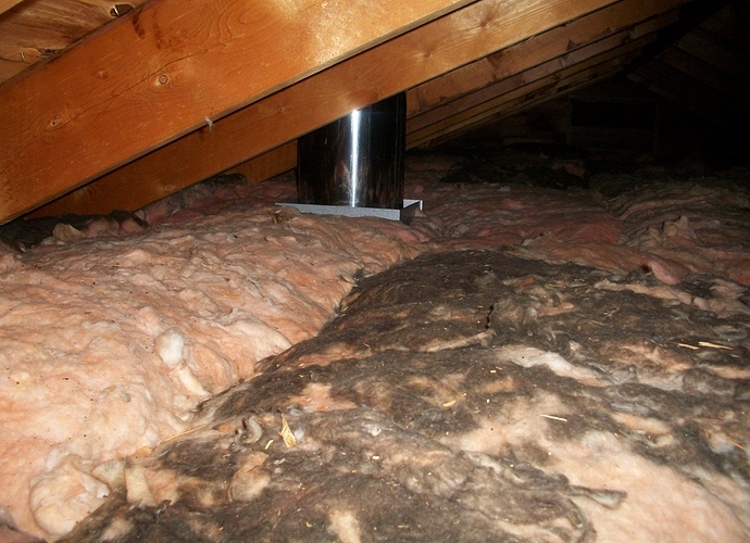

the second photo was taken from inside the attic and shows discoloured fibreglass insulation. indoor air escaping into the attic through gaps bring warm air, moisture, dust, etc into the attic space and discolour the insulation.
also in the attic pic, visible evidence of moisture intrusion by way of the roof is shown on the sheathing. staining is on the roof sheathing in several spots along the rafters.

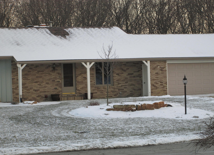

Here is an example of a snow covered roof that I will not be able to “Walk”. Using a ladder along the gutters and also positioned along the Rake is about all I can safely do for a roof inspection. Binoculars are a handy tool to see the farther parts that and not snow covered. I will have some pictures with the report. This is a Gable roof, so counting the roof layers at the Rake will determine the layers. Safety First when it snows.

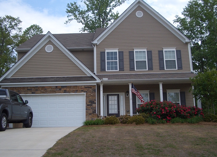

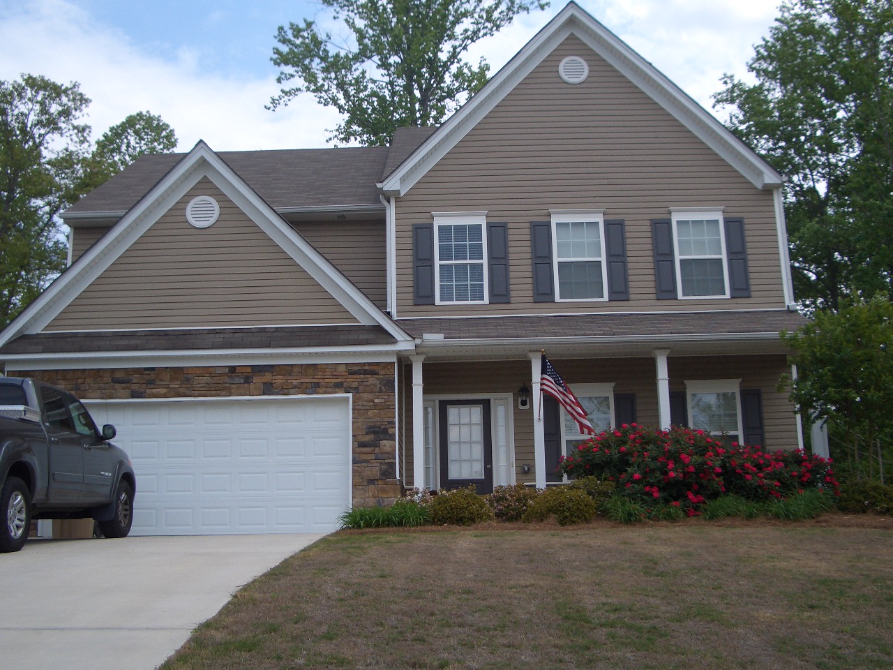

This is a picture of a multi-gabled roof with dormers. The slope of the roof is built on a 9:12. This shows the complications with walking a roof surface if the pitch is too steep.
