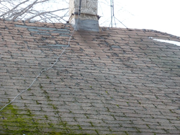

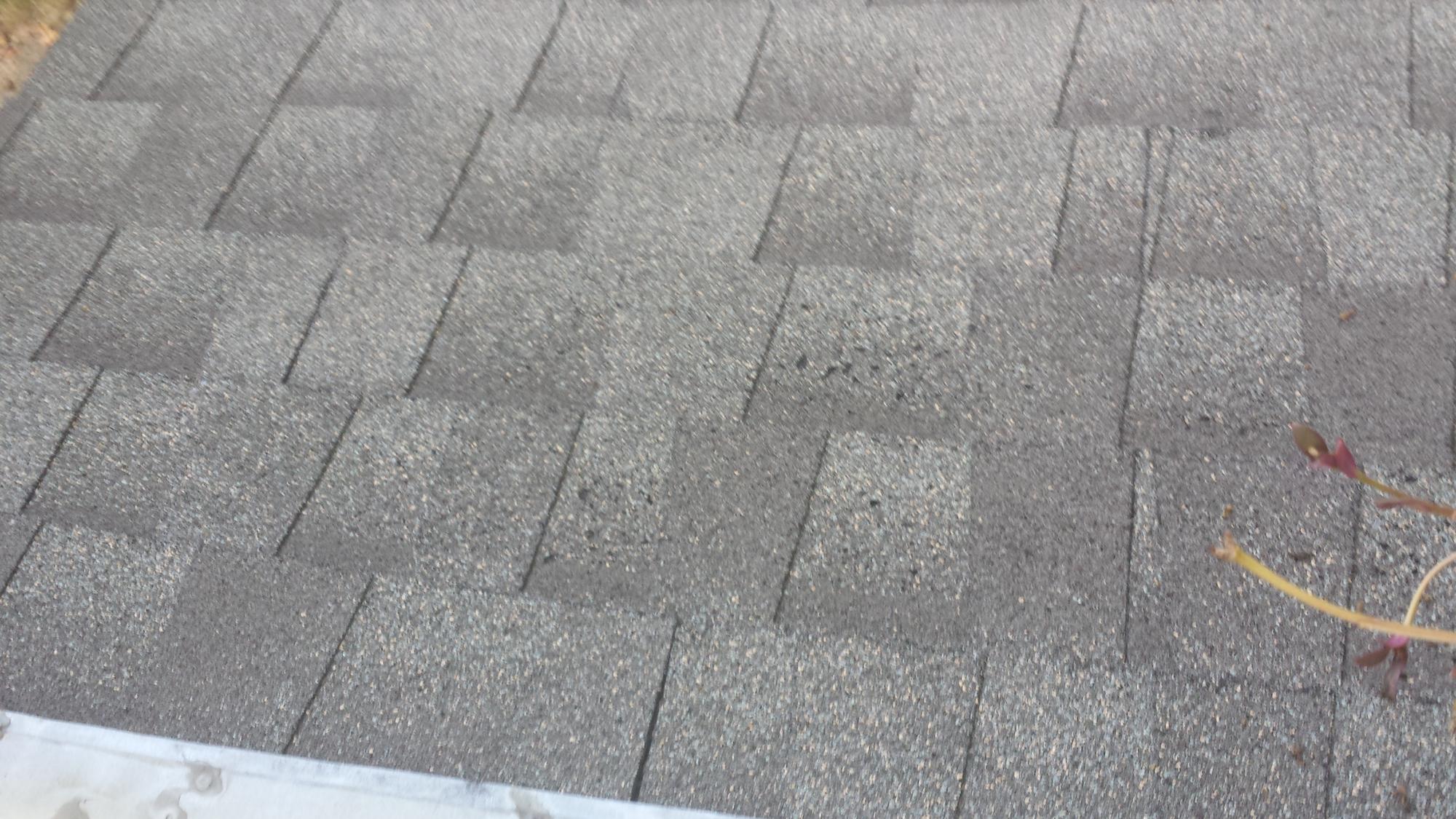

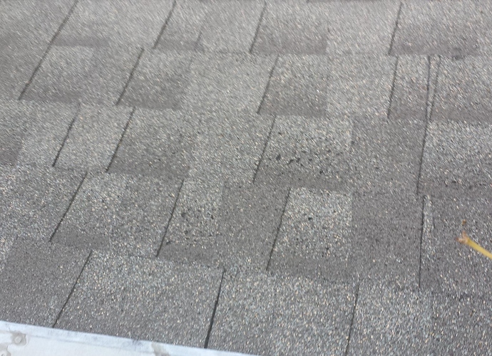

The asphalt shingles are designed to be water resistant, not water proof. The shingles in the images are observed to be beyond their serviceable life expectancy. Damaged and or missing shingles will allow water to penetrate the roof structure causing roof sheathing to rot. Moisture entering the attic space could lead to mould. Consult a qualified roofing contractor to make necessary repairs.
Moss growth on the shingles is an indication that the roof stays wet. Moss left on shingles will accelerate decay of the shingles resulting in premature replacement. The large tree the overhangs the roof needs to be trimmed or removed completely. The tree is preventing the the sun from reaching the roof causing the shingles to remain wet for an extended period of time.

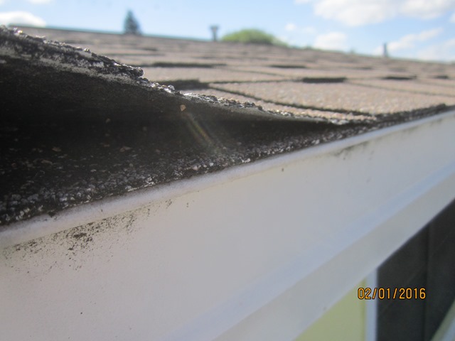

The flashing on this roof was improperly installed and could allow water to penetrate the roof and cause damage. I would recommend contacting a professional roofing company to further evaluate the area.

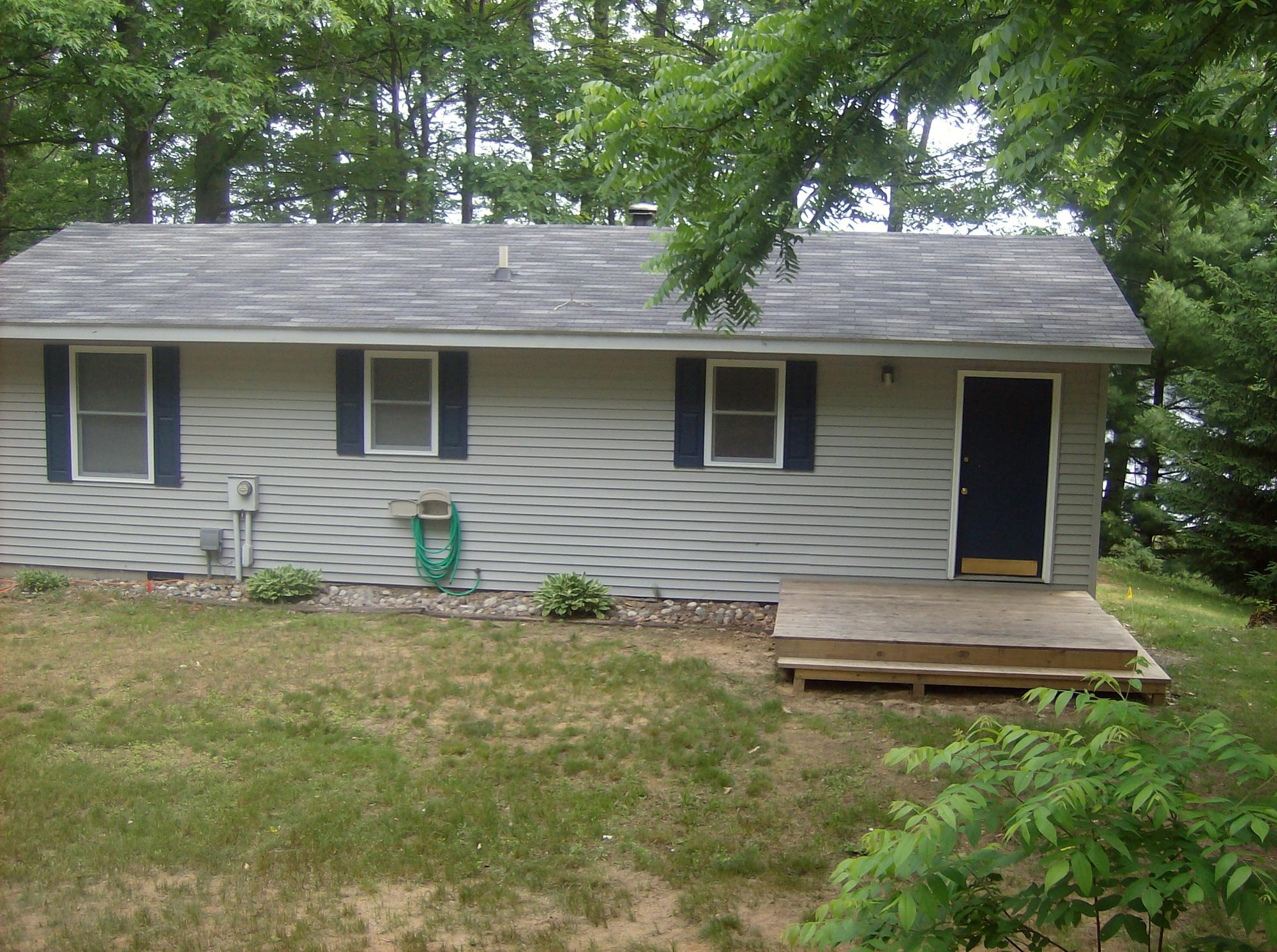

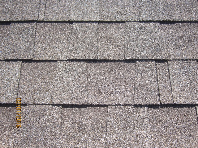

I read Mastering Roof Inspections Asphalt Composition Shingles PT 1 & 2 and Mastering Roof Inspections Underlayment PT 1 & 2. The roof shingles are a fiberglass composition shingle and are starting to lose the granules that help protect from the elements. In the photos you can see where the underlayment is not showing and there are also another set of shingles underneath the existing shingles. Under theses conditions I would inform the client that there is a second row of shingles and that they would have to install a new roof the next time it is to be re-shingled and would recommend they have a licensed roofing contractor to come and take a look for any estimates.

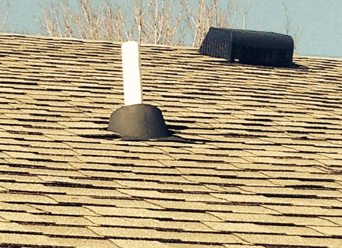

Inspection of roof dimensional shingles. Photo is of one plumbing vent and one turtle back vent. Homeowner stated roof shingles were installed 2 years ago. The roof is in good condition. I always take pics of all penetrations and look for proper installation with proper overlap and fastening of vents and boots as any opening in the roof system could be a source of moisture intrusion.

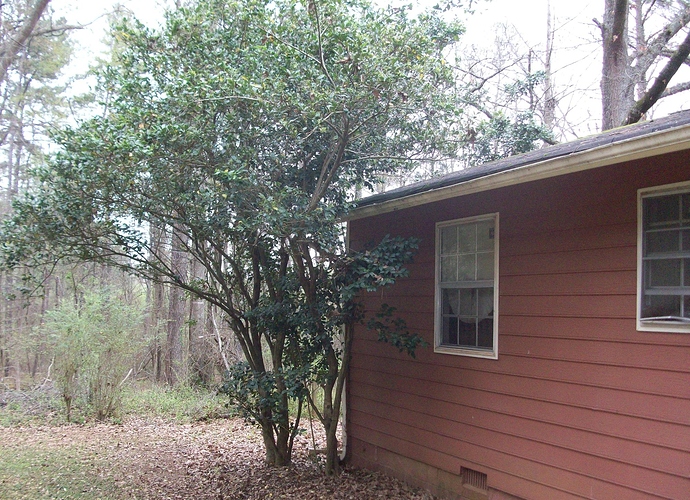

This particular home had a tree above the roof/gutters. This could be an arear where squirrels and other rodents have access to the roof. They can also chew and make their way into the attic, leading to all other sorts of issues. I recommend that the limbs be cut back from the roof. Not only that, the limbs could also damage shingles.
