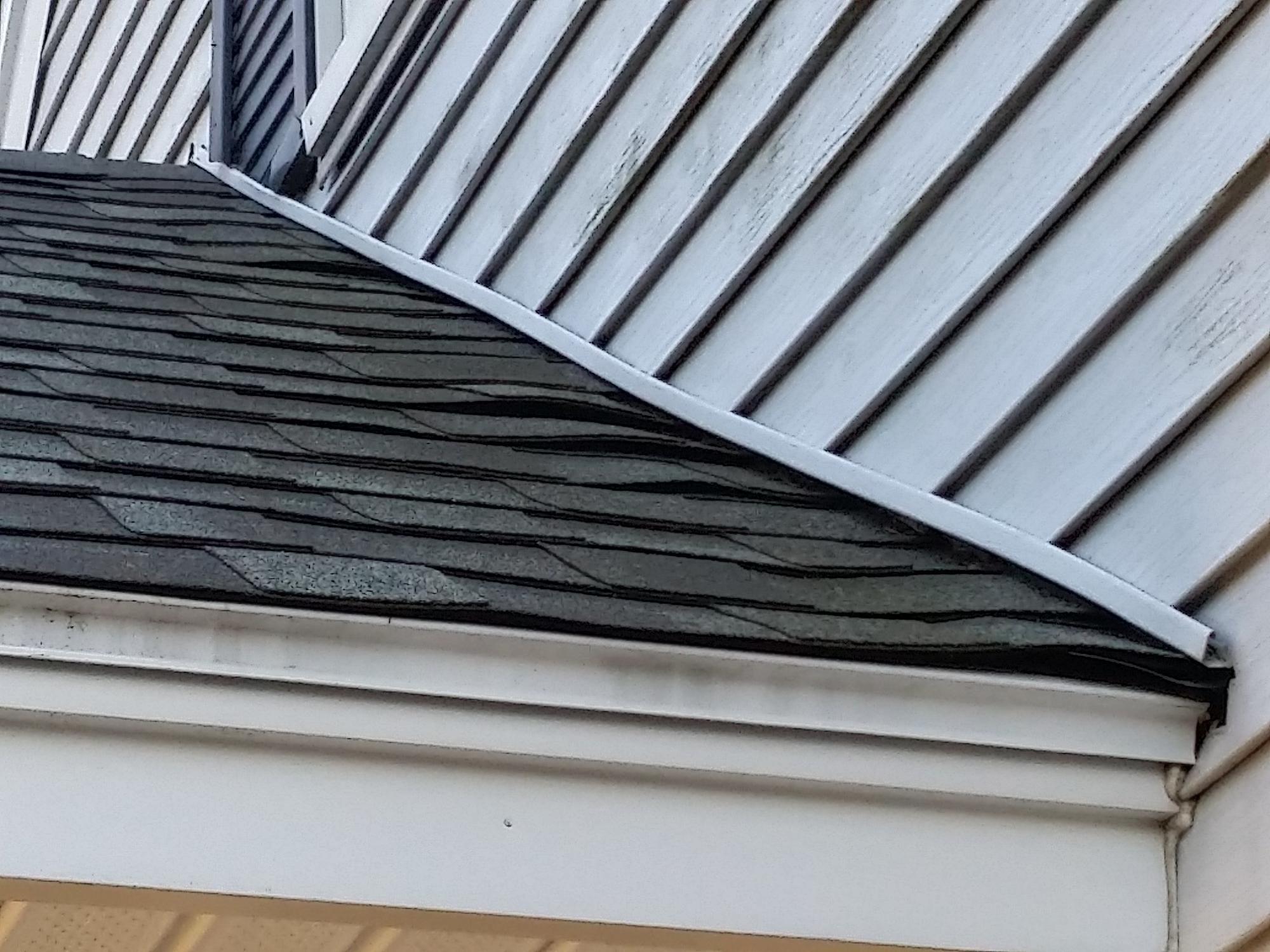

The roof covering shows a mump-like appearance indicating an installation defect. The shingles were installed too tight. These areas will eventually blister and the roof will need replacing.

Hay Stephen
Im not sure Florida is unique in terms of roof failures. In Florida, about one out of 5 (approx 20%) of roofs I’ve inspected have serious defects in terms of installation or compliance to manufacturers specifications. I think this is a sad commentary on, training, education, supervision, code inforcement, and ethics of some of the parties involved. The hump you observed on the subject roof inspection, maybe more directly related to differential settlement of the structure on the right and the structure on the left. You may find by further evaluation that these two stuctures were, the original structure on the right and an addition on the left. The addition may have settled, forcing the buckle to occur due to the flashing attachment to the original structure holding fast as the addition settled. I have seen similar conditions. Because Im only looking at a small image of the structure, you may find the truth in a broader context.

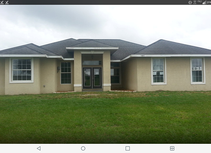

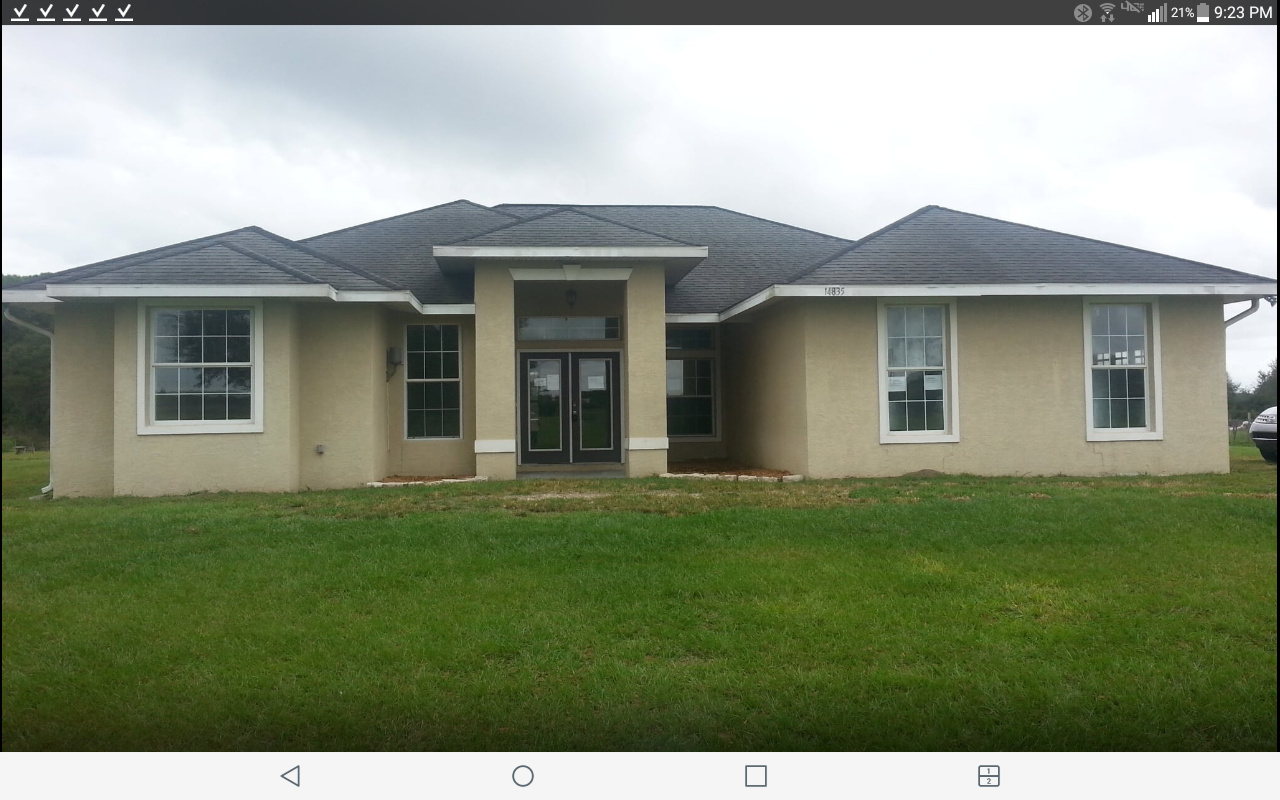

Roof and Attic
Front Elevation of Subject Property:
The roof covering is original to the structure. year built 2008
A permit search (see docs) indicates that the building permit and roof permit were issued to the homeowner.
Various areas of roof shingles were missing, damaged or improperly installed.
Refer to additional images in this report for more details.
This is a distressed/foreclosed property. It has been vacant for over 5 years.
Additionail defects relating to the integrity of the roof may be present.
Seek the services of a qualified and licensed contractor to further evaluate and repair as required.

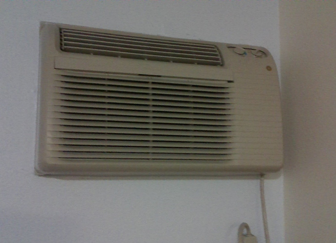

This is a wall built in air conditioning unit in a condominium. A the time of the inspection the unit was operable under normal temperature controls.

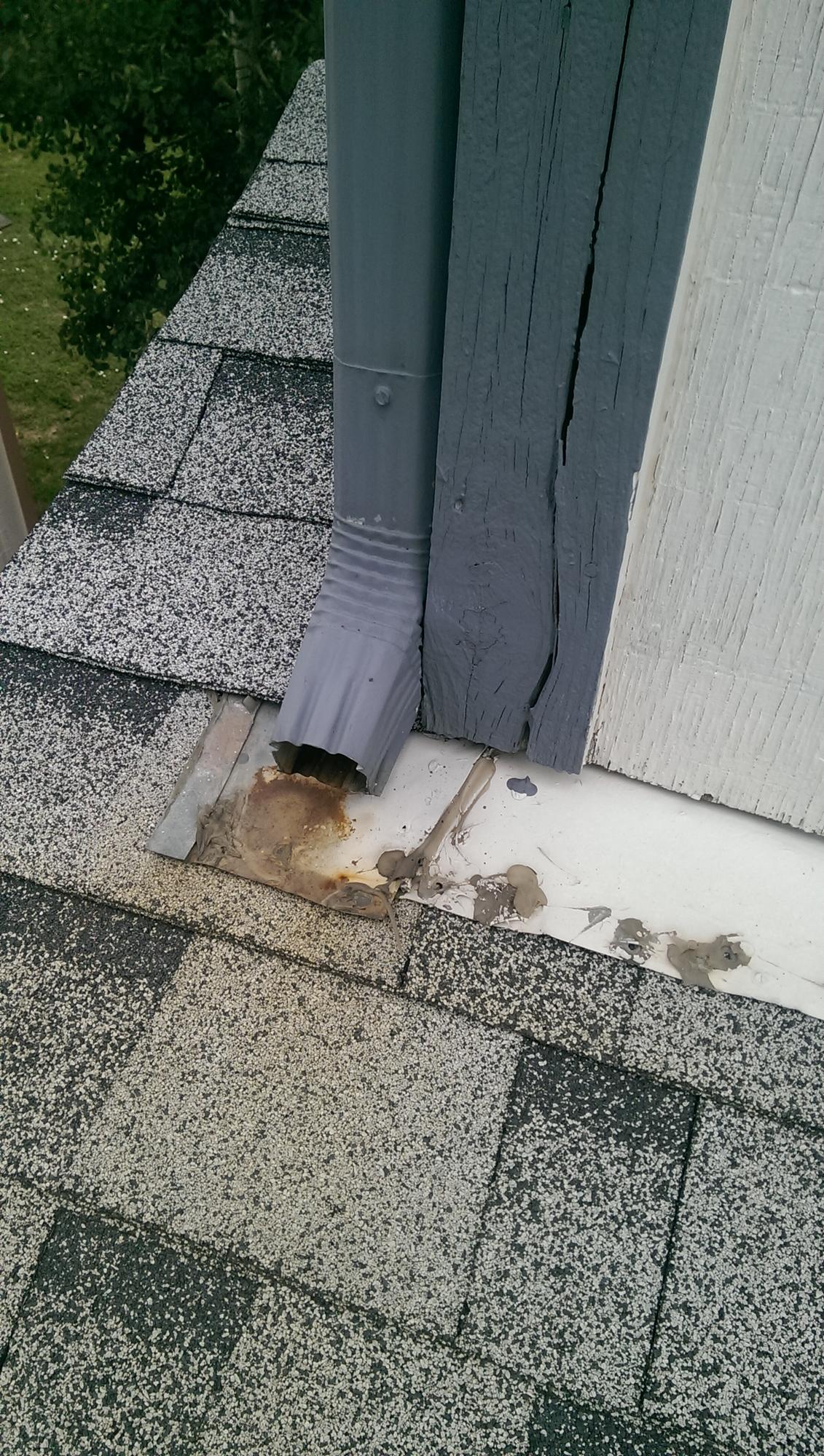

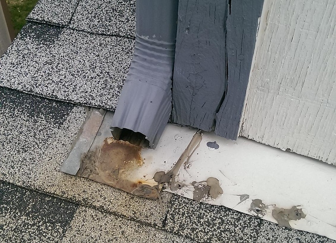

This picture shows a flashing nearing the end of its useful life. The flashing covers the area directly underneath the downspout of a two tiered roof that has became rusted and it starting wear through. Also the material used to cover the nail protrusions is failing and is allowing for potential water intrusion. The shingles directly below the flashing have became weather soaked and softer due to poor design. I would recommend review and repair by a qualified roofing contractor.
