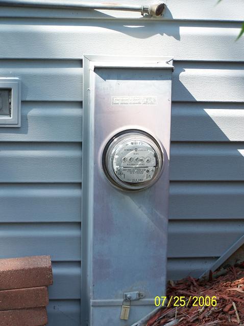

Do I report this as a 200 Amp service or 100?
Meter is rated CL200. Two 100amp breakers bonded.
Panel rating label obscured but it has 20 slots (100 amps, generally right?)
Home built around 1974.
100 amp
I agree. 100 amp. You must rate the service at the “weakest” link in the chain.
What I see is what appears to be one 220v 100amp main breaker. I also see one 220v ??amp breaker in that panel (electric range?).
Also looks to be a non-grounded system & one breaker not in use.
If the main breaker is 220v, 100amp, the meeter is 200amp and the main feed wires are large enough for 100amp service I would report it as 100amp.
Remember I can not see everything you can.
Two 100 amp 120v breakers tied together like that is still 100amps… you could have 3 100amp 120v breakers tied together and you still only have 100amps, you would have a different voltage rating though.
100amps +100amps = 100amps. (I’m sure someone can find an exception)
The bottom 220V breaker is a 40 amp for the AC. Nameplate on AC rates 30 amp max. Noted this in report.
First of all, you need to remember that a 200CL meter is NOT an indication of a 200 amp service. Most all meters these days are 200CL, even those used on a 100 amp service.
Also, Jason, why do you say it is not grounded? That is steel conduit feeding this panel. The ground could very well be carried through the conduit. Although a bonding bushing should have been used.
ALL 120/240v residential services are grounded. Let’s get that straight.
Some older services may not have a ground rod or a water pipe ground, but they ALL have the neutral bonded to ground somewhere. Even if it is a far back as the utility.
Simply not having a ground rod does not mean “ungrounded”. A ground rod DOES NOT provide a ground.
From the photo, I am unable to see that all of the wires entering the pannel box are in conduit or just wire clamps.
Even if this was on an older home that does not have a ground wire, it should have a ground installed to a ground rod or a cold water pipe or both. It appears to be a newer breaker box. That would meen that it would have been an updated system and would not have been an exceptable instalation if a permit was pulled and it was inspected.

Nobody commented on the top left breaker.
What about the lack of “grounds” (EGC’s) in the panel?
