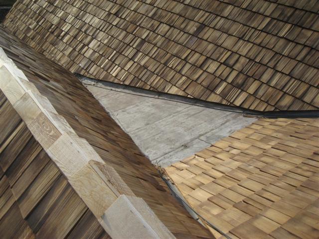

This roof is coming up on its first winter. Any comments about how these areas were handled?

Looks like they’ve made some excellent funnels to shove water under some of the shakes.
My client says the roofer told them that the staples for attaching shingles over the membrane in the areas without shingles would cause leaks in the membrane. He told them this is an acceptable practice. There are also some flashing issues which should be corrected.
Another roofer tells my client that that the whole roof needs to be replaced saying it won’t last the snowy winter.
First pic is real questionable. Not sure about the others. Just not enough detail for me to tell.

In the first picture why would the flashing go under the membrane???..warning…Danger Will Robinson…
Are you saying I wasn’t seeing things???:smiley:
Good catch
You should win some sort of prize.
that’s the way it looks to Me frank…bass akwards is my guess…

Back to the exposed membrane on steep slopes without shakes. Is there an acceptable argument for not putting shakes on the areas with adequate slope? Is there a more acceptable procedure over the areas with less slope? See photos in original post.

“Back to the exposed membrane on steep slopes without shakes. Is there an acceptable argument for not putting shakes on the areas with adequate slope? Is there a more acceptable procedure over the areas with less slope? See photos in original post.” The membrane was used to open up some areas that shakes would have interferred with the water flow. The lowest points of those areas don’t appear to be open enough. Personally, I would have preferred 20 oz. copper, or lead coated copper, flat-locked and sweated together. Not totally familiar with SBS and APP membranes, but only consider them to have a 10 year life. Shakes are ‘supposed’ to last 40 years. Doesn’t make sense.

The other roofer is correct. At least some of that work needs to be redone. It is no disgrace to do rework, well not much, and better than the consequences. In my youth, we would have used painted metal valley flashing and laid the shakes over, keeping the nails high, as long as there was over 4:12 slope.
If there are areas with lower slope, maybe torch-on membrane. But that is a design screwup, such as where the dormers meet. Chimney in the valley, etc. The architect should take some of the blame, IMO. Too late now, but he or she should be chastised. :mrgreen:
