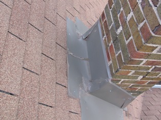

Does anyone see anything wrong with this chimney flashing? The roofer didn’t seem to…

Still not a good picture. But it appears that the flashing is on top of the shingles instead of the other way around. The upper shingles should overlap the flashing.

Not to difficult to figure flashing should be below tile upsteam.
Lack of step flashing is more common than not, as step flashing takes work.

Man I have bent many chimney flashing ,and I also use counter flashing.
Takes 20 minutes on a job like that.
This should have been started from the bottom ‘‘lowest part of the chimney and then 2 sides and end full strip on top.’’
It is sealed or bonded with a wrist lock bend. Very simple.
I have not seen 1 roofer doing shingles roofs, able to do a wrist lock for over 20 years.
The tin work is the weakest link in the chain on roofs.
As for step flashing, its the best but takes time and you have to cut into the brick masonry and roofers are roofers and tinsmiths usually apply wrap or step flashing.
With a gum edge on the wrap flashing to hold a liberal amount of good caulking its is the best’’ fast method’’ for flashing and I have seen it last over 15 years.
Its a dying art . Step flashing and tin-smiths in general.

Remember we want to educate on this thread. So what should have been done first?
  1. Head flashing needs to be under the shingles.
    2 Cut a slot into the brick ready for the counter flashing.

Would not it have been a good idea to install a cricket due to the potential to collect debris and snow.
With the humor of my previous post aside (the photo is real - about 4 years ago), my practice when encountering these issues is just as has been used in this post by previous members, 1) photo the issue, 2) report the defect & 3) give the client a photo from the NACHI library or Code library of how it should be, and 4) Recommend repair by a professional. I try to not only point out what is wrong, but give the client clear direction when standards are so easily available.
