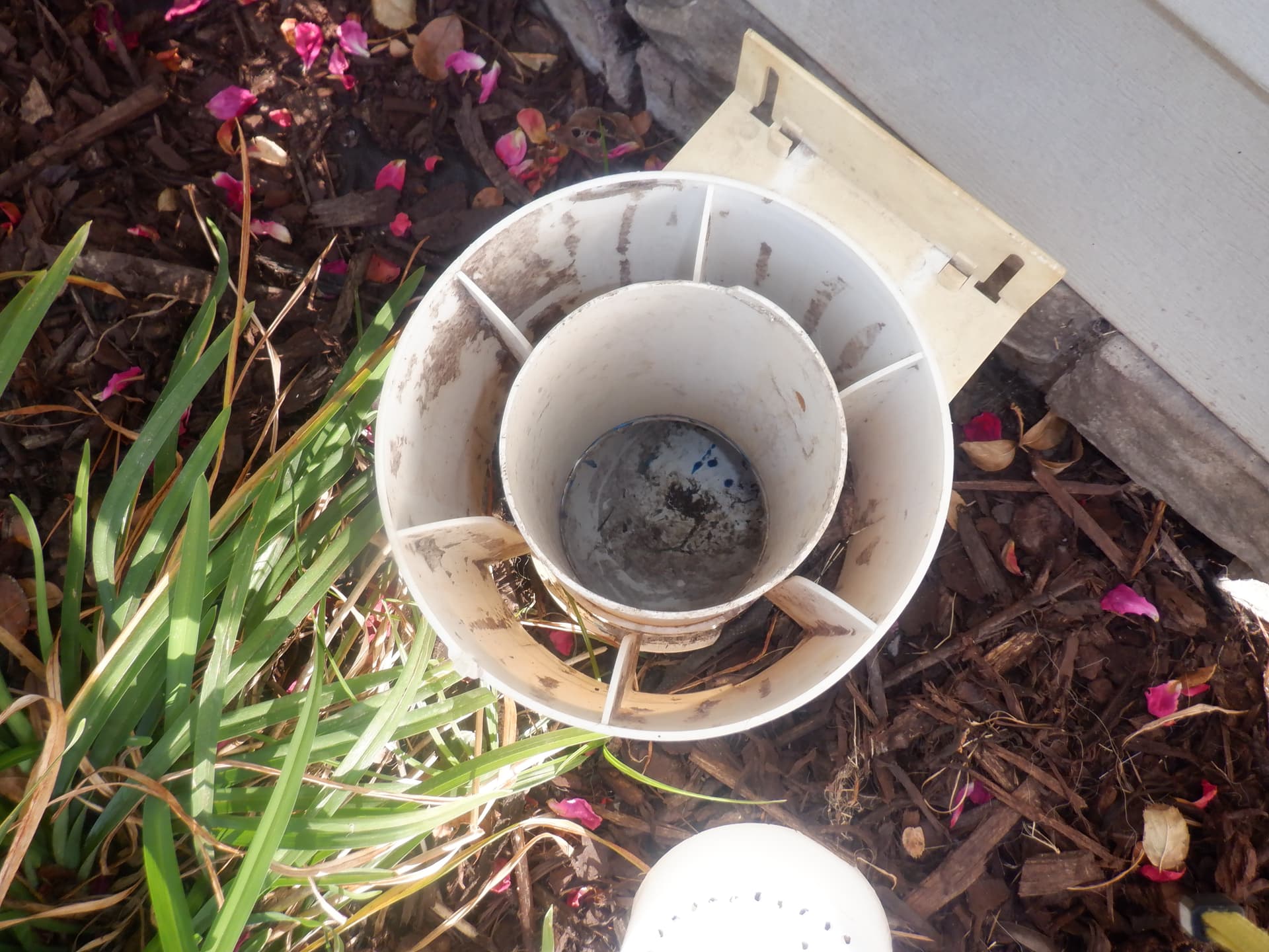

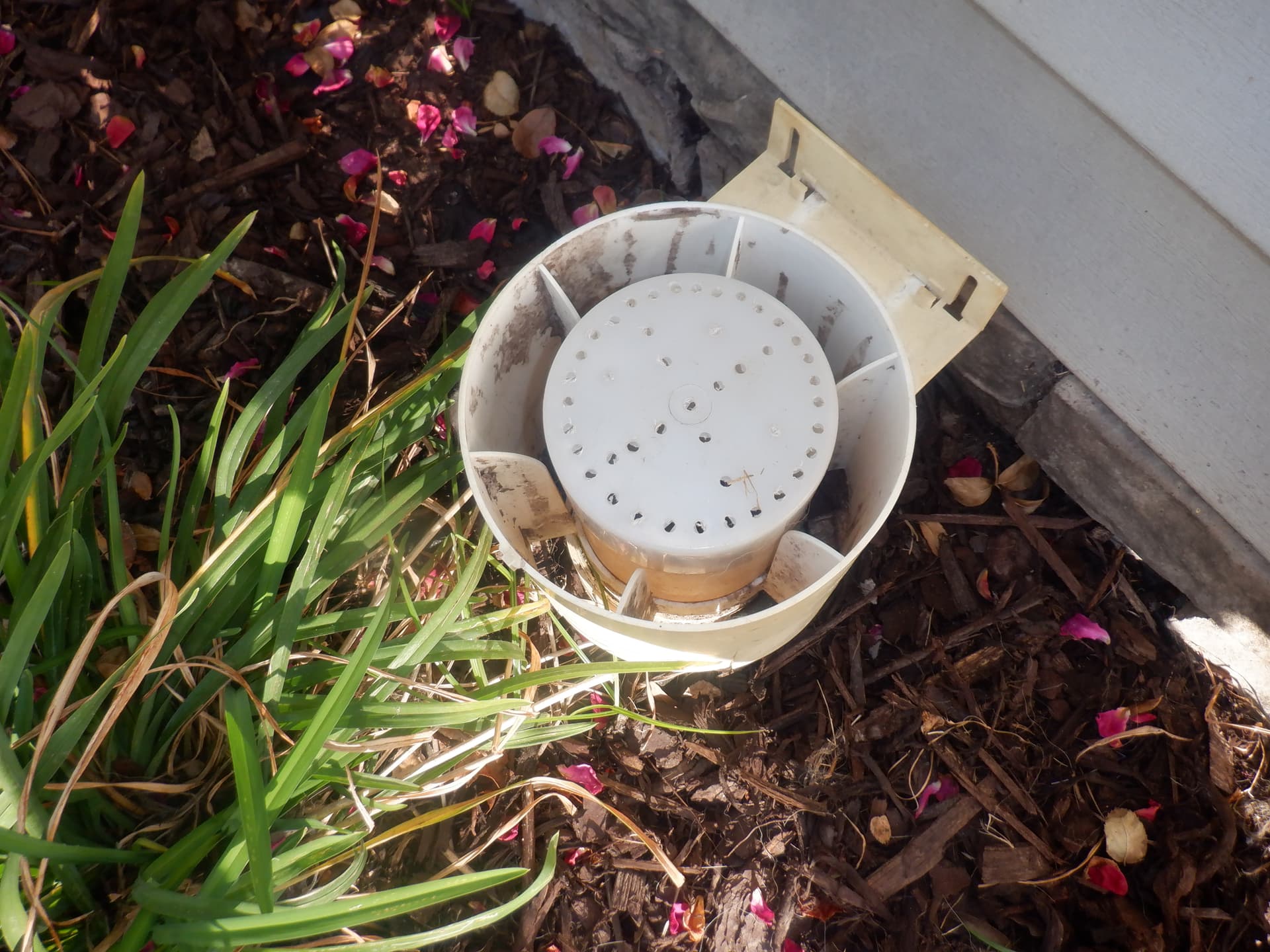

Saw this during an inspection today. 1,440 sq ft, built in 2010 on a slab, connected to a sewer. There is a sewer cleanout on the front of the house, but on the back of house I saw the pipe pictured on the back.
Tha lid came off and there was a plastic screen/vent. One the screen/vent was removed it revealed, what appeared to be, a 4-inch pipe that when back under the foundation. I’ve never seen anything like this before. Any ideas what it might be?
My first WAG would be radon mitigation. :thinking:
Hey Dave, that thought crossed my mind, but there wasn’t a fan of any type observed, and there was no air coming out of the pipe. Also, I believe mitigation systems are supposed to terminate above the roofline.
My WAG is it’s a dryer vent.

I remember seeing dryer vents similar on inspections about 10 years ago.
A dryer vent would make sense as I didn’t spot the normal, louvered vent that’s so common down here. Interesting. Thanks guys.
Yes, it’s a dryer vent terminal.
