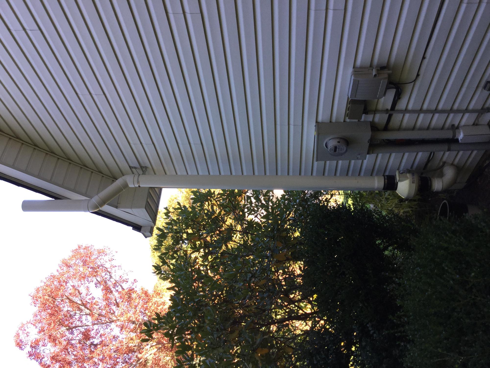

The images show an active radon system. The system had an inline fan installed at the exterior with a weather proofing cover. The radon mitigation pipe was connected to the sump pump system. The sump pump had a retrofitted cover with a clear plexiglass viewing port. No significant defects or damage were seen, though potential upgrades could be installed. The used of a galvanized downspout as the mitigation pipe can easily allow leaks. Additionally, the system has been installed in a region that has fairly harsh winters. It is recommended the mitigation pipe be sealed with duct mastic and insulated for optimal performance and to reduce the chance of damage.

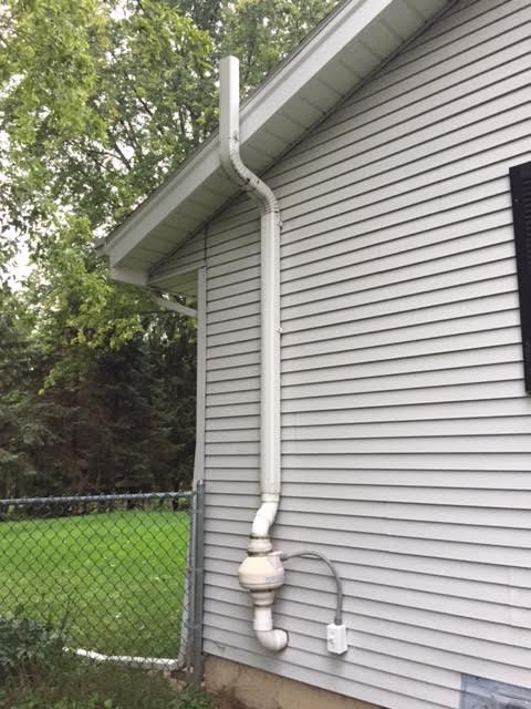

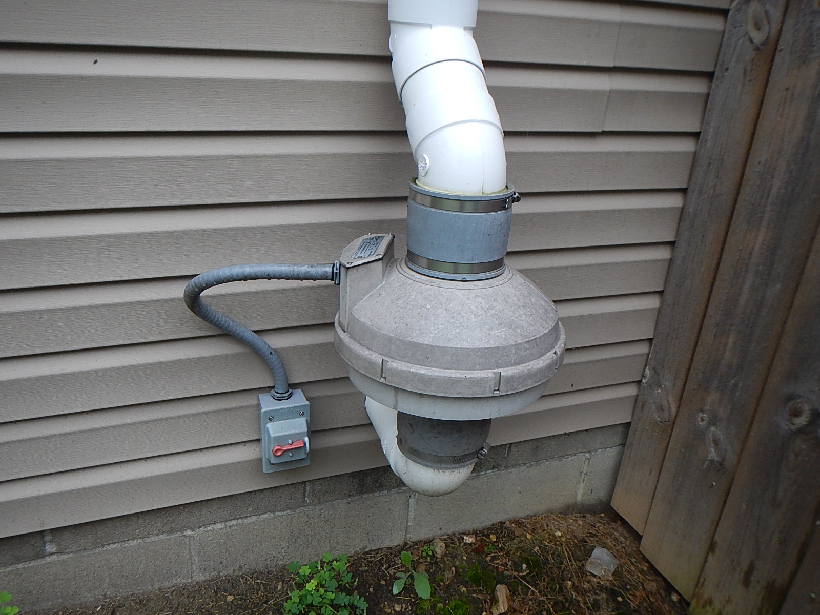

This is a picture of a retro fit Radon Mitigation Fan System. Notice there is a dedicated switch box powering the fan. The Radon Mitigation system appears to be installed correctly. In the installation of a Radon Vent Stack this probably should have went through the interior of the house and out of the roof to get the updraft or warm air effect. There are four visible bends in the vent from where the pipe comes out of the house to where it evacuates above the roof line. The concern with this picture is that the vent stack terminates about 10 feet or less from the window to the right. The system appears to be connected properly to the house and appears to be
in working condition.

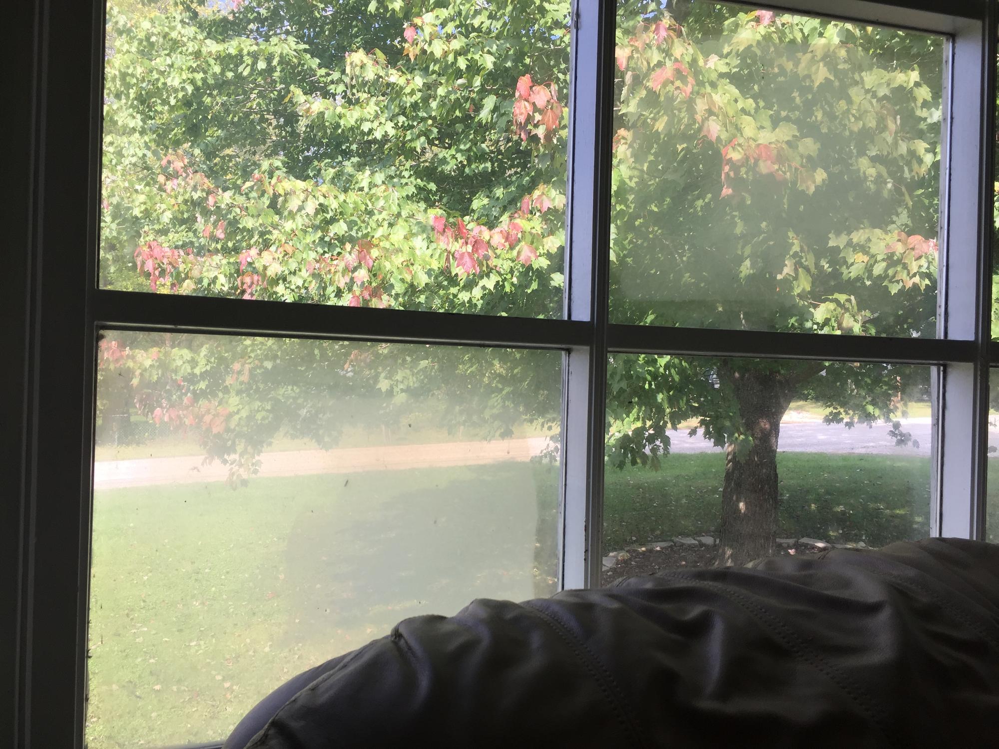

I do not have access to a radon mitigation system at this time, I have a photo of a picture window that have multiple seals compromised. I would report that these windows be replaced before further damage and/or water penetration can occur.

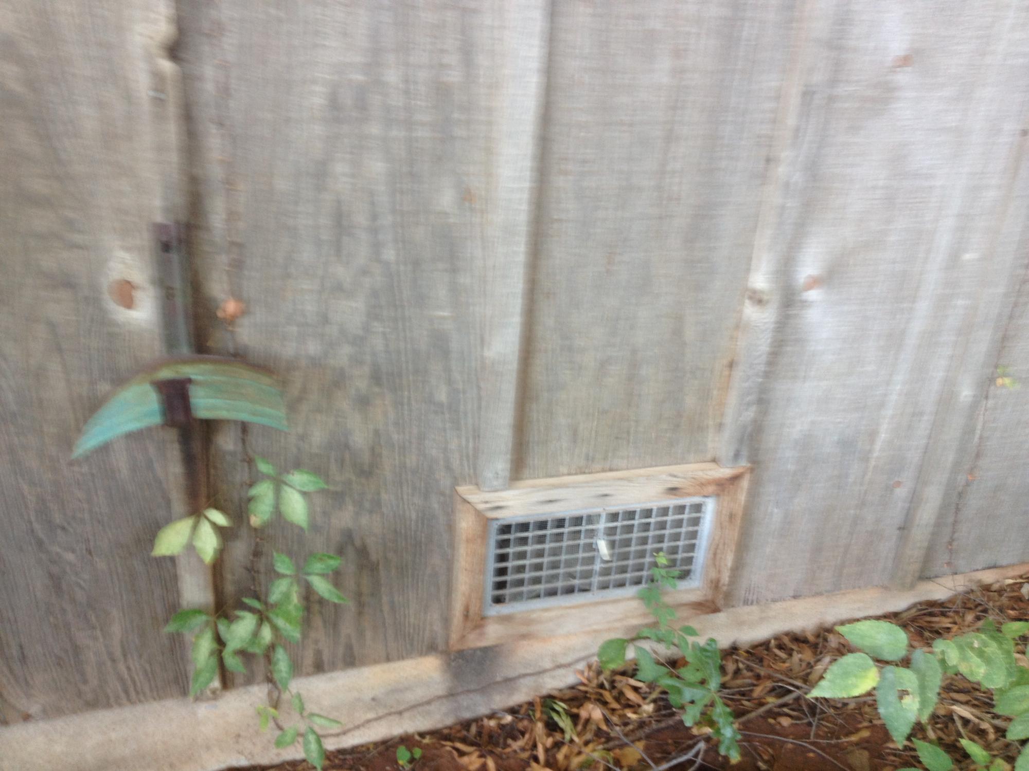

Foundation Stemwall Vent:
This house is located in Oklahoma which is EPA Zone 3 classification for radon.
This home is on a non-slab Stemwall with floor joists design. Even though it was built in the late 1960’s it has a vapor barrier covering the dirt under the house. These Stemwall vents help keep continuous air movement and if this home was in a Zone 1 area this type of construction would definitely require an air mitigation fan system installed just for circulating moisture out.

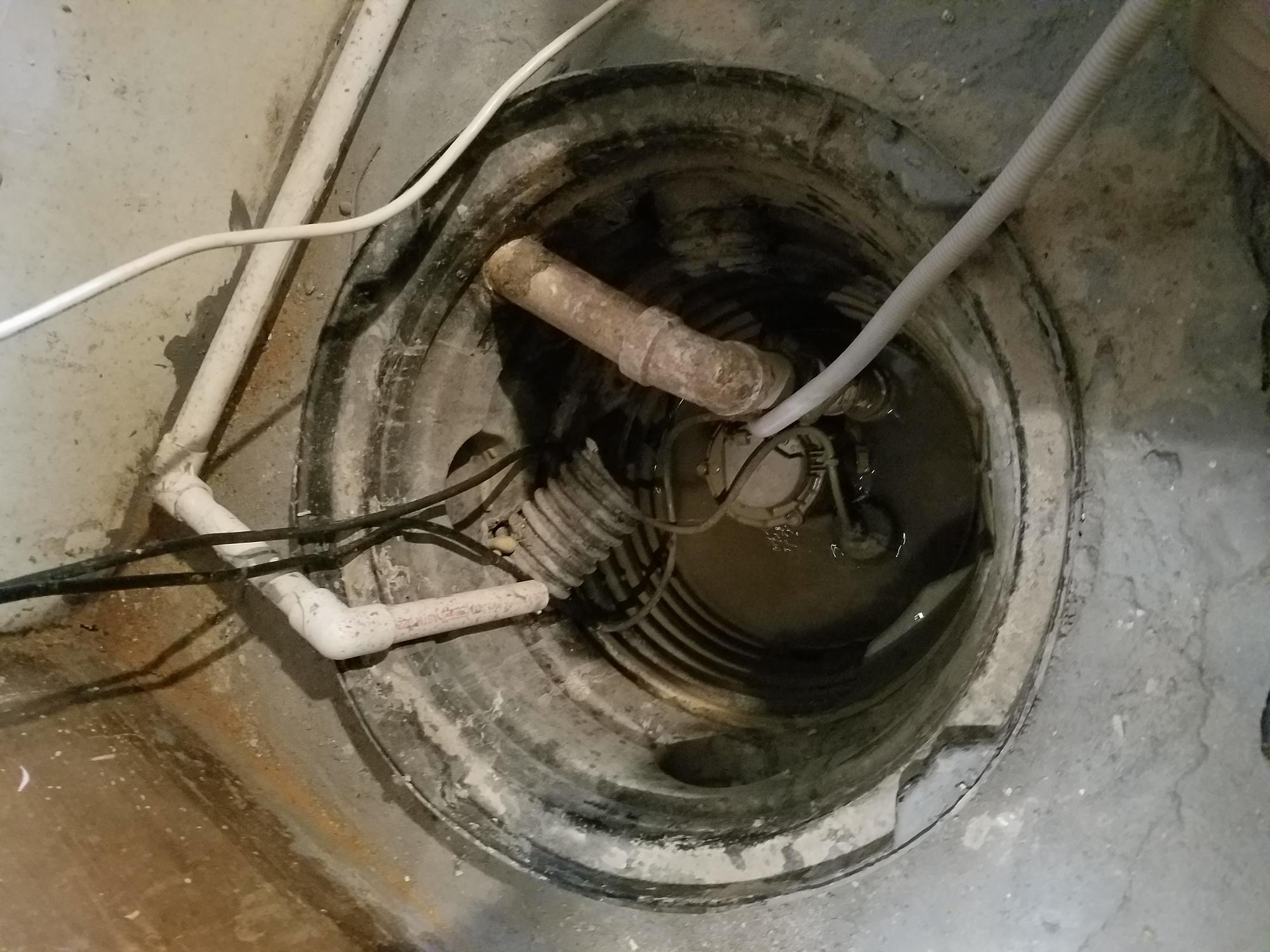

This home has a sump pit depressurization system. The vent pipe was constructed of schedule 40 pvc, all penetrations were well sealed, and all vent piping was secure. The system fan was operating at the time of the inspection. The manometer indicated that system was working as designed at the time of inspection.

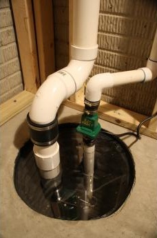

This picture denotes a uncovered sump-pump located in the basement of this home. Should this home test high or over 4 pCi/L a radon mitigation system would be recommended. If installed the sump lid should be completely sealed to reduce radon levels. Sealing the sump cover would help because of difference in pressure between outside and inside air create a vacuum and sump pump areas can be a likely area for radon to be drawn into the home.

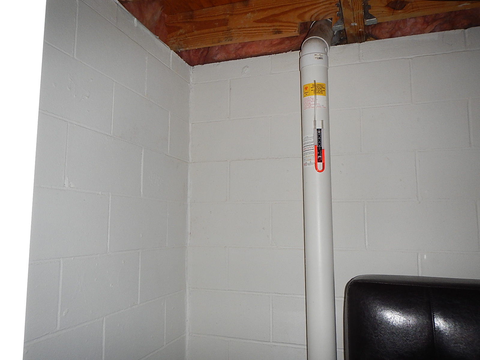

This radon mitigation system appears to be installed and functioning properly. It is an active system, drawing sub slab air from the sump pit and utilizes 3 inch PVC piping to allow the air to flow vertically to the roof. The system fan is installed properly in the attic. The sump cover was properly sealed and all required labeling was present.
