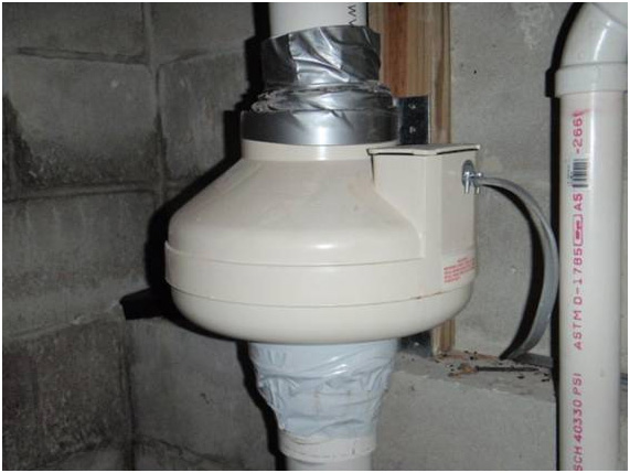

Visual inspection of radon mitigation system revealed damaged connections at the inlet and outlet of the inline radon fan, located in the basement. This is a safety hazard and a condition conducive to improper flow and leakage of radioactive contaminates. System should be evaluated and repaired by a radon mitigation specialist.

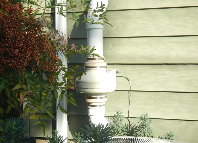

This radon mitigation system was externally mounted. A manometer was noted in the basement. The unit was properly installed, the sump pit was properly sealed and vented above the exterior eave.

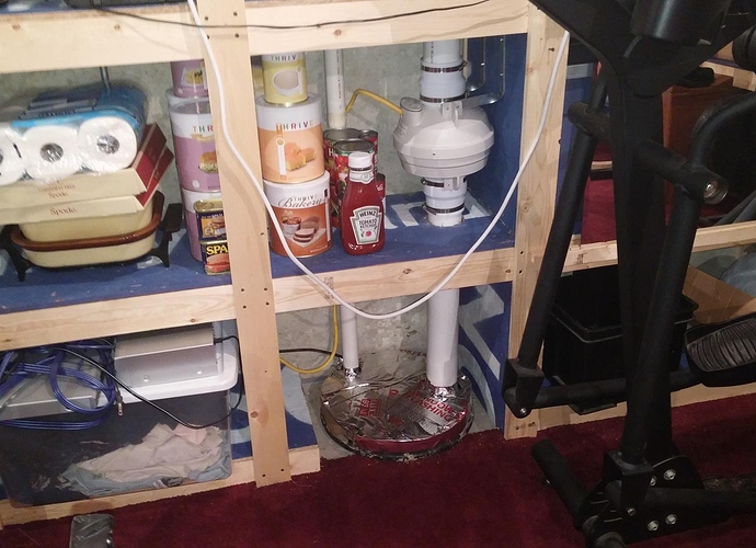

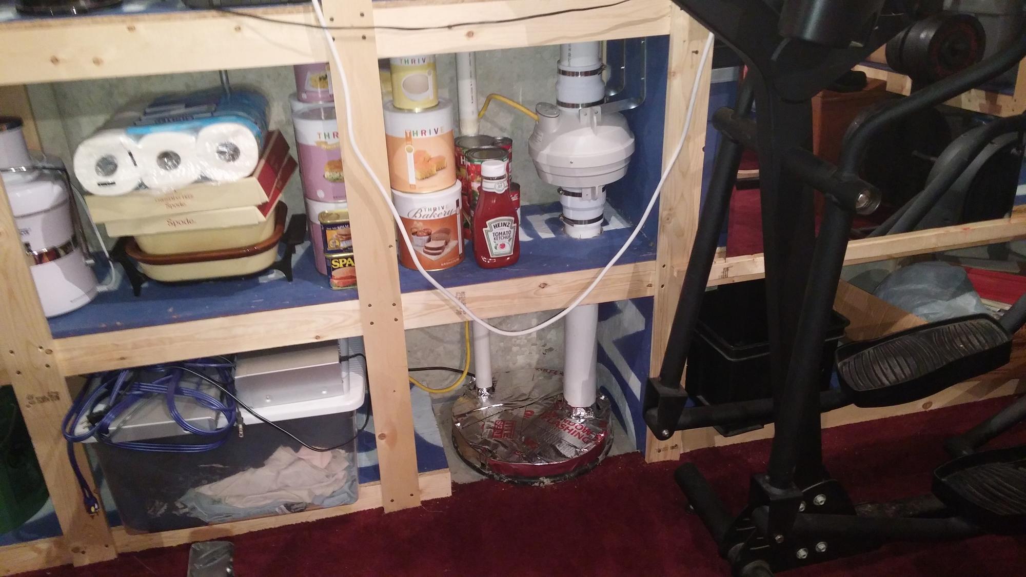

This is an inspection of a radon mitigation system. This home was tested for radon, The average was 12.6 pCi/l . This was high and the homeowner installed a radon mitigation system. Radon was tested again and the average was 1.9 pCi/l This is an acceptable and safe level. However the radon mitigation fan is inside the basement. Recommend to move the fan to the outside of the home.

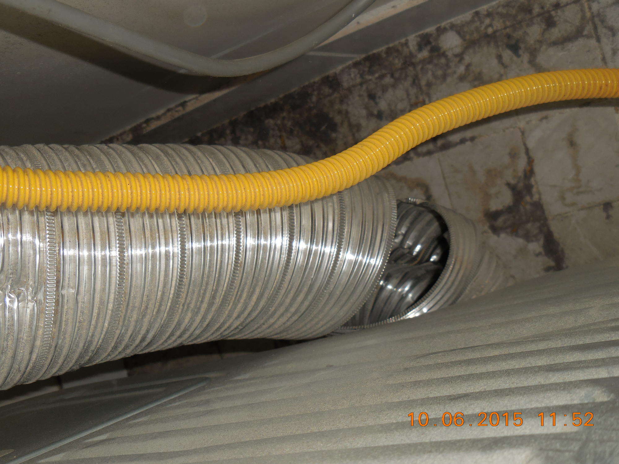

The picture posted is of a broken vent pipe for a dryer. This is a serious fire hazard not to mention the fact that hot air and lint will be dumping into the house. This is an automatic repair replace on all My reports!

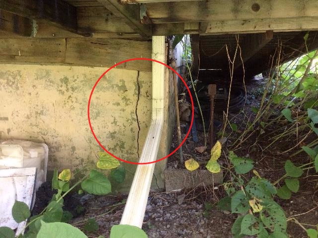

This crack extends below grade. This is a possible location for radon gas to enter the home. Recommendations include review by a licensed structural engineer and to seal this crack along with many other present in the foundation to prevent radon gas entry into the home.

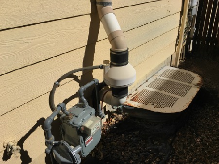

I inspected this home on 10/12/15. The radon sub slab depressurization mitigation system was installed in 2013. The fan is located outdoors with its own dedicated outlet. The pressure is acceptable. In my report I recommended the home be re-measured per EPA recommendation all homes be measured every 2 years.

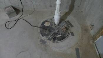

Sealed sump pump.
This sump pump has a cover that is bolted on to the sump bucket.
This does not meet the standards for a properly sealed sump pump/ pit for the purposes of radon mitigation for the home.
The sump pit should have a continuous caulked seal between the bucket and cover.

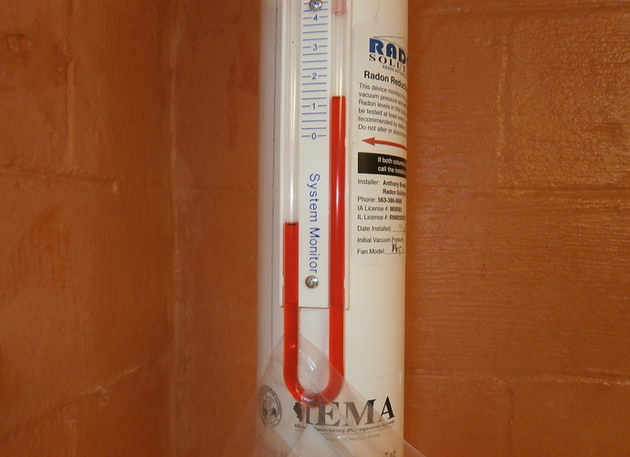

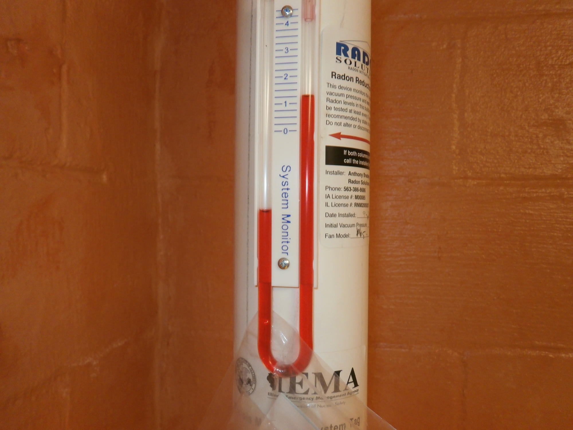

This home is equipped with a functioning radon mitigation system. Radon system operation can be verified by a water manometer located in the crawl space. A difference of about 1" in the water level from one side to the other in the manometer indicates that the fan (located outside the home) is operating and creating a slight vacuum to draw radon gasses out of the home. A light touch anywhere along the length of PVC pipe comprising this system will exhibit a slight vibration which also indicates an operating fan.
A notation on the system pipe indicates that a new fan was installed on May 27, of this year.

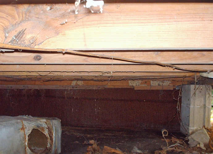

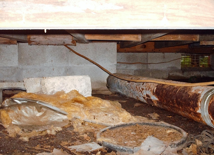

This picture of a crawlspace with a lot of debris in it, which needs to be removed. The crawlspace has an uncovered dirt floor. The dirt floor needs to be covered with a minimum 6 mil. plastic covering, of the entire area of the crawlspace. Overlaps should be at least 12”, and sealed. The plastic sheeting should go up the walls a min. of 12”, and sealed.

I saw evidence of clutter in the crawlspace, Correction is needed. Recommend cleaning the debris from the crawlspace to reduce the
likelihood of critters nesting in it under your home.
Saw evidence of no plastic covering on the dirt floor of the crawlspace. There should be a soil covering to reduce the soil gasses, such as Radon. (Radon is an odorless, tasteless gas radioactive gas, that is the 2nd leading cause of lung cancer just under smoking.)
Recommend that you consult a Radon Tester to determine if there is an elevated level of Radon in the soil under your home. The EPA recommends that Radon level of 4pCi/l, or more, (4 picocurie per liter of air. Picocurie is a measurement of radioactivity) should be mitigated. The Radon Tester can take an air sample and send it to a laboratory for analyses.
If the laboratory results show that elevated levels of Radon in your home, my recommendation is to consult a NC Licensed Radon Mitigation Contractor to design a Radon Mitigation System to lower the Radon level of your home. The soil should be covered with a plastic covering and the Radon Mitigation System can be placed under the plastic covering. An added benefit to the plastic covering is to control moisture intrusion.
