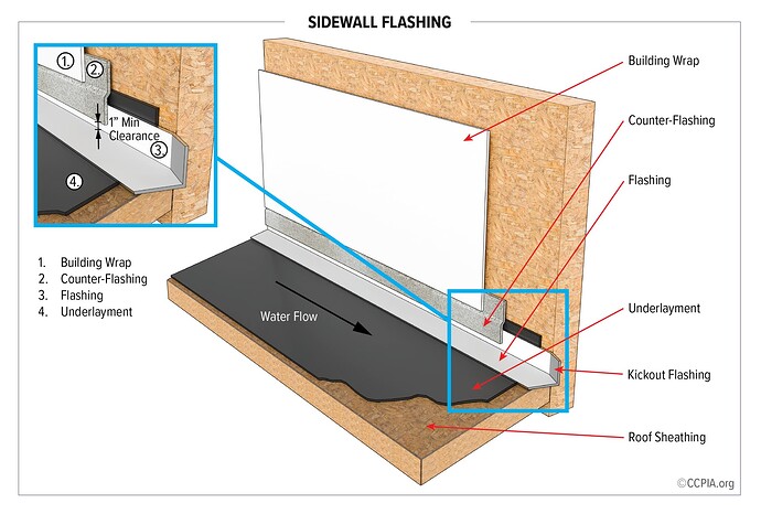

Another image added to the free Gallery: Sidewall Flashing
[quote="Nick Gromicko, CMI, post:20, topic:240373, full:true, username:gromicko”]
[quote="lkage, post:18, topic:240373”]
The image simply isn’t clear.
[/quote]
It’s not angled up the sidewall. Look at the building wrap. Building wrap is installed horizontally and the image shows it parallel to the counter flashing and flashing, which means the roof/sidewall intersection, counter flashing, and flashing are also all horizontal.
[/quote]
So, the image is supposed to portray a “headwall” not a “sidewll?
Maybe that is why it is not clear.
I think so, don’t you? How could it be drawn better?
I think you are correct that it should be labeled headwall, not sidewall if you look at “most” definitions that I’m finding.
Either that or we need a wider view illustrated as angle from perspective and actual angle are indistinguishable in a 2 dimensional drawing.

First, call it a “headwall” flashing…not a “sidewall” flashing.
Second, remove the kickout flashing from the “headwall” flashing image.
I agree with the wording change.
But is there never a kickout on headwall flashing?

How could it work on a horizontal/level junction?
There is no water running in that direction.
OK. I’m going to have the artist change the word "sidewall to headwal"l and remove the kickout.
Thanks Larry!!! You were super helpful.
That’s what I was getting at Larry

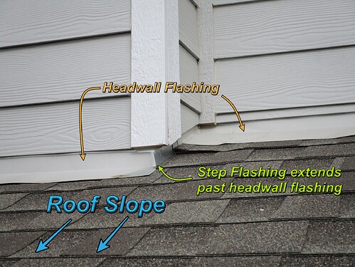

I’ve never seen it. If there is a sloped roof at the end of the head wall, like that of a dormer for example, the step flashing on the side wall would extend past the end of the headwall flashing like this picture from one of my inspections (not the greatest picture, but the first one I could easily find):
Now if a roof ends on an exterior wall, the headwall flashing “should” extend past the fascia board slightly, however, again the roof slopes away from the wall, so a kickout in this location would be pointless. Here is another on of mine, warranty inspection (edited for this post), I called this out as a problem because the fascia had slight signs of water damage, even though the roof sloped away from the wall, because the flashing above it did not extend past, and the siding was not cut properly for the flashing.
If it were a metal roof, then solid flashing would be ok BUT the roof would still have to be sloped in some way. Water has to go somewhere…

With Larry’s help, we got it. As I noticed the house wrap in the image is running parallel to the flashing, thus the flashing has to be horizontal (It’s often hard to distinguish an angle from perspective with an actual angle in a 2-dimensional drawing). That established, Larry correctly points out that we can drop the kickback and that it is not a sidewall, but a headwall, and to change the text to headwall. He’s right.
Artist is correcting.
