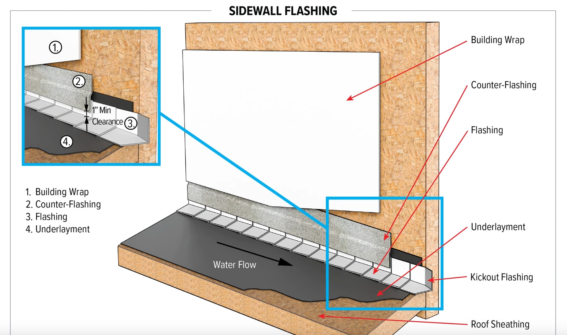

Another image added to the free Gallery: Sidewall Flashing
True. The slight advantage of depicting step flashing on the SIDEWALL is to emphasize that the roof is sloped on a SIDEWALL.
Thank you. Revising.

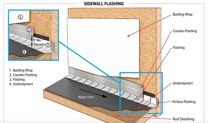

Image updated in gallery. The link in the OP should direct you to the most recent image. Thanks, again.
Looks good (except, I would call the flashing “step flashing”)…
Thanks. That makes sense. Updated!
