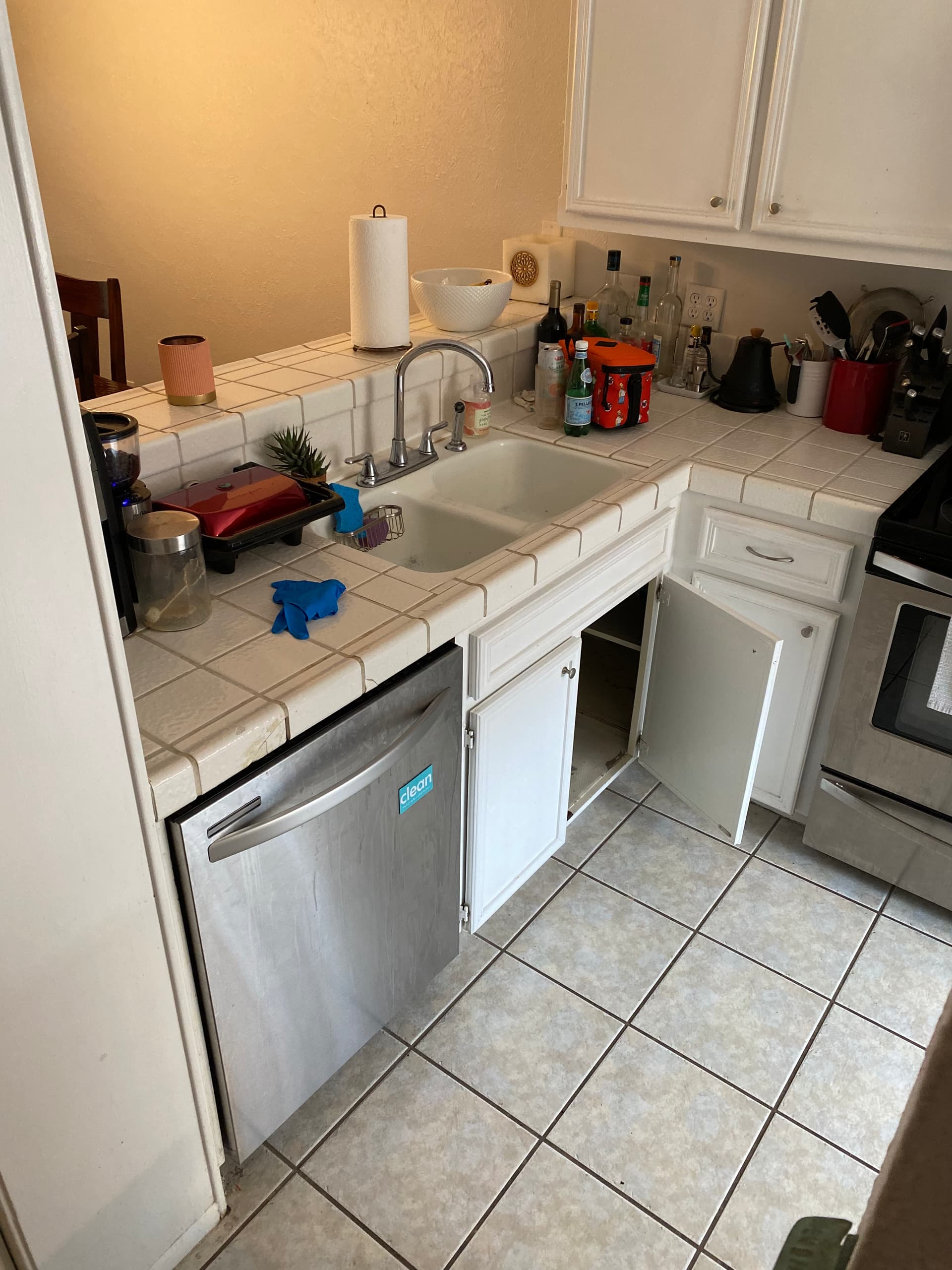

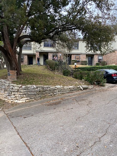

Two of the attached photos are from under the sink/countertop in my kitchen. The kitchen sink is in an island/peninsula kinda deal. The other image is the exterior of the building, as you can see it’s very much elevated from the street, so the drain line drops plenty before getting to the street. It’s a 1983 build.

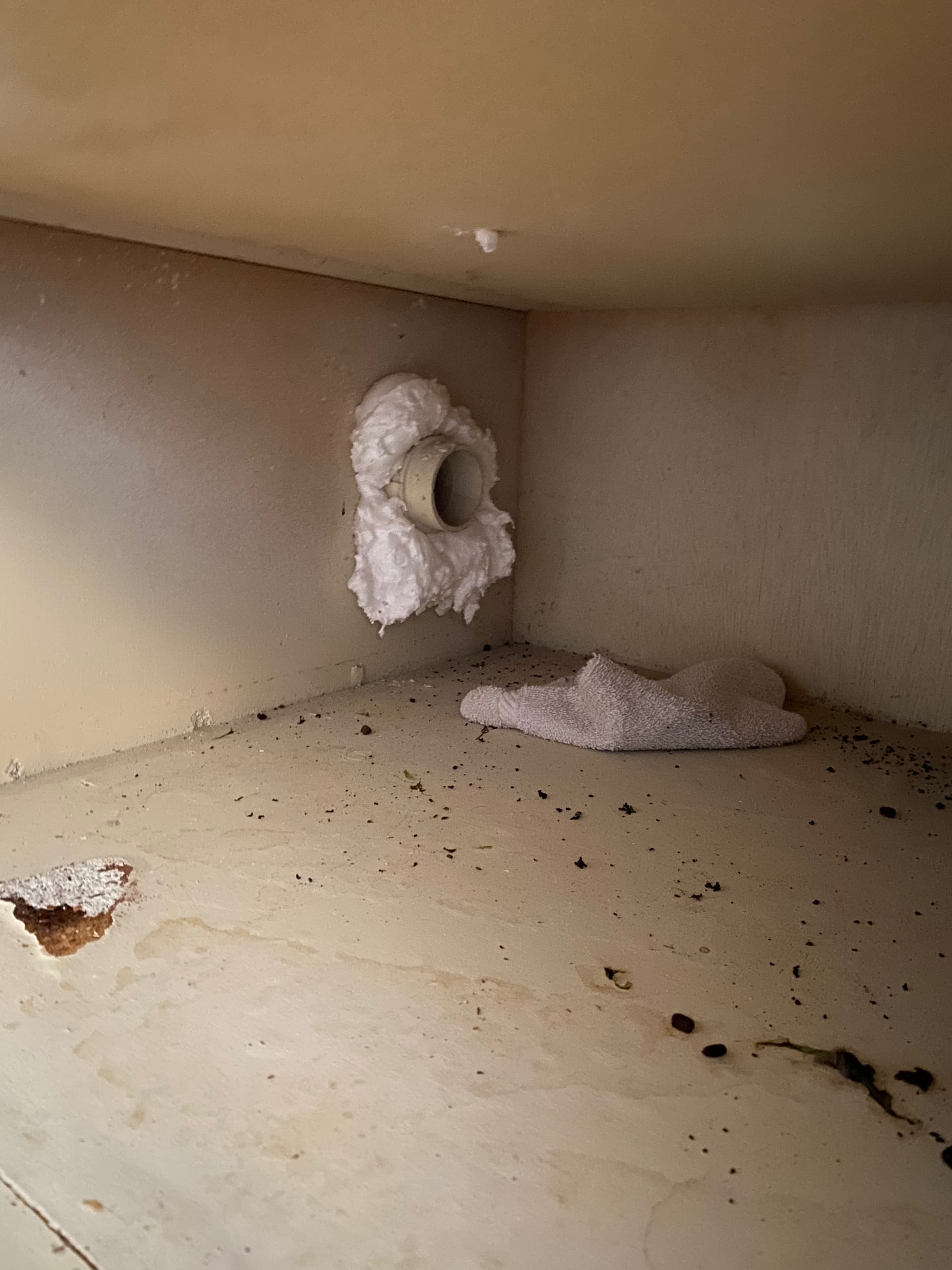

I was foolishly assuming that the open pipe in the wall at the back of a cabinet was an old drain line that was sealed on the other end for some reason and abandoned.

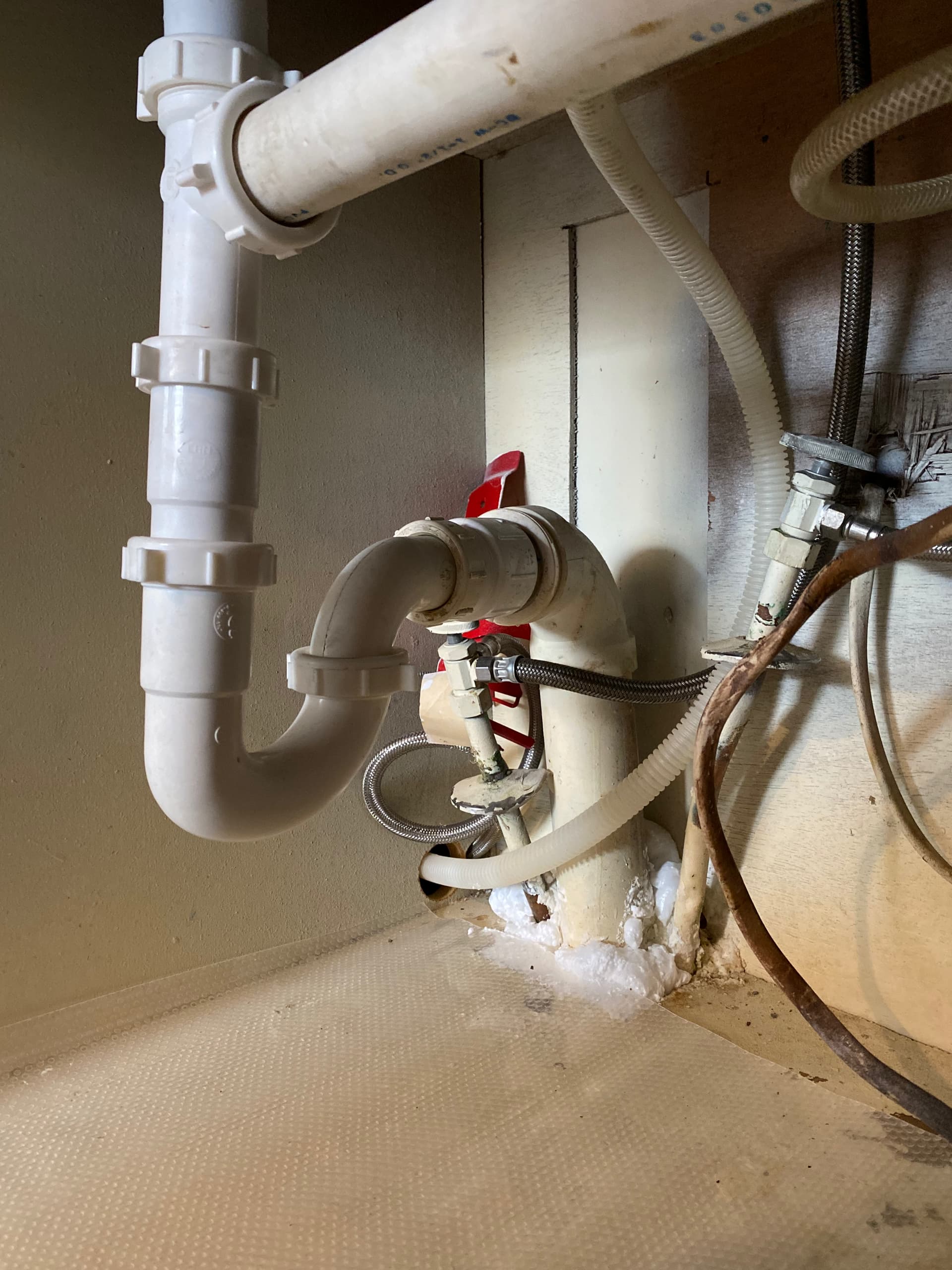

The other day my dishwasher and laundry machine (also located in the kitchen) was running at the same time, and then my girlfriend fed lots of perished food from the fridge down the disposal. Shortly after doing that, she noticed water in the cabinet, near that pipe. you can actually see some of the lettuce that she had just put down the disposal, along with a bunch of roach eggs. Seems like that must be a open vent pipe. But we havnt smelled any sewage fumes in the ~7 months we’ve been here, so there must be a trap somewhere before the sewer connection, right?
Gross as shit, but here’s my question: did this use to be a common way of venting in the 80’s, in situations where the main drain line drops elevation enough to accommodate a trap? Or is this a lardlord renting me a house with a serious health code violation? Or is it both?

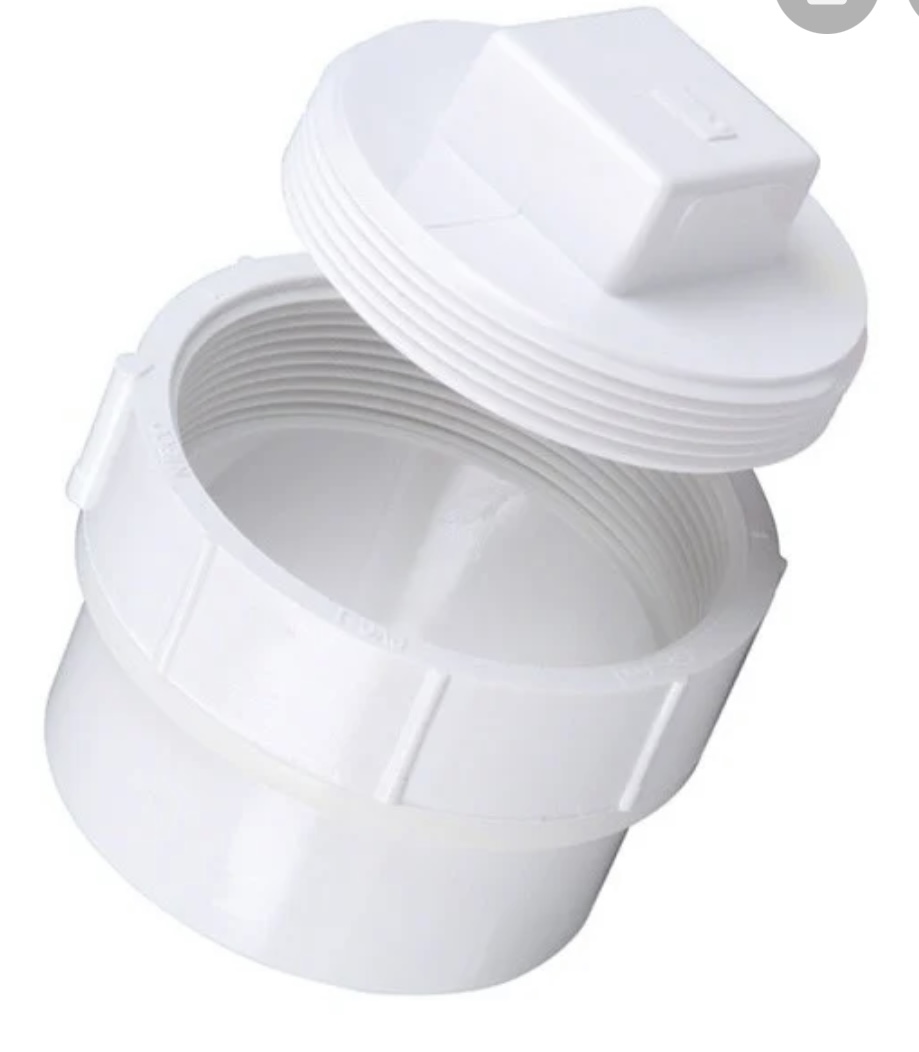

No this was not a common way of venting in the 80s. Even in the 80s island venting was a thing. I recommend gluing a clean out on that pipe to seal it up.

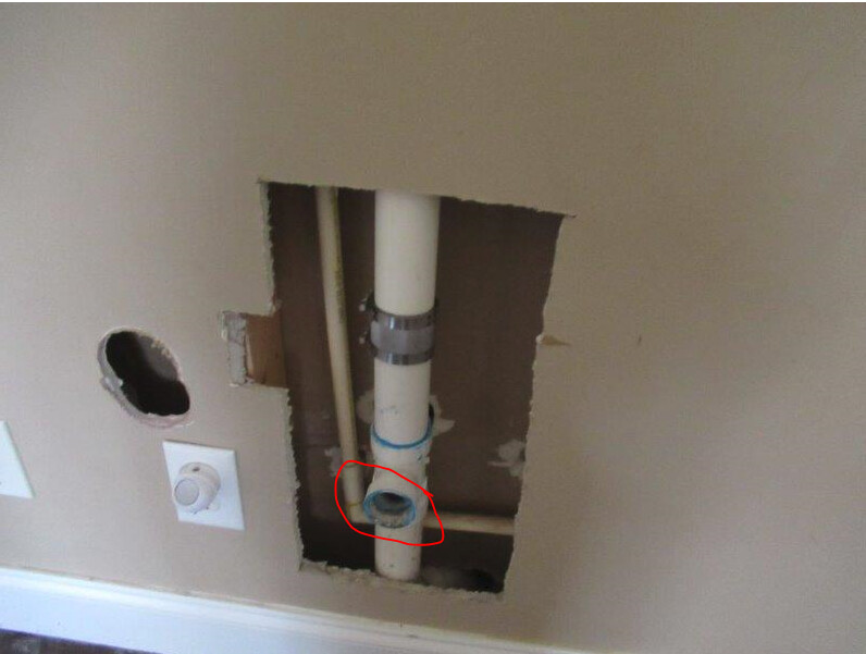

Honestly, I don’t recall. The majority of my inspections are 50+ years old, half of those are 100+ years old, and have so many 'effed up plumbing issues I can’t recall them all. This one would be more in line with the ‘minor’ issues category I see.
Open pipe under the sink definitely not a common way to vent anytime but around the 80s/90s in my area it was very common to run a vent loop (term?) up behind an island sink. The usual install has since gone to an AAV but I’m guessing what you have is a chopped off vent loop. Someone has definitely screwed something up there as the drain shouldn’t dive before reaching some venting. Probably not the end of the world. If it were my house and it was causing a problem I’d probably just cap it… and wait to see where the problem resurfaced :slight_smile: :slight_smile:
