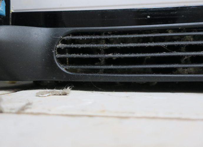

Inspected a Frigidaire Side-by-side Refridgerator. No damage. 38 degrees fridge side. 30 degrees freezer. No icing or rust. No vibrations. Quiet unit. Coils clean. Light operates. Water and Ice Maker both functioning properly. Only suggestion would be to vacuum dust the
base of the fridge once a month to increase efficiency.
