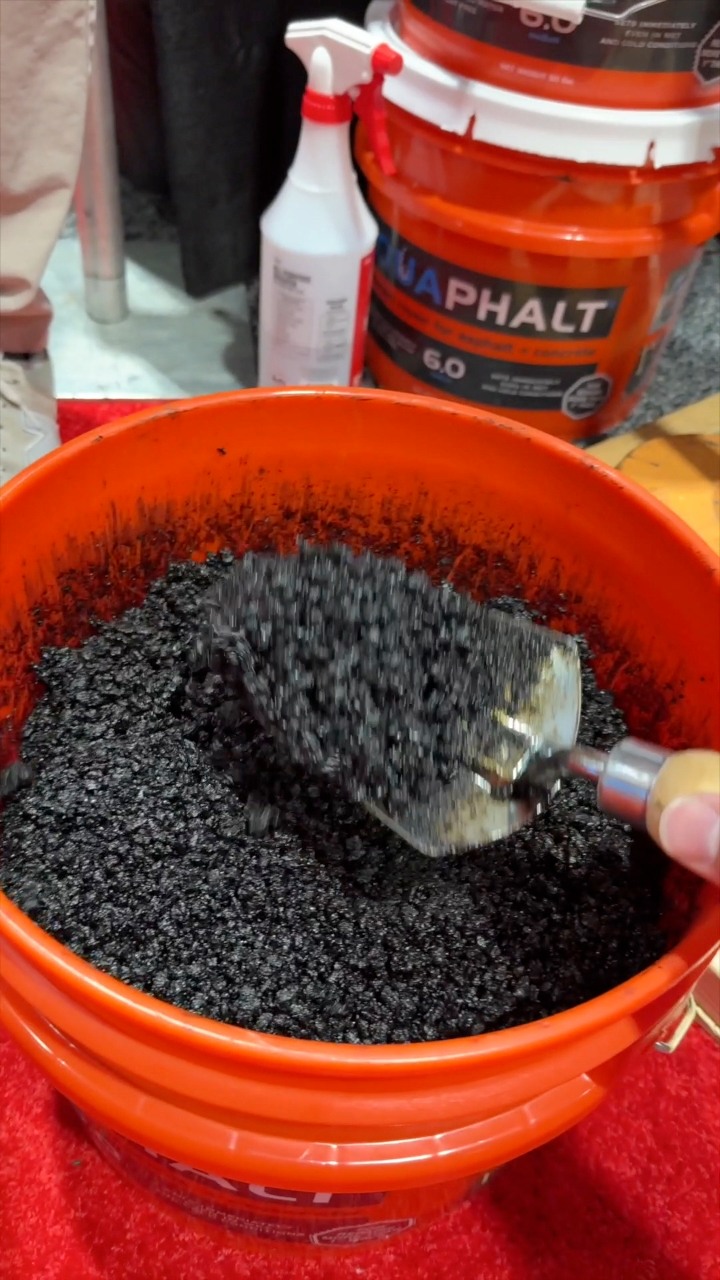

Asphalt Concrete
Asphalt concrete (commonly called asphalt, blacktop or pavement in North America, and tarmac, bitumen macadam, or rolled asphalt in the United Kingdom and the Republic of Ireland) is a composite material commonly used on roads, parking lots, airports, and core of embankment dams.
It is a graded mixture of aggregate and filter with asphalt; hot or cold and rolled.
Here we will learn about Asphalt concrete, types of asphalt concretes & much more.
Introduction to Asphalt concrete:
In short, asphalt concrete is a composite material and asphalt used as binder mixed together then molded into layers and compacted.

1.Hot mix asphalt concrete (HMAC or HMA):
HMAC is produced by heating the asphalt binder and drying the aggregates to remove the moisture from it, before mixing.
The mixture is usually collected at about 150 °C for new asphalt, 166 °C for polymer modified asphalt and 95 °C for asphalt cement paving; condensate when the asphalt is sufficiently sizzling.
The HMAC is a type of asphalt commonly used for high traffic pavements of highways, airports, and race tracks.
2.Warm Mix Asphalt Concrete (WMA):
This type of concrete is also produced by adding zeolites, waxes, asphaltic emulsions, or water to the asphaltic binder before mixing.
Such concrete emits less CO2, aerosols, and vapour, the lower laying temperature furthers the rapid availability of the floor to be used, which is extra advantageous for construction sites with vital time schedules.
Adding additives such as zeolites, waxes, and asphalt emulsions to hot mixed asphalt can cause easy condensation and allow for cold weather or longer stays.
3.Cold mix asphalt concrete:
This cold mix asphalt concrete is produced by blending the asphalts in water with the soap as essential before mixing with the aggregates.
When concrete is in a blended state, asphalts is less viscous and the mixture becomes easier to work and compact.
Cold mixes are commonly used as batching materials for service roads subject to low traffic.
4.Cut-back asphalt concrete:
Cut back asphalt concrete is produced by dissolving the binder in kerosene or other lighter fraction of petroleum before mixing with the aggregate.
When it is in the dissolved state, the asphalt is much less viscous and the mixture turns into simpler to work.
After inserting the mixture down, the lighter fraction evaporates.
This increases pollution from volatile organic compounds present in the volatile fraction, so the cut-off asphalt has been largely replaced by emulsion of asphalt.
5. Mastic asphalt concrete or sheet Asphalt:
Mastic concrete is formed by heating exhausting grade blown bitumen in a mixer until it has change into a viscous liquid after which the aggregate mix is added.
The bitumen aggregate mixture is matured for about 6 to 7 hours as soon as it is prepared, the mastic asphalt mixer is taken to the highway construction work.
It is normally positioned to a thickness of about 20- 30 mm for pavement and highway applications and a thickness of 10 mm for flooring or rooftop.
Rarely, an additive such as polymers and ant stripping agents can be added to improve the properties of the final product.
6. Natural asphalt concrete:
Natural asphalt concrete might be produced from the bituminous rock which is found naturally in some parts of the world.
