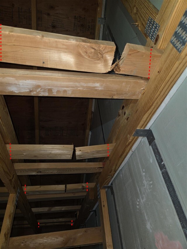

Hey guys! I ran into these cut supports in the attic of a townhome style condo yesterday. The wall to the right is the fire wall leading to the next unit. To the left, the trusses sit on top of the boards that are cut and actual supports below. I’ve never seen this before. Any idea why this would be like this? Nothing is wobbling or movable by hand.
Another ugly section
Not much load support there, there. If the lumber was rotated 90 degrees I could see how that lumber would support a load, to a degree.
Likely horizontal intermediate bracing for side to side actions was reestablished. Henceforth, the cut pieces of dimensional lumber.
Report what you see. 2x10 lumber laid flat between upper lower roof attic chords and ceiling joists in that space. Several flat ceiling joists have been cut across the width or face leaving a gap.
No there, there in my opinion. I suspect the lumber was used to traverse the wood timber framing as the unit was erected. The cut pieces left behind for no real ryme or reason.
Possible original construction scenario: Gable end wall was tied back to the truss structure using horizontal rat runs as pictured (now cut). Later, it was discovered the end wall was not plumb. Solution: Cut the rat runs, replumb the wall, and add new bracing from the now plumb end wall back to the trusses.
In that case, it’s not an issue at all. Rat run truss bracing is always run flat as pictured.

Those look like piggy back trusses. The flat 2x4s act as spacers and nailers for the too section.
As for the ones that are cut, I would agree with @msenty with the thought that they were cut during construction after discovery of a layout issue. As long as there’s another to replace the cut supports, there’s nothing to be concerned with.
I’d be more concerned with the sistered 2x on the bottom chord of the end truss (in the first picture) than the spacers unless it’s there just to hold spacers in place. The picture doesn’t show enough detail to tell.

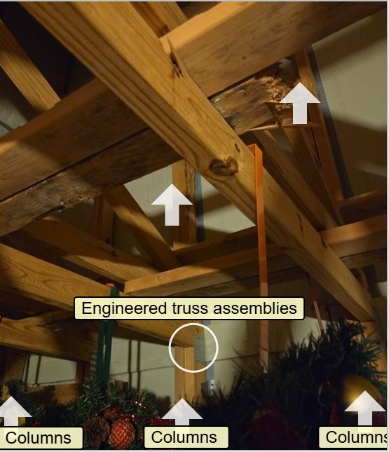

If I am reading your string, and the illustration provided by you properly, the side note caption, pointing to horizontal members says, Continuous Lateral Restraint (required only if Brace Frame or Structural Sheathing is installed intermittently) to which it appears to be.
As for the architecture; it appears to be a continuous wood truss lite timber framed building if I am not mistaken.
Nope. Look at the parallel chords (yellow) and the connection point at the end (green) with no plates. It’s toe nailed.
Did the photo edit on my phone so it’s a little rough.

There are many different ways to assemble those truss systems and sheathing is not really typical as it adds too much $$$ to the price of the build. I see them installed without spacer/nailers quite often, those just get toenailed together, but 2x4s laid flat is very typical and quite often they are scrap pieces or boards not really suitable for framing walls.
That was my first thought. There is clearly a gap at the cut 2x4s, that gets smaller as the wall goes back. The cut 2x4s were the original truss bracing, and then they had to move that last truss over to line up with the wall that was likely framed out of square to begin with.
They moved the wall and truss, and then installed new truss bracing..

I was referring to the Structural Wood Floor-Ceiling Truss assemblies. The OP mentioned the roof truss assemblies. “the trusses sit on top of the boards”
