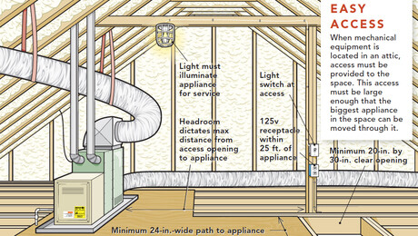

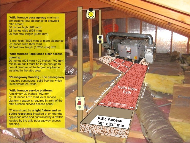

I do not walk attics without a purpose built platform. A purpose built platform will usually be a 24 inch to 30 inch wide walkway to access equipment for maintenance.

I was unable to traverse the attic due to lack of secure footing/walkway. I observed the attic from the mechanical platform. Views were limited or obstructed. Latent defects may exist.

Good for you Cory. You were not required to enter the attic space. Do the best you can from a safe location and include in your report how you inspected the attic and your observations.

I’m sure some inspectors think the 1x6 board nailed across the bottom of the trusses is a walking platform but it is not, it is simply to hold the trusses in place to keep them 24” on center for sheet rock. They are in no means meant to be walked on. Best of luck with your repair negotiations.
