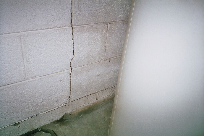

Basement wall support slight bend
I did an inspection on this home and found these wall supports in the basement garage. They appeared to have a slight bend in them. They were installed prior to a sump pump installation and waterproofing. No cracking or moisture was observed at the wall at the time of the inspection but I’m am unsure how to report this. Any input is appreciated.
IMO… that wall is in imminent danger of failure. Could be 5 or 25 years, but the signs are all there.

is this a patterned forms wall or individual block?
there are vert cracks visible & numerous joints appear to have tooled sealant prolly masking more cracks
regardless the wall is bowed in &
unless se letter has been provided advise getting 1
if 1 is present defer any further comment info to it

Time for an engineer!
Wall bowing/ being pushed in, the two pictured steel u-bracing indicate prior repair work, needs further evaluation.

lol same old crap, they bs’d homeowner-whoever into an INT water diverting system when the problems and solution are on the exterior of wall, ext-cracks, cracked parging etc and either clay, silty soil against wall and-or underground tree roots or maybe concrete slab(s) or porch footing etc.
INT drainage systems do not seal, repair, waterproof the ext-cracks etc, they do NOT 'stop the water from getting in the blocks, at best n for awhile these systems should divert the incoming water under the floor, regardless they did NOT waterproof the basement and they did not remove, relieve,lessen the weight/pressure, cause(s) against the ext-of wall = scam
can see the outline of where they J hammered out a piece of floor, THAT doesn’t help the wall either as they highly likely poured, put in, LESS concrete n that concrete helps hold the wall in-place in the coming months/years eh
