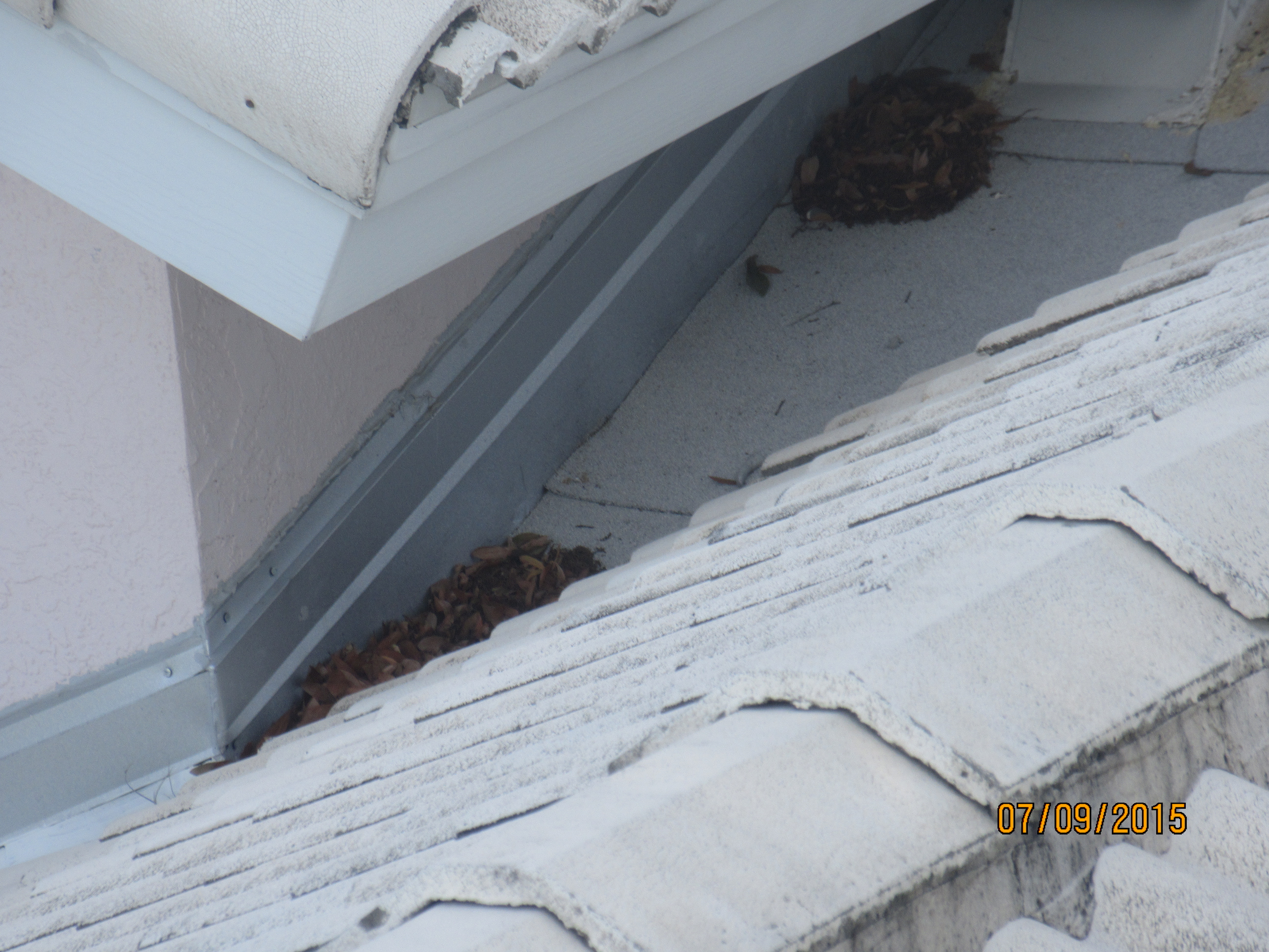

I inspected this home this week and I am having to call out some of the repairs as defect. In this case I am calling out counter flashing not installed correctly at the very least. Let me know if you think any different but I would not be happy with this job. I am wondering how often this happen because this repair was done last year December.

That IS counter flashing
counter flashing going into the siding?
Your original post stated that counter flashing was “missing” but you changed it to “not installed correctly”
I did, I saw my mistake trying to write this in a hurry.
Can you explain what you think is incorrect?
@spayson pretty much nailed it on this one!
Not the best work but yes it’s typical work in today’s unskilled labor force
Are those pictures from July 2015? Or today’s inspection?
We don’t often see concrete roof covering in Knoxville.
Canon has released a new line of super advanced cameras with time travel feature. It allows you to dial in and capture photos of the past.
Or he did not set the date on his camera.
This doesn’t look like Knoxville to me.
