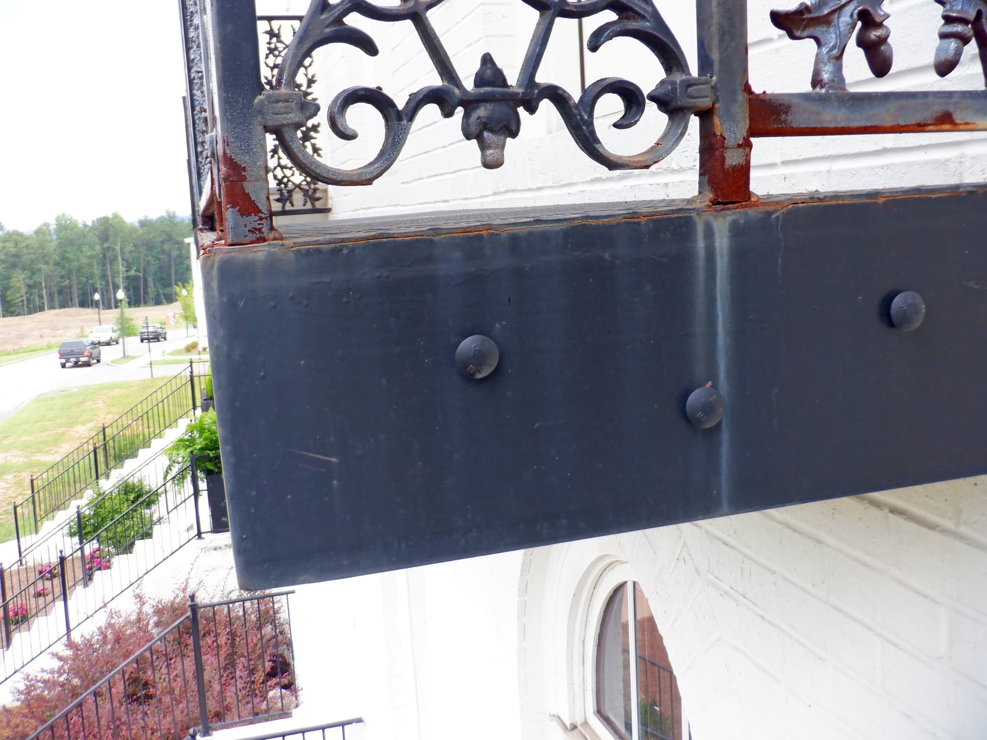

Had an inspection today with a short (~2ft wide) balcony. There are only three cantilevered joists supporting the structure. My question is; is this enough support. The girders of the balcony are steel so there’s a little more weight than with a wood balcony. To me, three joists doesn’t seem to provide enough support, however, there may be someone on here with more knowledge about this than me (not that it would take much). The first photo shows the positions of the joists. Any advice is appreciated!
It looks like an engineered design. Therefore, unless you have engineering qualifications, I would just look for any signs of failure, deterioration, etc. If you have engineering qualifications, you would want to take some measurements and what-not to do the calculations.

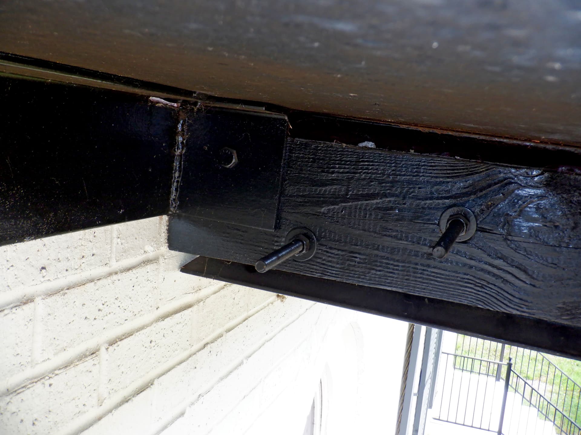

Other than the improper installation of the carriage bolts, I don’t see a problem.

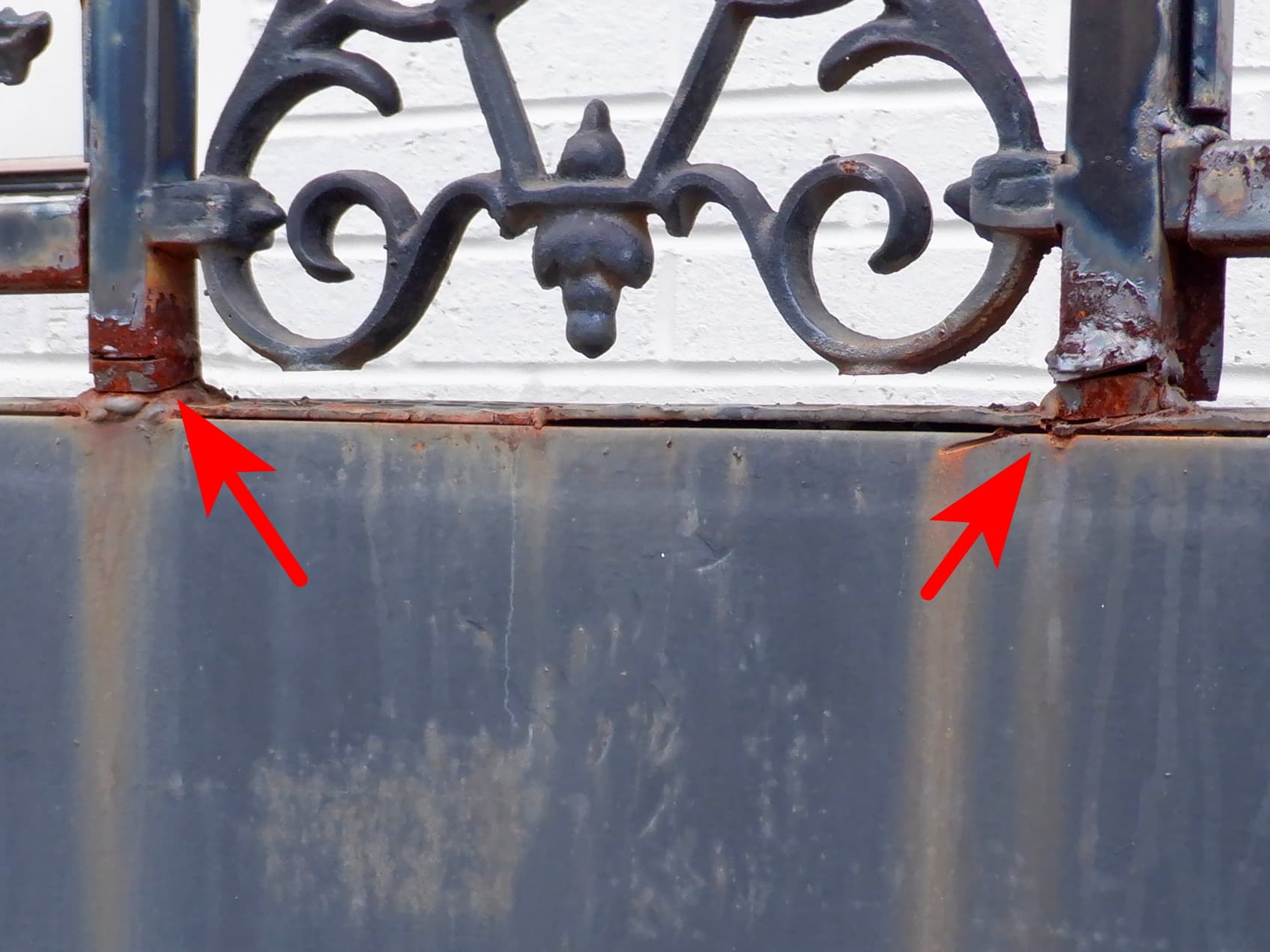

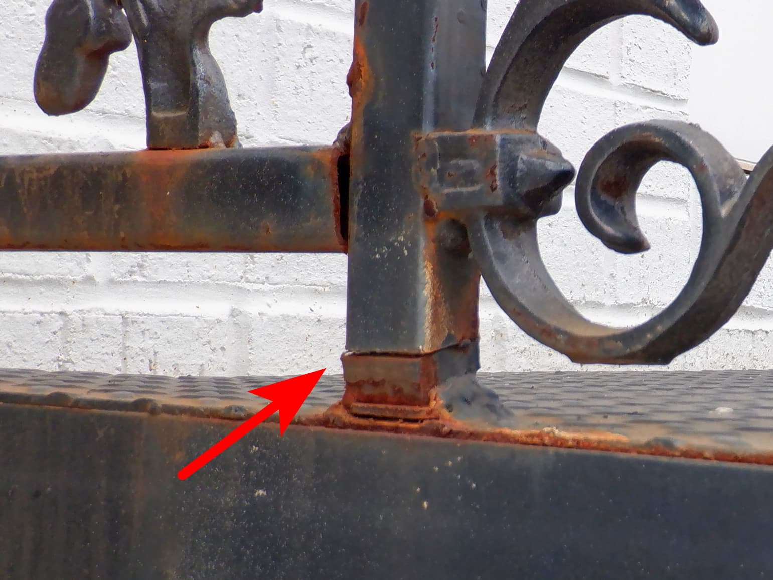

Regarding the railing on the balcony. I don’t know anything about welding so I’m not sure. Are the welds supposed to go all the way around the post, or can they be welded on one side?
That is definitely worth referring out for correction.
The rail looks weak and cracked near the welds. I’d be giving it a fairly good shake back and forth to see what happens.
Corrosion, hardware not properly installed, atypical joist spacing , I’d be calling for further evaluation and repair.
I agree with others that it looks like it was designed like that.
I would call out the corrosion damage and improperly installed hardware.
Got it. It felt solid when I shook it, however, I don’t know how long those connections will last. Thanks everyone for the feedback. Today’s inspection was a learning experience.

It is odd that the tubing was cut and spacers added in. Perhaps this is ready for a second repair cycle. The use of improper carriage bolts is another indicator of unprofessional installation.

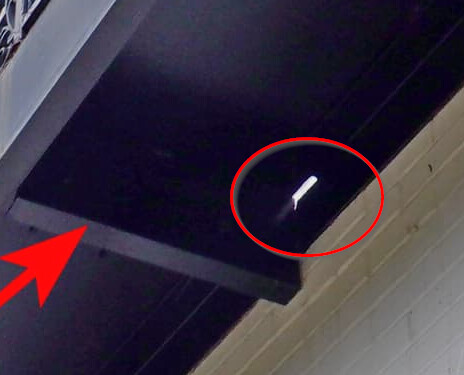

Also, is that daylight? Is the deck deteriorated? Or is it paint?
Definitely call out the rust, etc. but be careful scrutinizing design… as others have said it’s engineered and without any performance problems (sagging, etc.) you’re just asking for egg on your face. Even if you were an engineer, without the plans you don’t really have a way to fully evaluate exactly what loads it’s carrying… all of this is WELL beyond your purpose.

The cantilever length span at 24" inches is OK.

I see numerous Suspect repairs with wood. Open steel welding seams. Wood is a poor substitute for steel. Gaps between the sistered wood and steel retain water. Holes must be drill in the steel beams, lag bolts and washers introduced along with avoiding any galvanic reaction.
You thick those wood repairs are professional? Not me.
Balcony decking welds and steel posts and the decking are damaged. Really in need of immediate repairs.
Lots of corrosion and damage going on.
